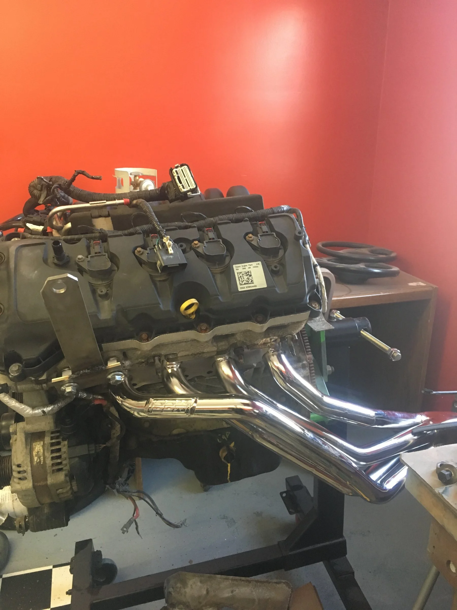

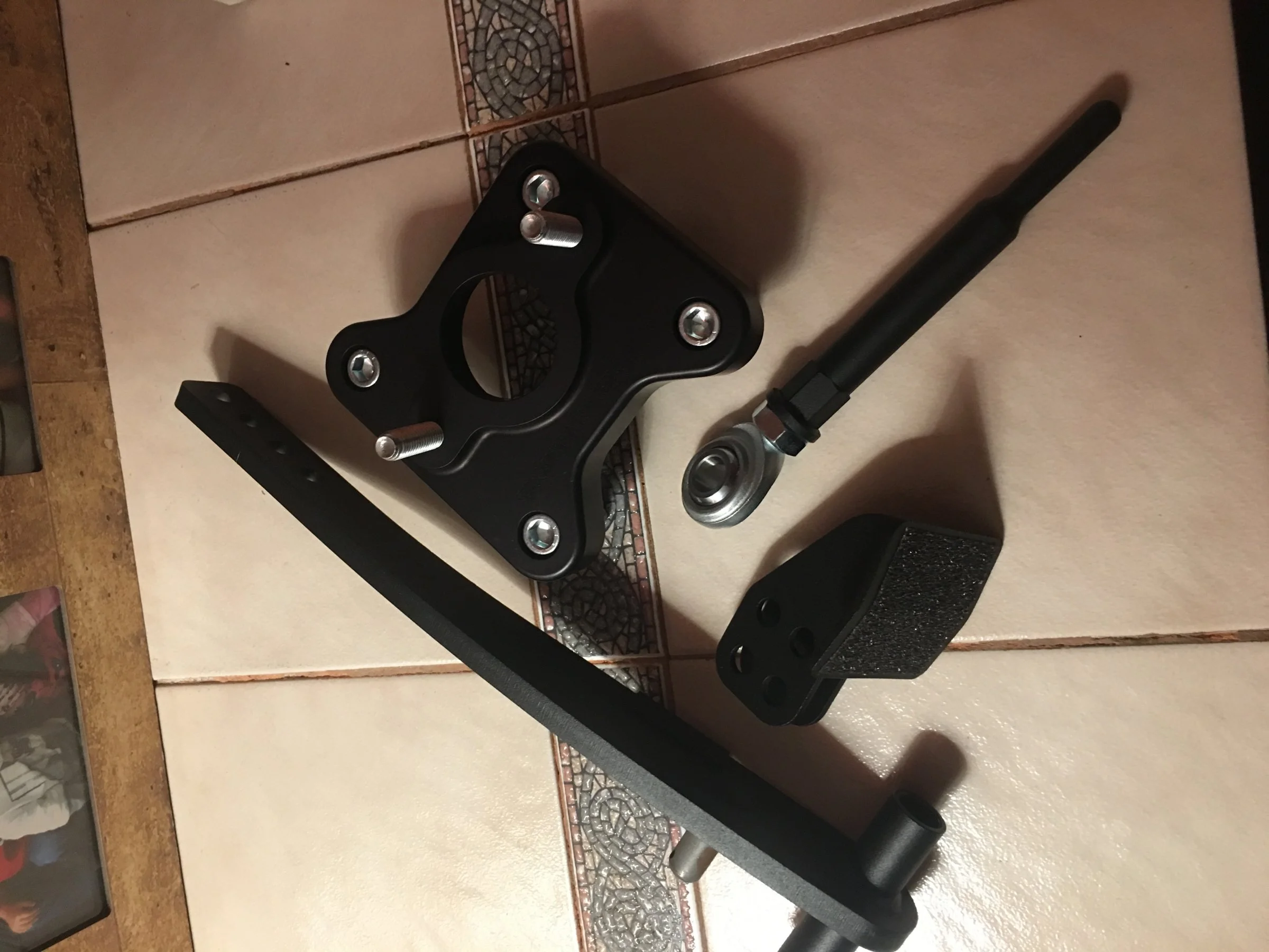

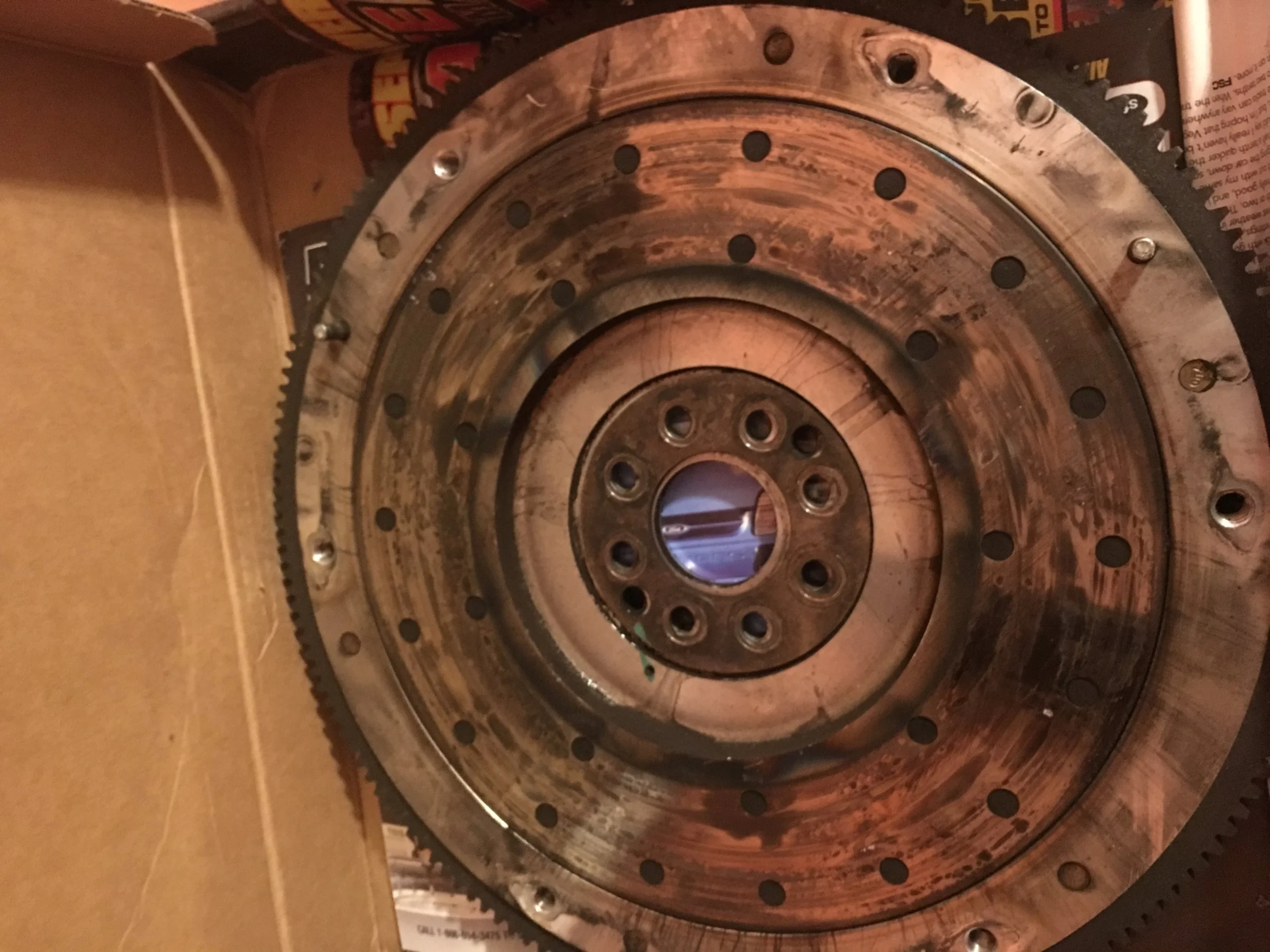

Started to order parts and will try and give everybody a complete list of every part i need to get. I will try and keep up with the total cost. Ive heard lots of people say this swap cost them well over 10k i dont believe it will cost me that much. I am also searching for any part i can get a deal on and also going to try and do a majority of the work myself.
parts ive ordered so far have been
2011-2014 ford racing control pack $1527
bbk coyote swap headers $490
mod motor bell housing for tremec tko $270
Scram speed control pack pedal mount $89
cheap clutch and flywheel for mod motor $50
parts i will be ordering in the next few days include
aje k member and mod motor mounts
maximum motorsports manual brake kit
stifflers crossmemember mount or i may fab my own
starter
on3 oil filter relocation kit
corvette c5 fuel filter fittings needed and fuel line
dakota digital gauges
with all that heres a few pics i took of what showed up
Reactions: RaggedGT, Hoytster, Noobz347 and 2 others

Nice! Let us know how that SCRAM pedal bracket works out for you, I have the J&M version for my swap.
Are you planning on swapping your front timing cover out or you just planning on running the stock f150 cover and all the accessories? It looks like you have all the accessories that came with the motor. I know some people have run into clearance issues since the f150 cover and accessories while others have seemed to have no issues.

i will also let you know about the scram pedal mount its a very solid construction and the same price as the J&M although im sure they will both get the job done with no issues.

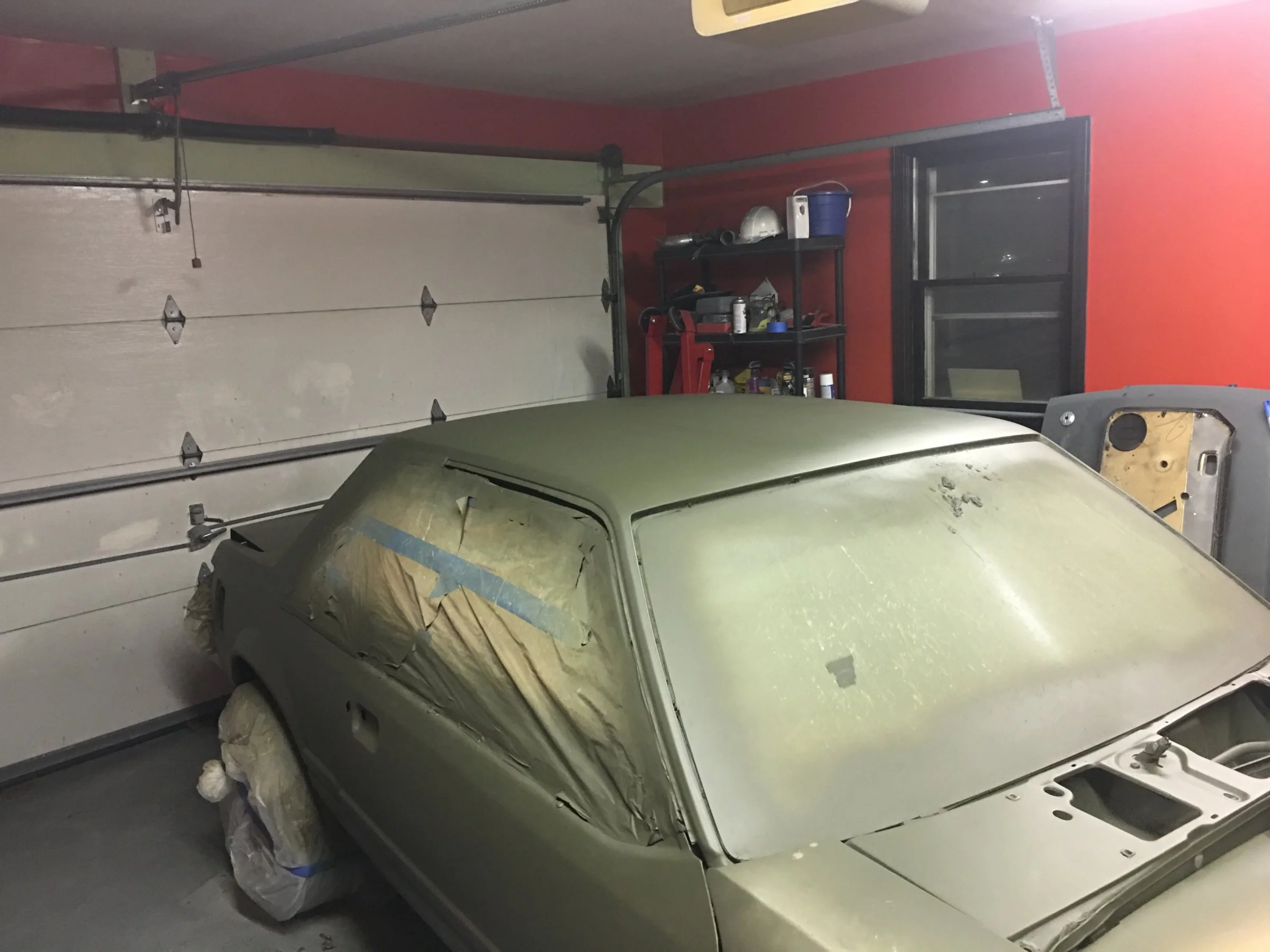

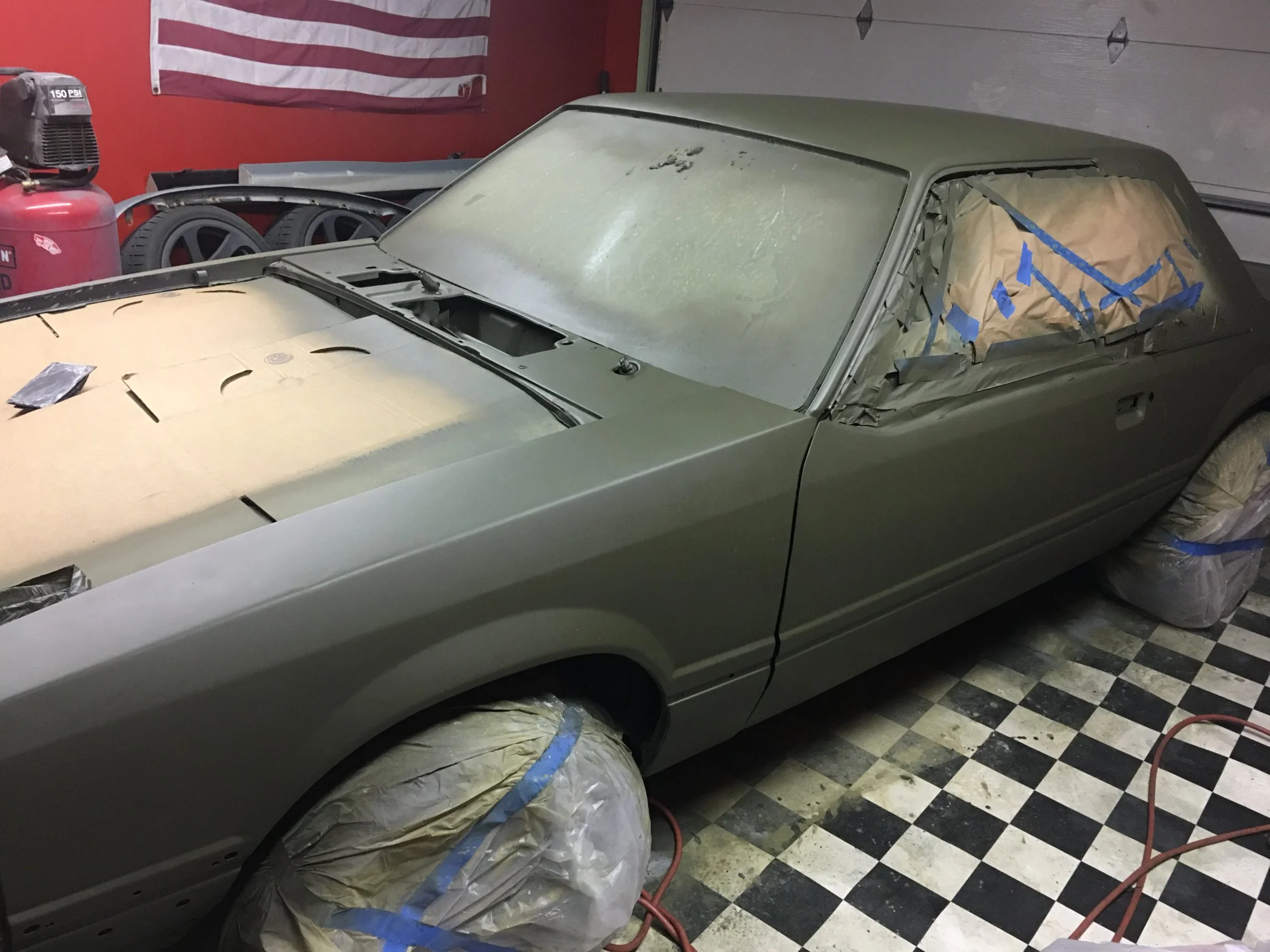

Got around to painting my car came out decent. Its my first time painting i was not looking for a show quality paint job. Just something that looked good going down the road or 10 ft away. Ill get better pics up as soon as i finish the bumpers and passanger fender. The paint is olive drab from a company called GCI if anybody is interested.
Reactions: 95BlueStallion, 90sickfox, General karthief and 2 others

Is that army drab green ?

Yes its olive drab from a company called gci real durable and great price heres a link if anyone is interested they have multiple different options. https://www.armyjeepparts.com/t-GCI_paint.aspx

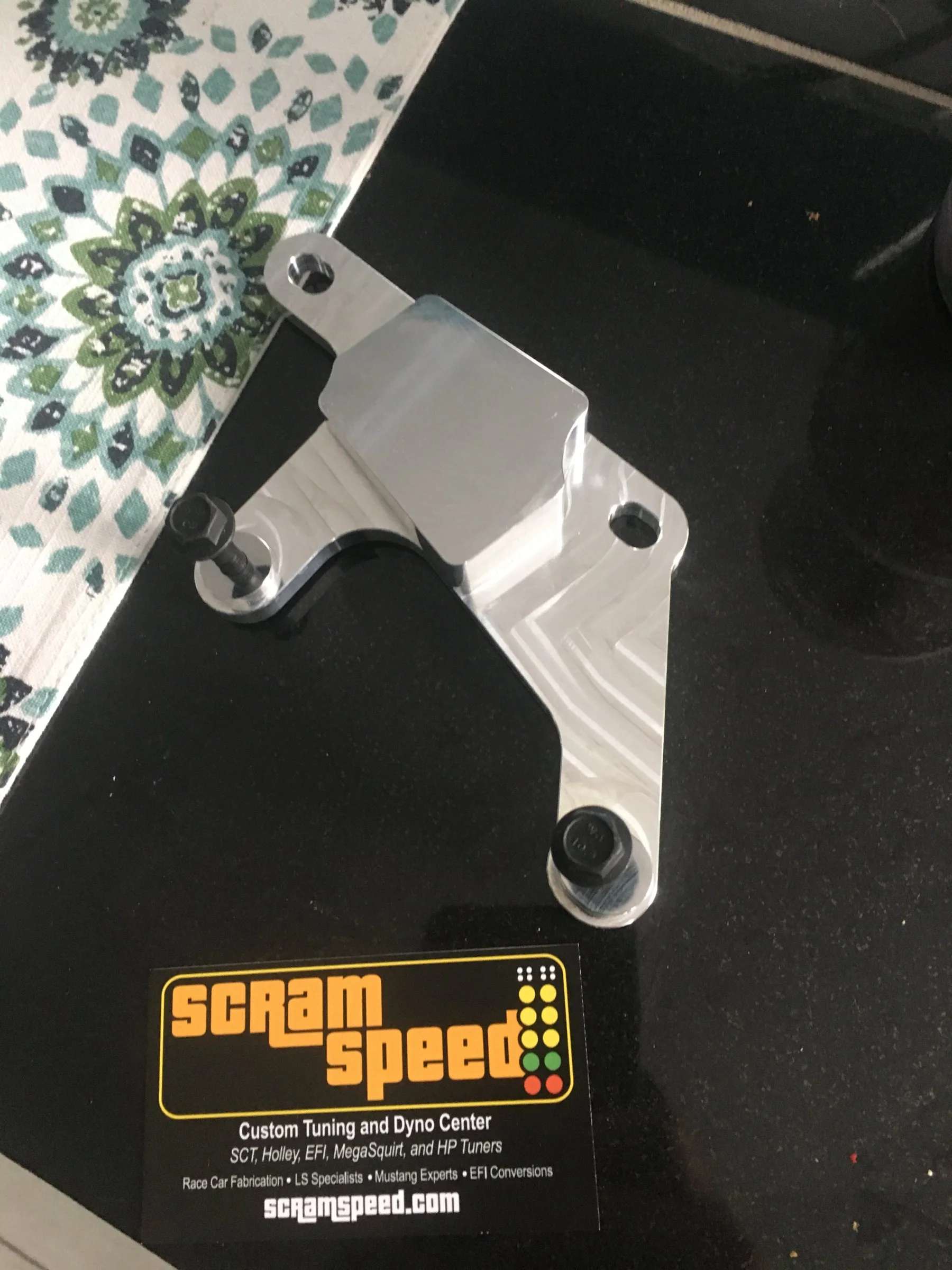

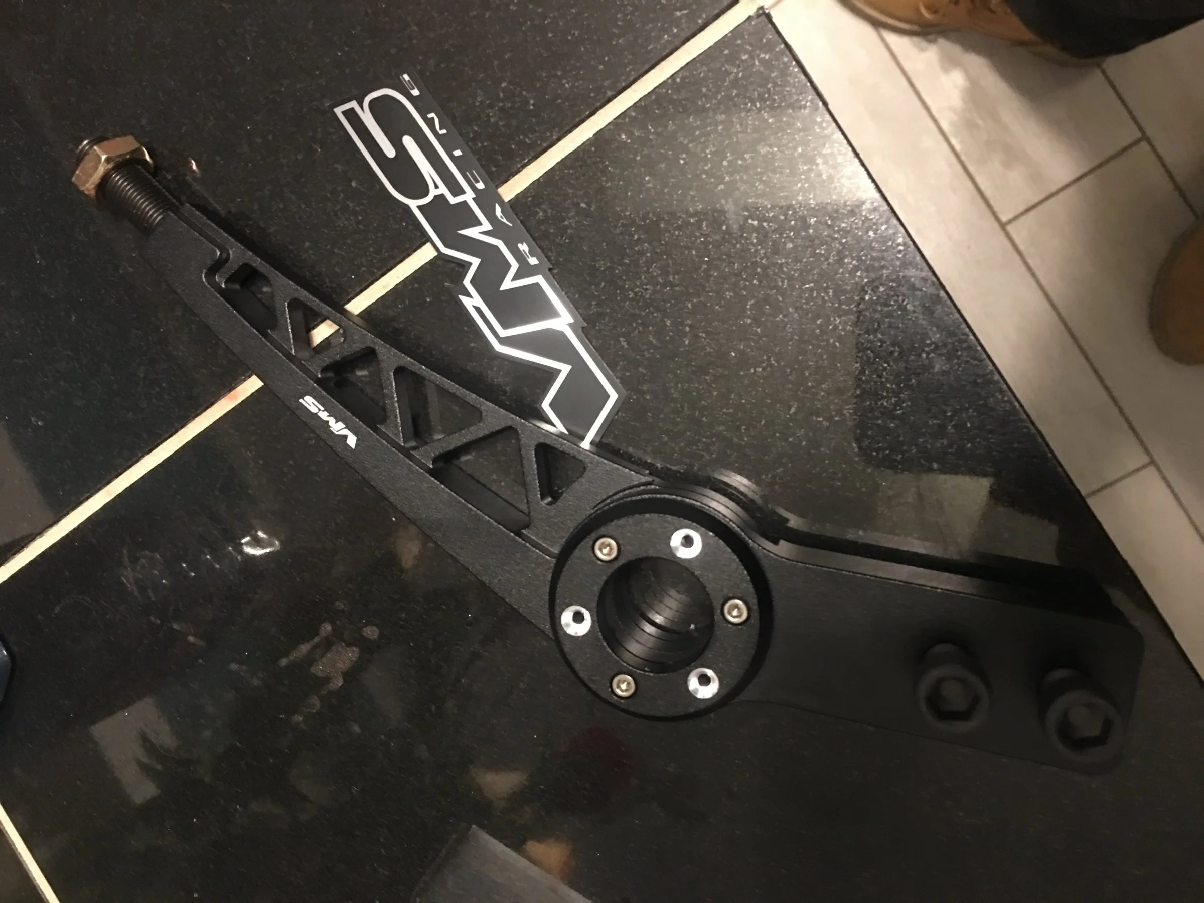

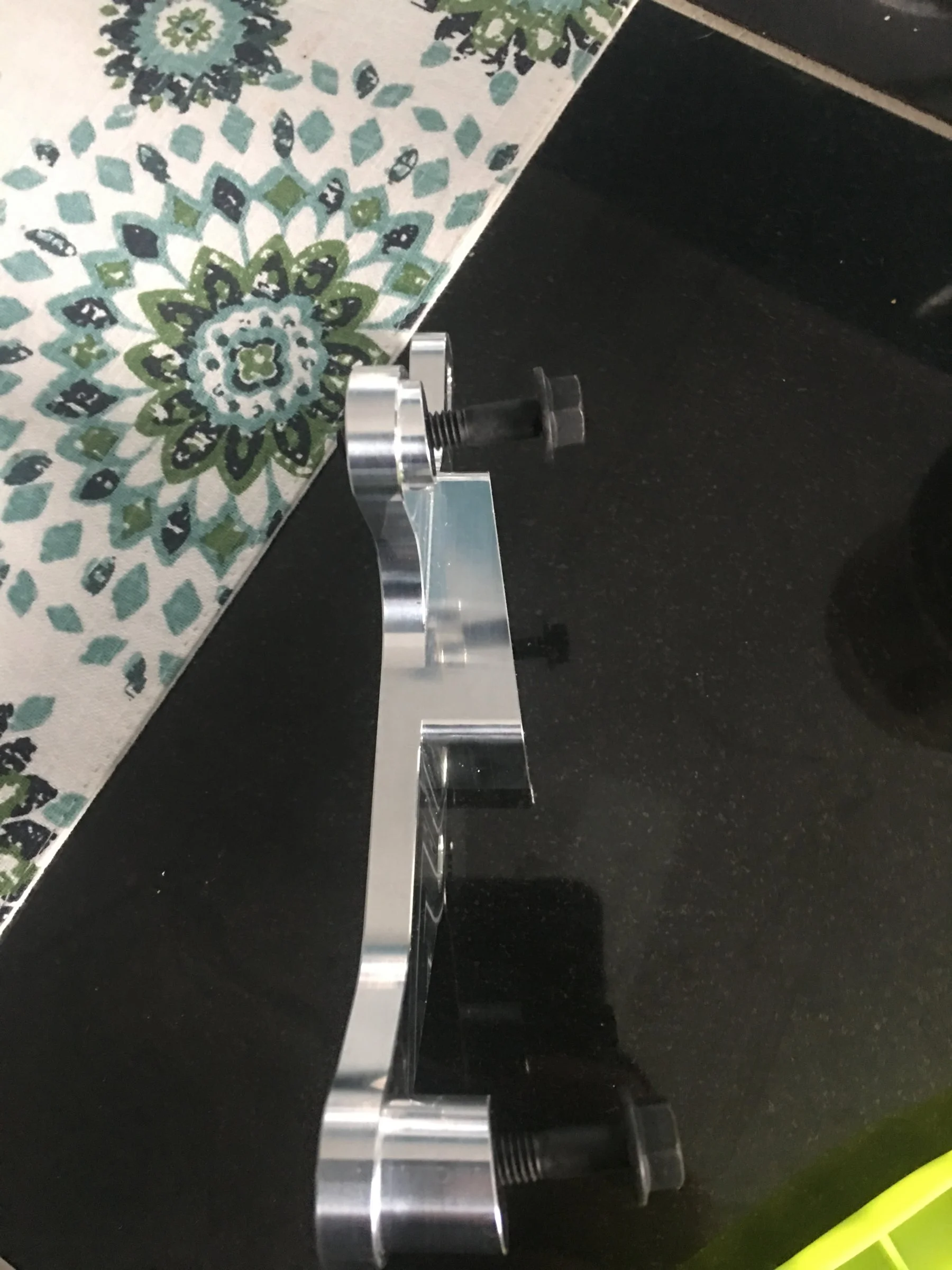

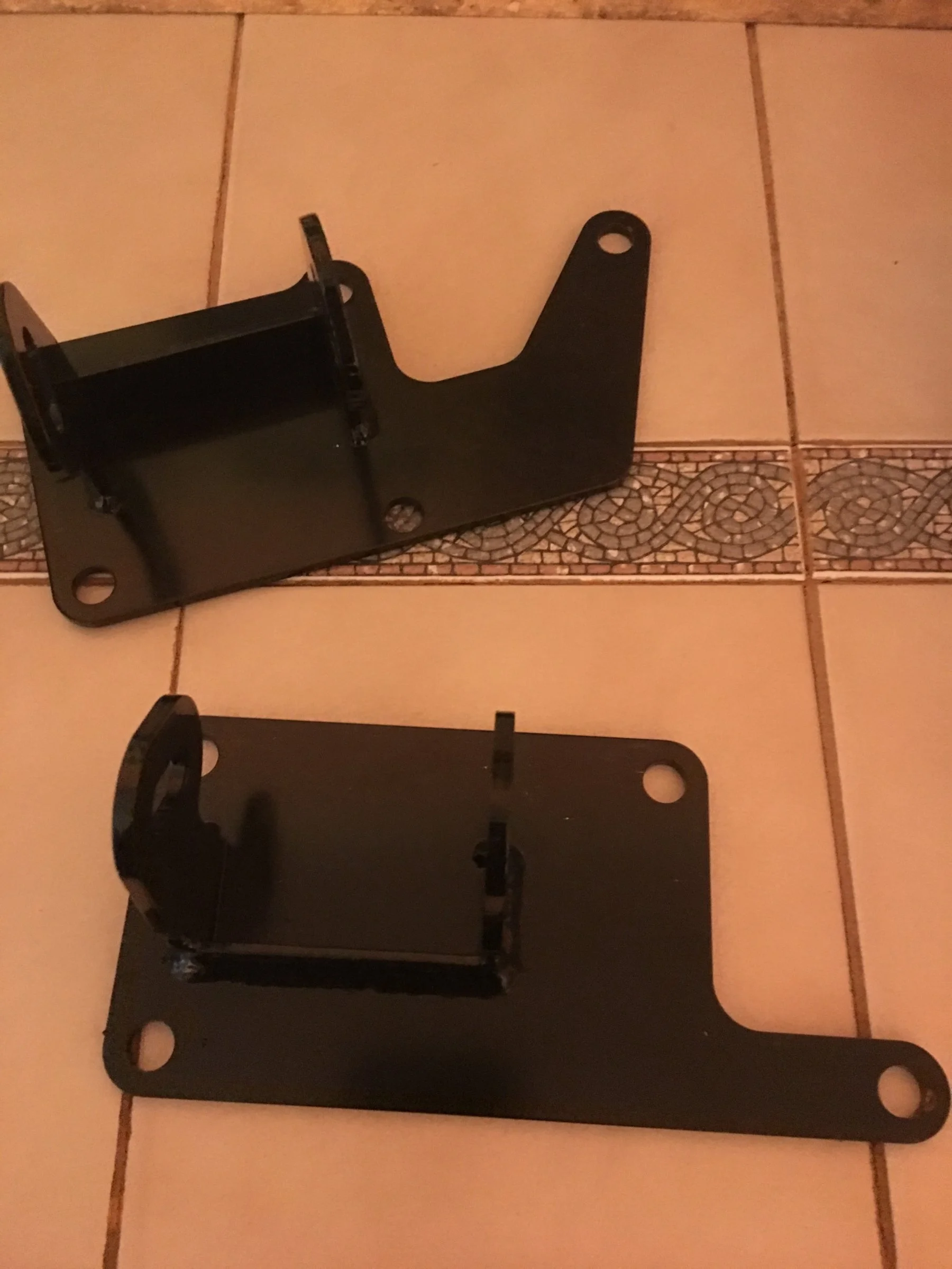

Thanks more arrived today motor mounts never dealt with AJE before but they seem to be very well built. The suspense of waiting for everything to show up is killing me. I just want this done so i can enjoy the car for late spring. Hopefully!!! For those wondering id say ive ordered about 85% of the parts i need and to date ive spent around $5375. I still need to order fuel line and some fittings possibly a crossmember and also possibly a oil filter relocation kit. The only thing i have not decided on what to do with is the gauges not sure if i want to go auto meter as i already have a Florida 5.0 housing and a speedometer. Or if i want to go with a Dakota digital. In the end i believe i will definitely be under $7000
