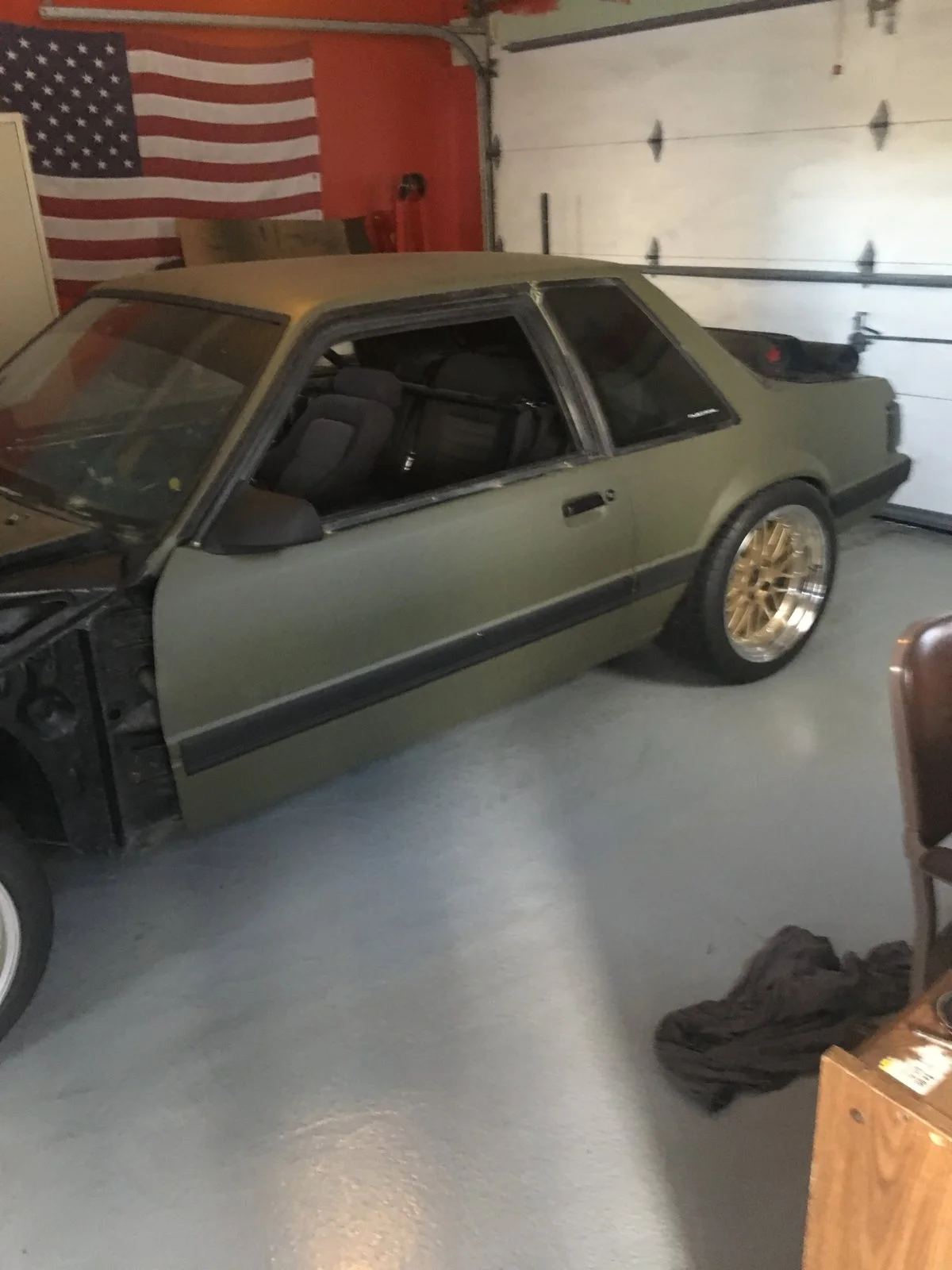

Progress Thread 6r80 coyote swapped pig
its in was not easy everything is is very tight fit have little more to do:O_o:

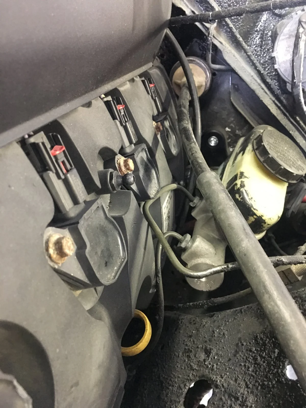

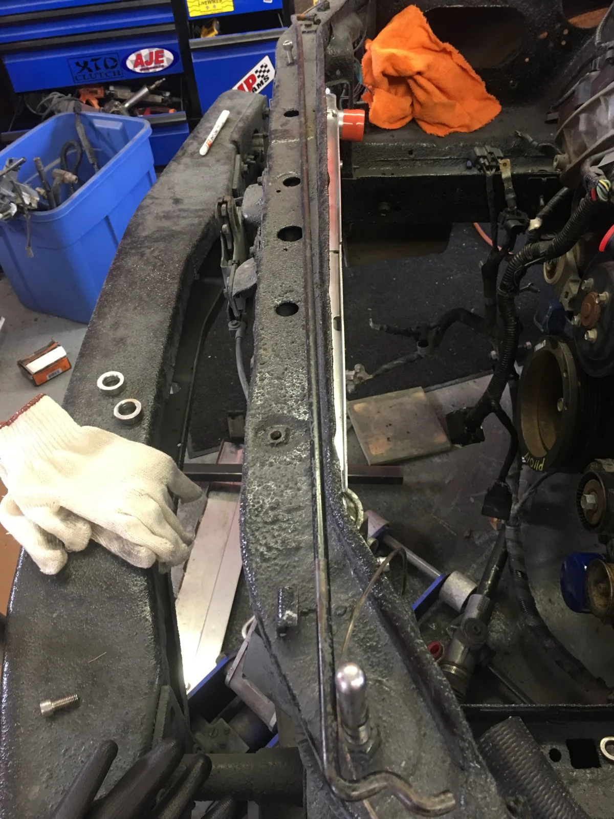

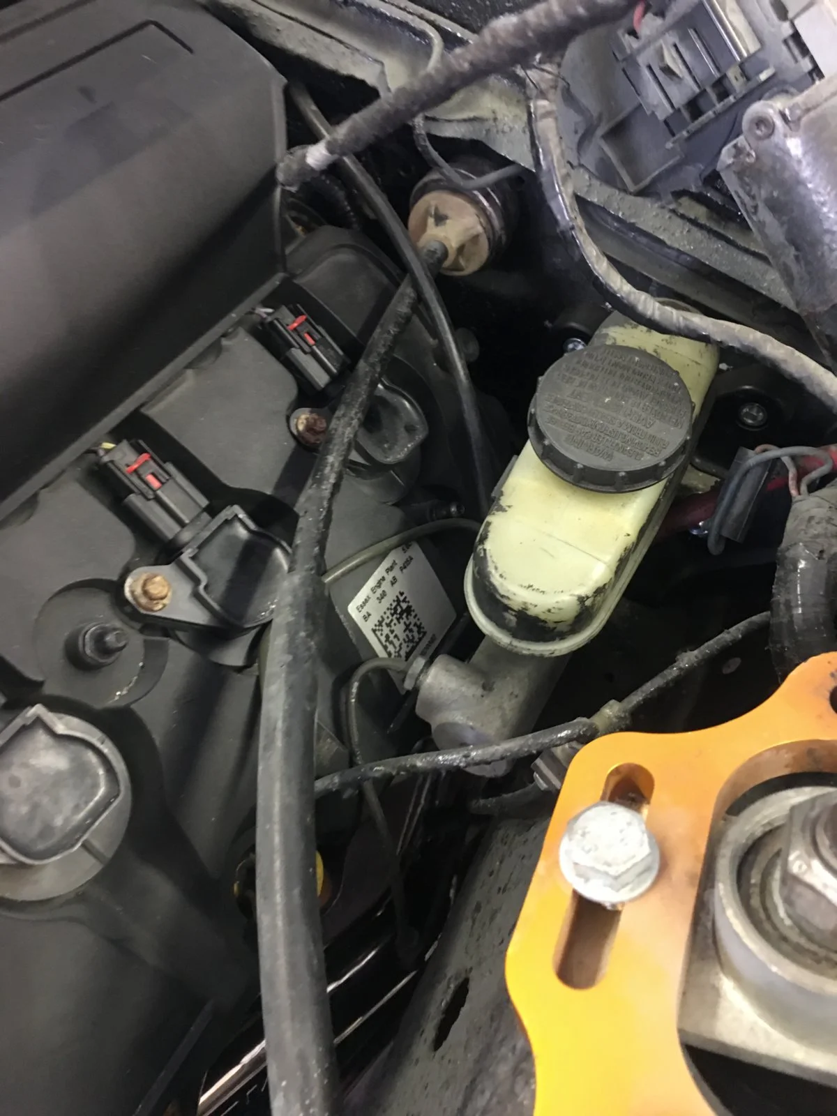

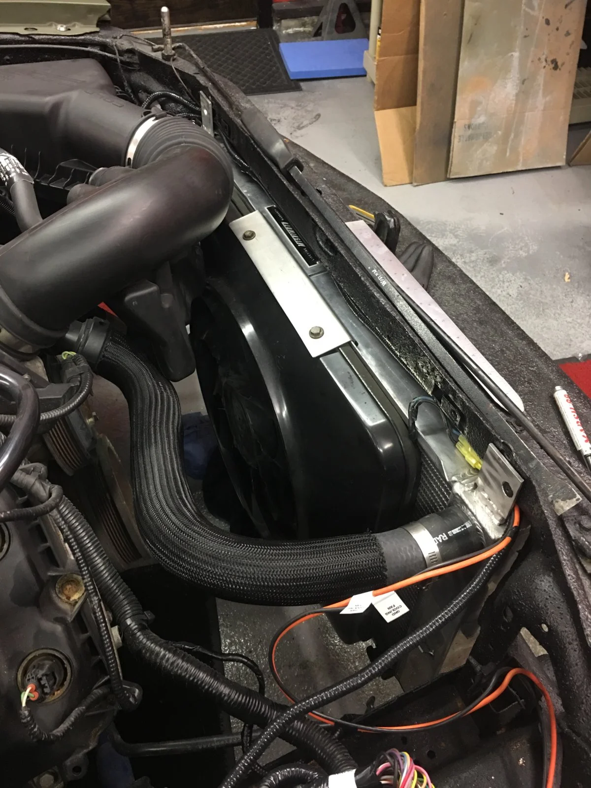

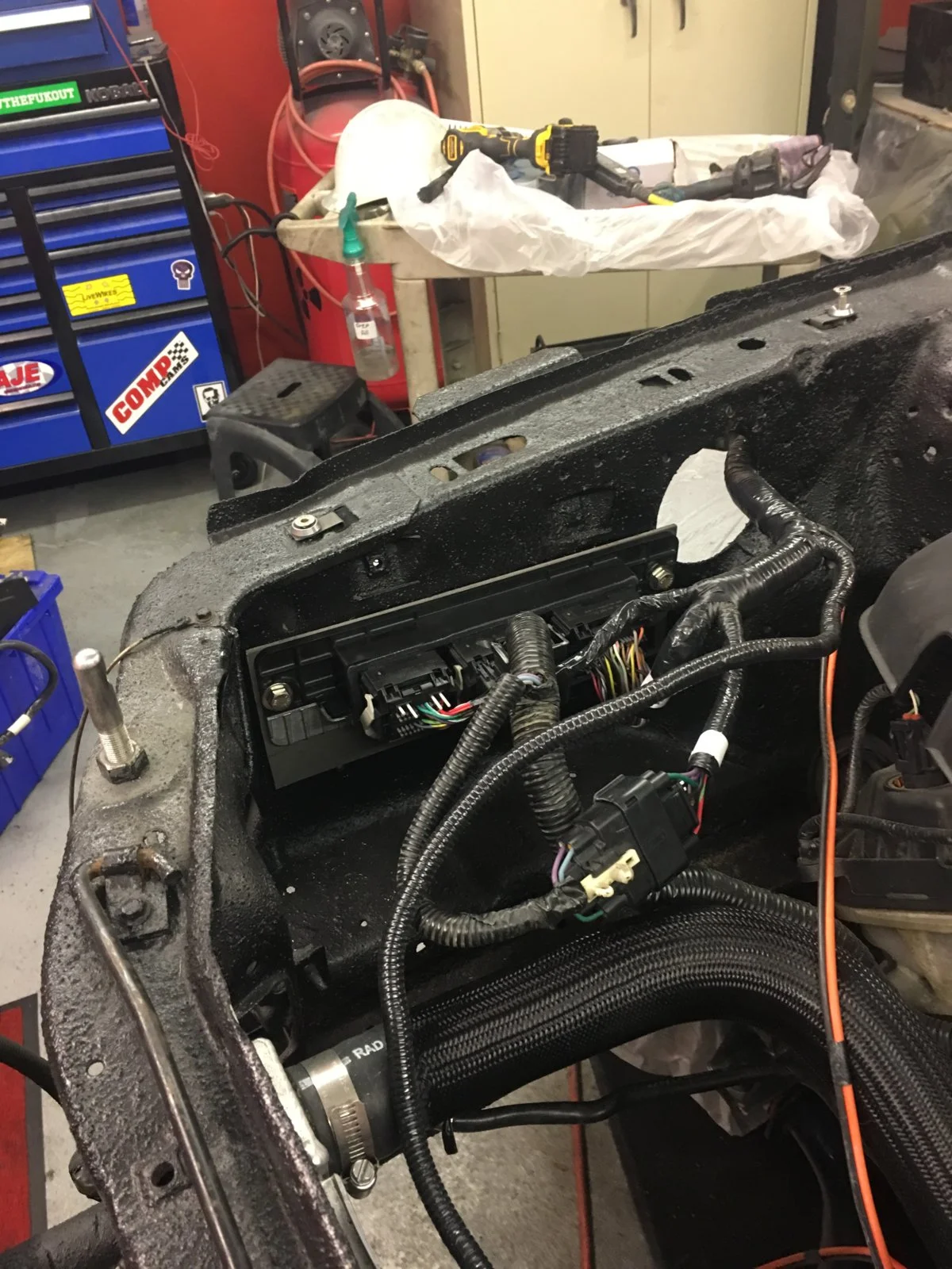

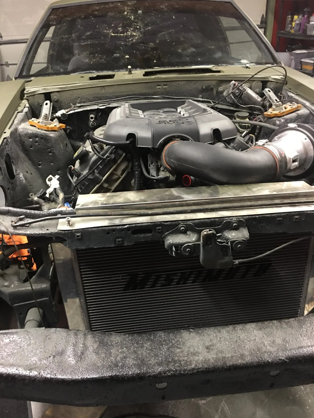

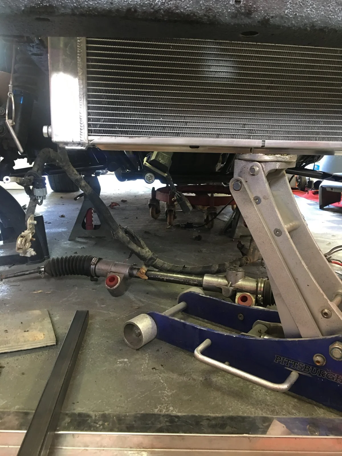

Lots has been done but i feel like its going nowhere fast. Still no word on when harness will be in so that is a set back. I have received my Dakota digital cluster and decided to tuck my radiator under the support. Im also needing help if anybody can link me to a brake master cylinder that has the lines come out of the driver side
stock or aftermarket that is similar to the sn95 specs i guess. Any help is appreciated in my pics you will see the lines hitting the motor.

FYI on the control pack you're still waiting on. It is set up for both standard Ford Electronic Power Assisted Steering (EPAS) and the AiM EPAS for racing. This info might help when you go looking for your power steering. Ford says the AiM steering is not for street use but I know people that have done it with no problems. The steering ratio is quick and takes getting use to.

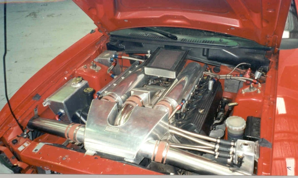

Question: Is that as low as you can get that engine to sit? Have you considered installing plates between the body and K-member to drop it down some more?

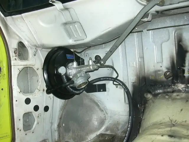

Hogg off your brake booster entirely.

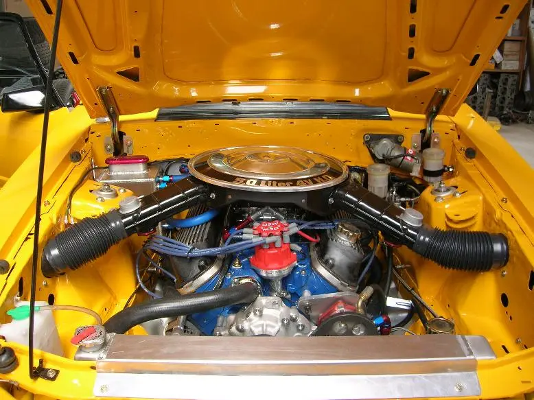

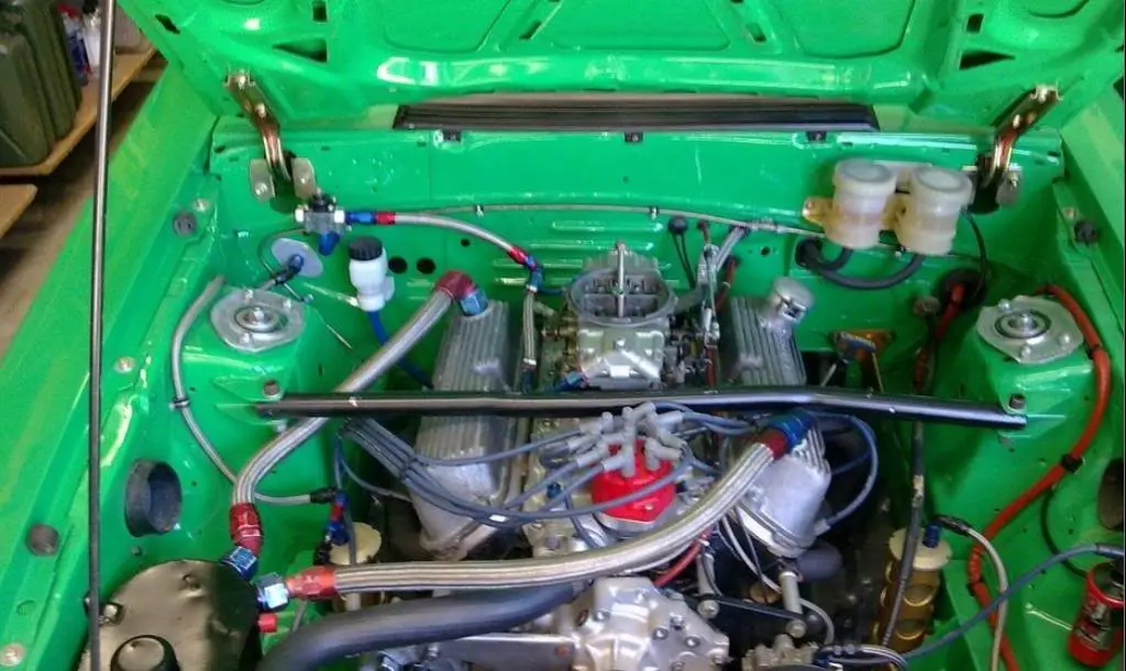

adjustable pedal box with dual master cylinder Triton balance bar, just like the World Rallye Escorts and circuit Zakspeed BDA racers.
See http://www.nzmustang.com/Images/History/Racecars/pinepac1.htm
Twin master cylinders are in the cabin, with the fluid-tanks arranged whereever easiest in the engine bay, and supplied by reinforced-lines

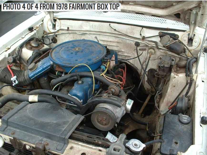

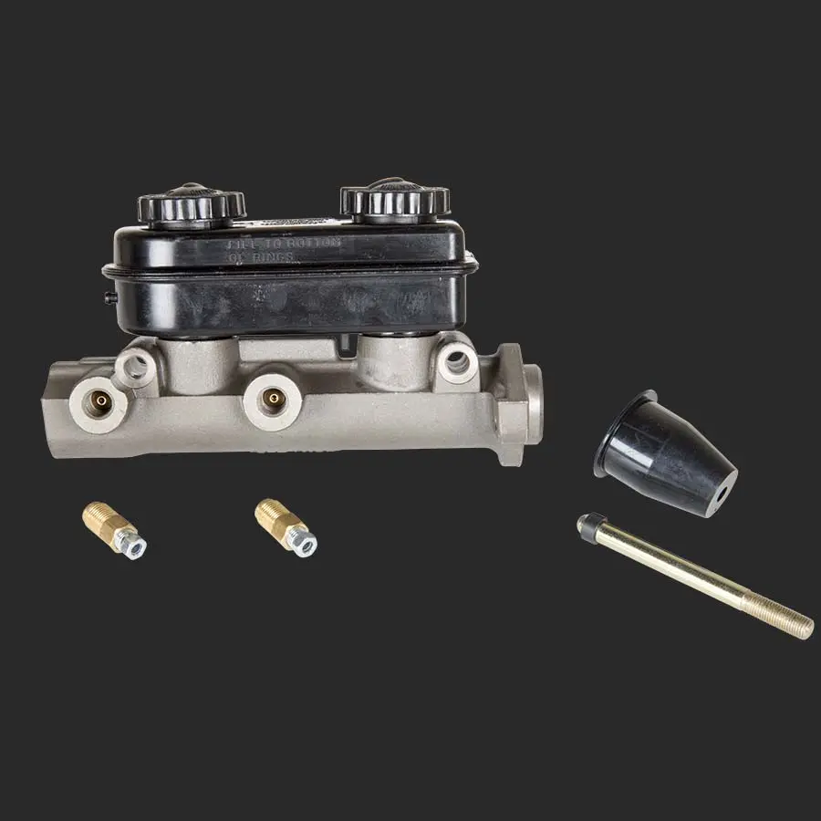

If you "no like", try a stock no power brake master from a 1978-1980 non power brake Fox 2.3 or 3.3.

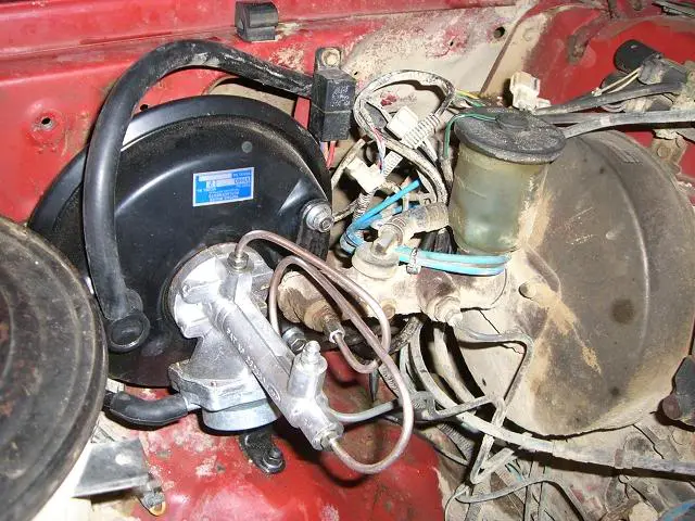

And buy a PBR VH40, and mount it under the front fender.
You can down size the stock one, or delete, and then remote mount the second. There are VH24, VH44 boosters as well, and they are time honoured devices that work great if you can ensure you don't have residual pressure on the rear brake disc's.
https://www.onlineautoparts.com.au/...ower-Booster-Disc-Drum-with-Bracket/ZPN-16668
Used on Right Hand Drive Falcon 289 GT's and old Valiants, and Jag IRS and IFS conversions.
Stock MGB GT Lockheed single cylinder disc brake booster
I've used it on Hilman Hunters, my 1959 Vauxhall Cresta PADX, and they are great for pedal weight reduction
Old cars are still around. A good VH40 is cheap and good valve for 20 bux, and another cost for the rekit. US market MGB's and "Morose" Marinas from Canada are great candidates for finding one. So are Mk1/2 Mini Cooper S's.
thanks for the great info everyone and mike i have seen that master you sent just was not sure if it would work fine with sn95 brakes ill have to do more research on that i only seen that available for a fox and as a manual brake kit.

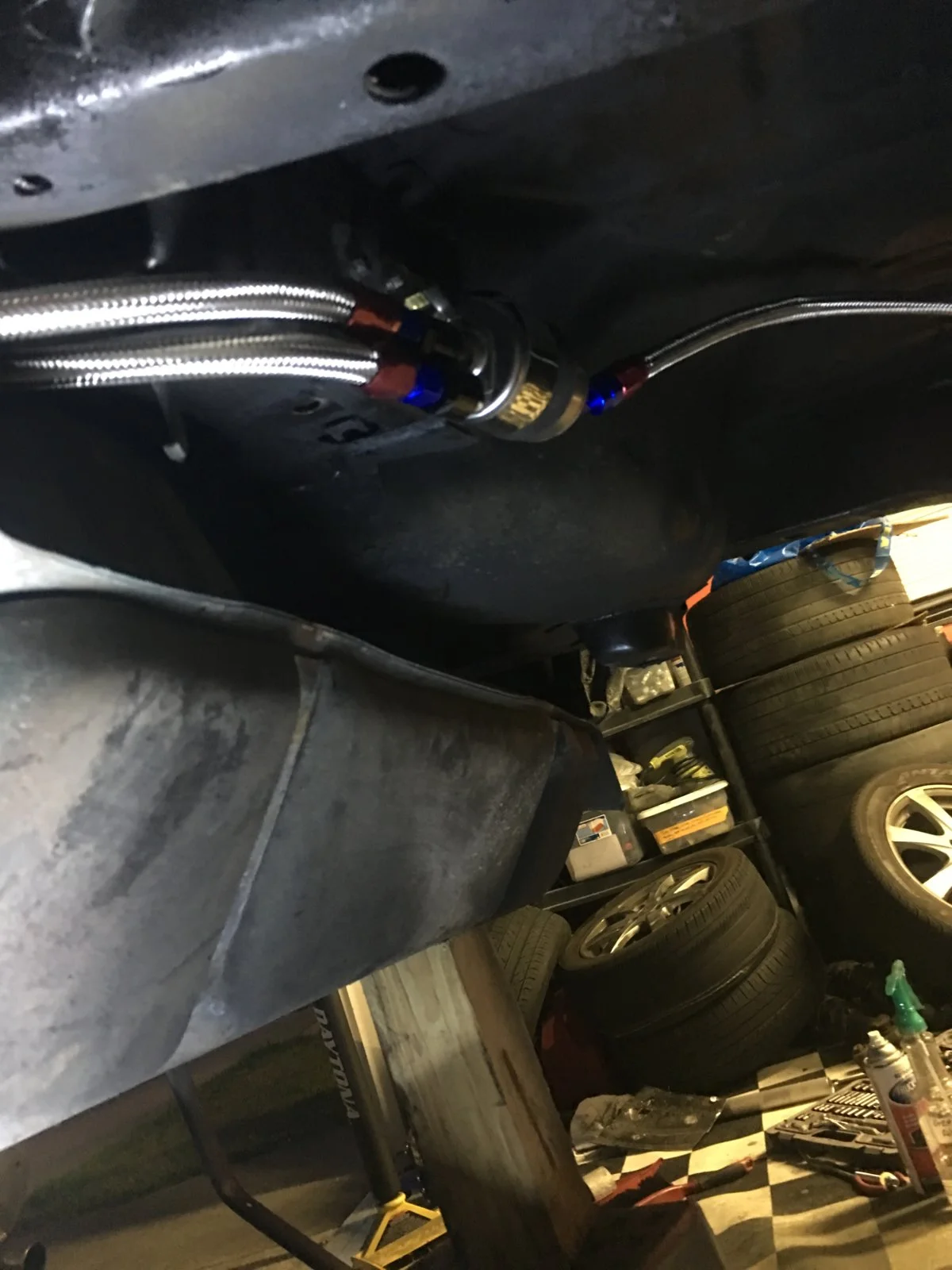

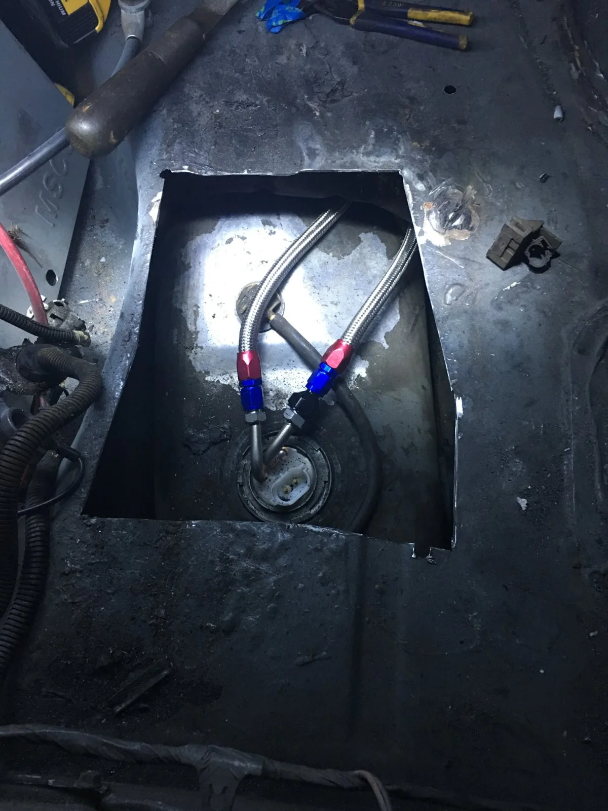

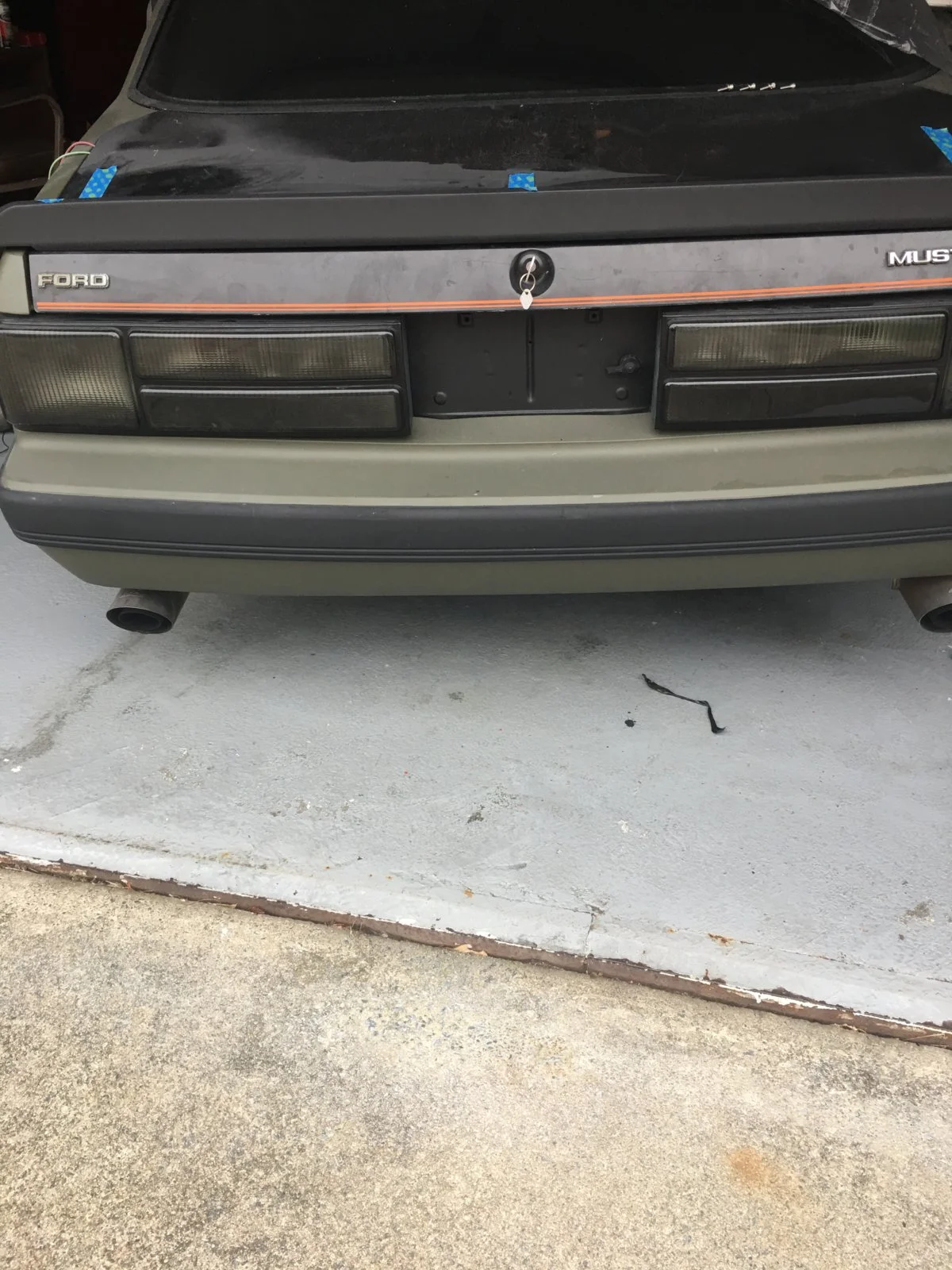

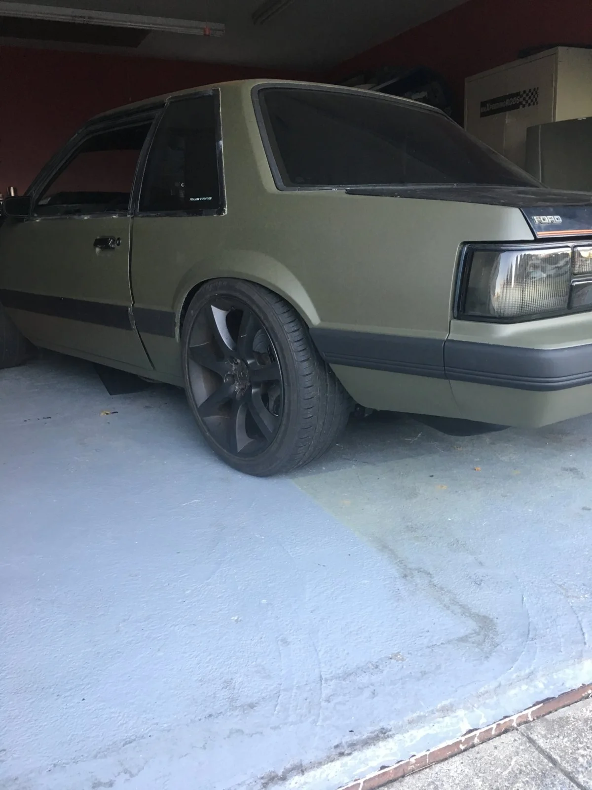

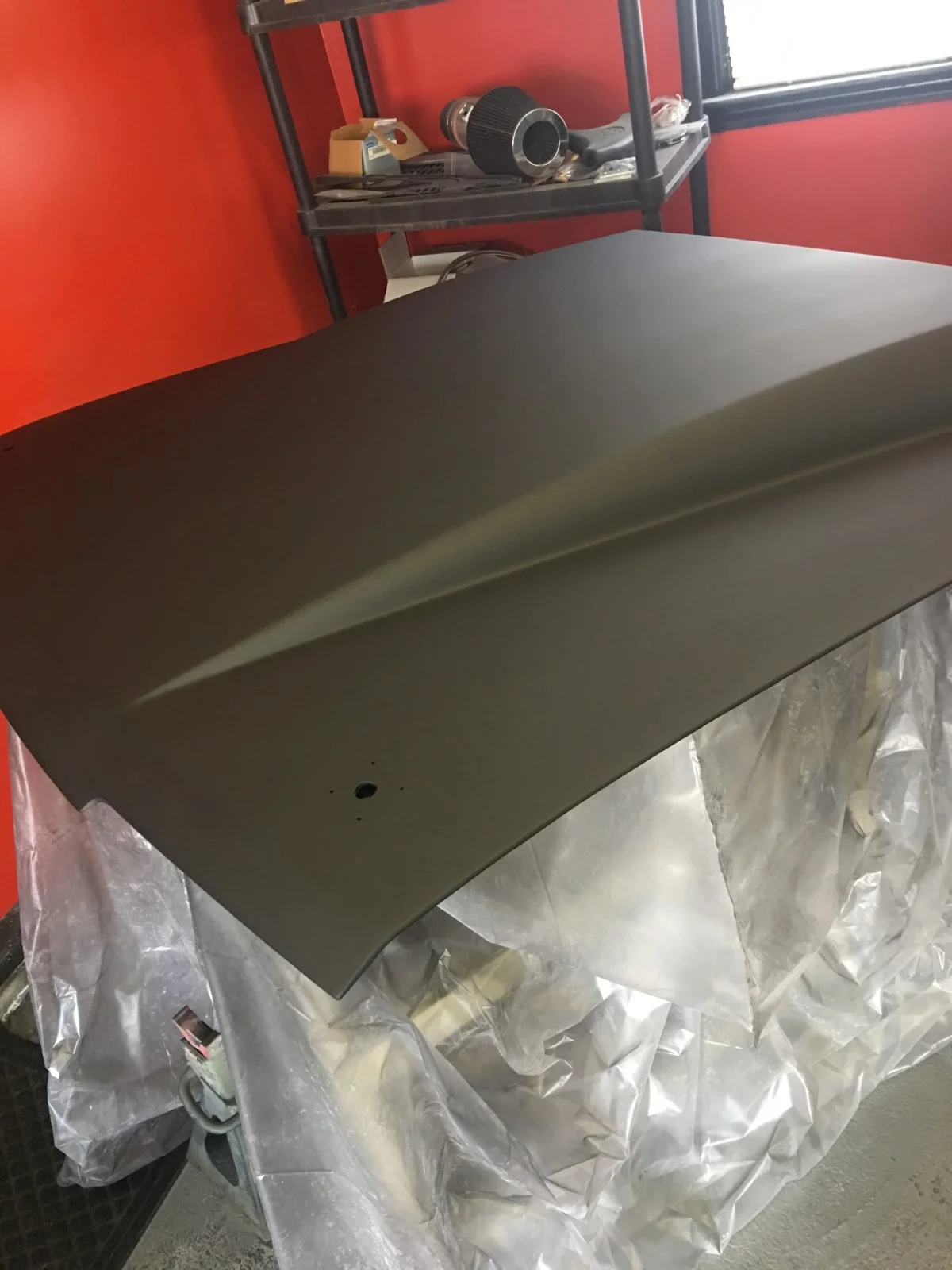

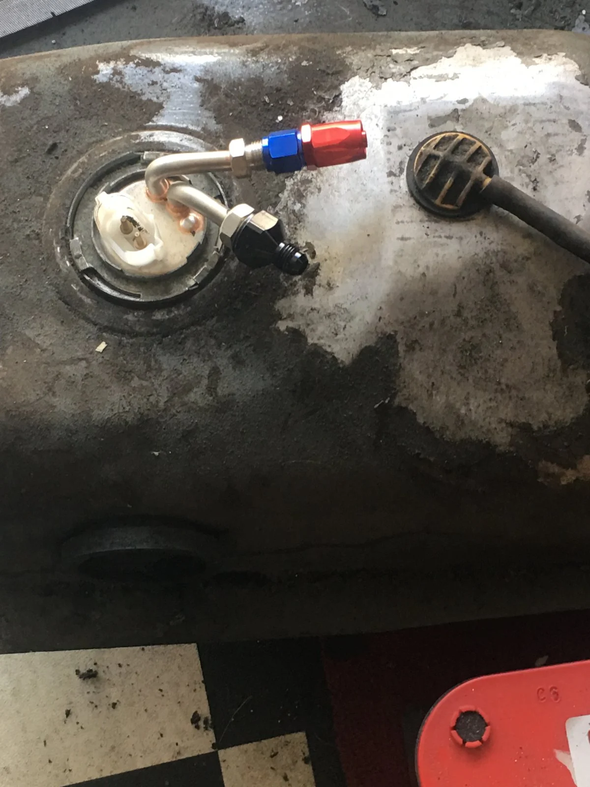

Have been to lazy and to busy to update this but with the little time i have had i made a ton of progress. Installed irs driveshaft fuel lines brake lines explorer master cylinder Dakota digital and started wiring the car. Also got hood painted and moldings installed working. Still need to get rear coilovers and new front coilovers, new rotors all around, bbk x pipe, fender flares and wheel spacers. Also need lots of small stuff like heater hoses over flow tank bleed brakes and stuff like that. I got the motor to turn over but ended up pinching a fuel line while installing the irs so i have to pull lines replace and re route them and hopefully i can fire this bad girl up.
