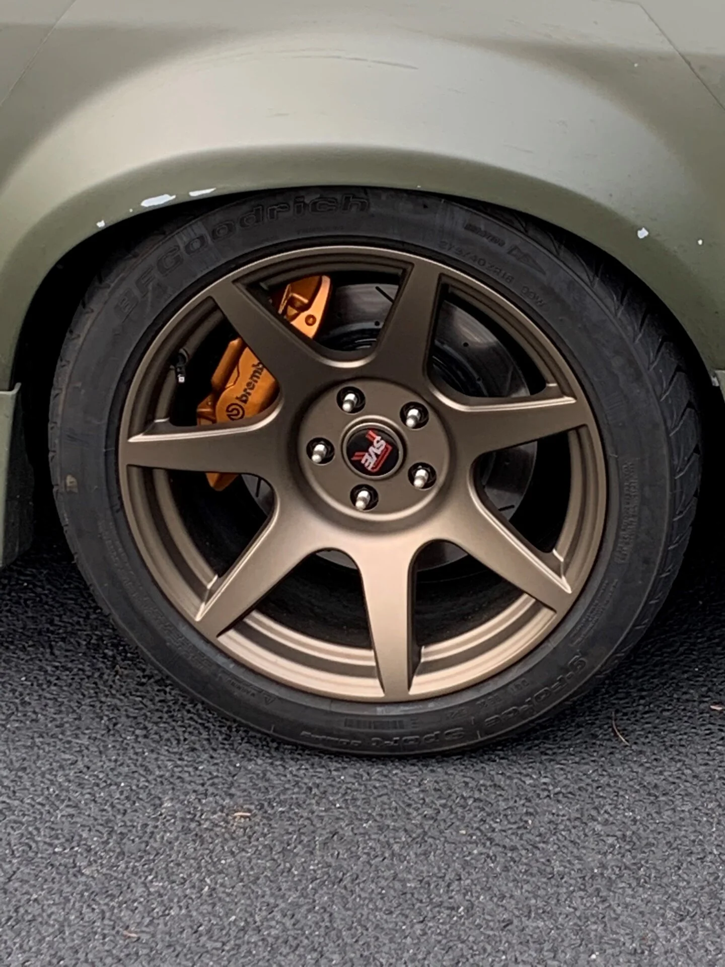

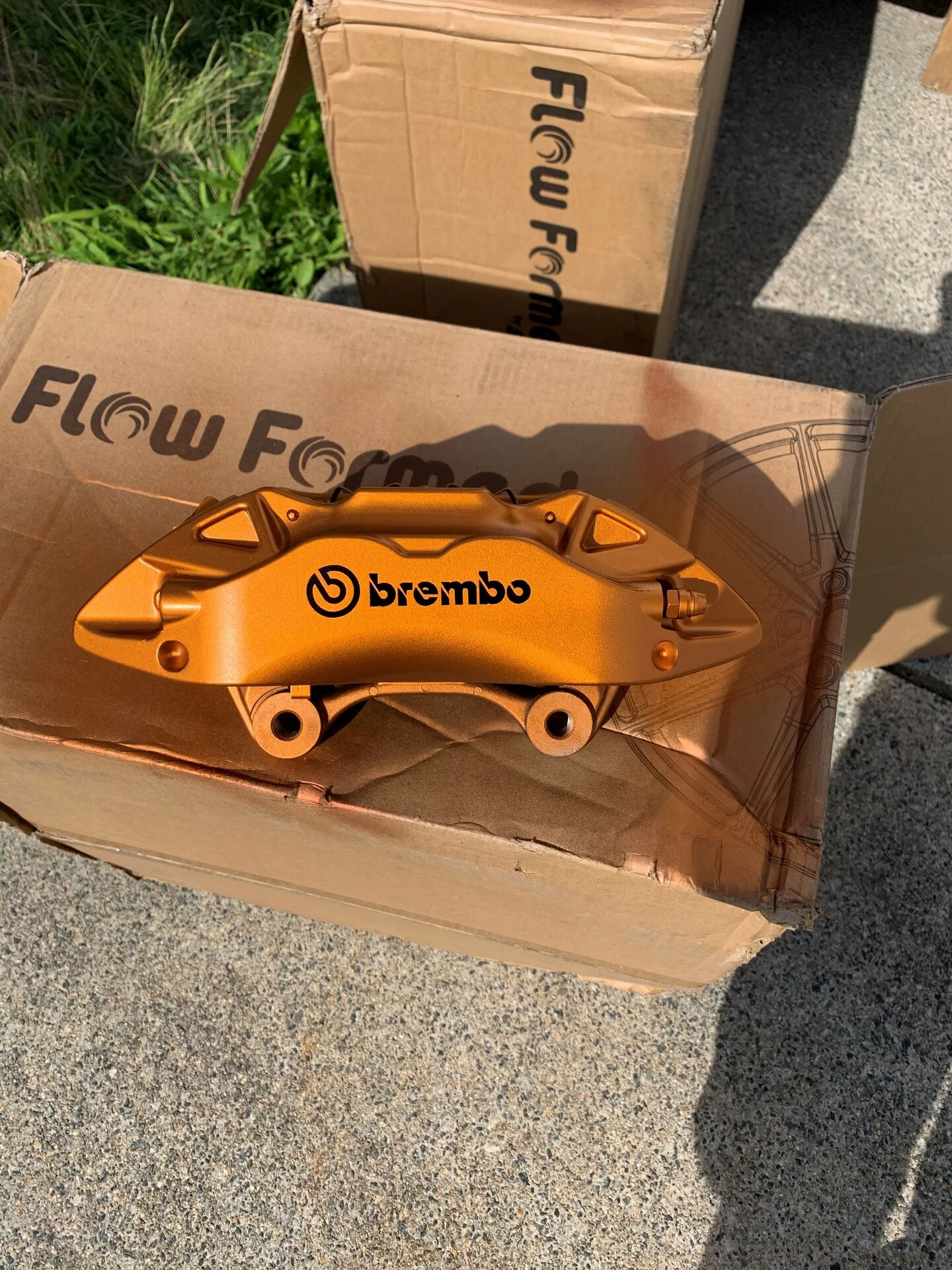

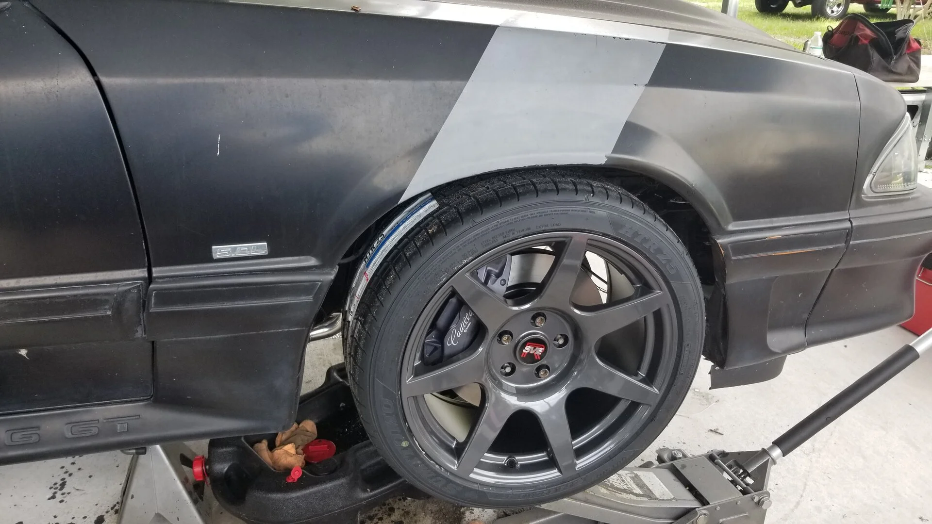

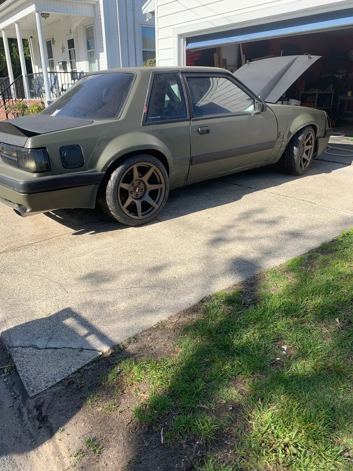

Got around to installing the ATS brembo calipers. There some VHT paint on them then brembo decal and clear coated them. They came out great. I just drilled the spindle and mounted them very easy swap and they work amazing ended up using the stock 03 cobra caliper hoses i had already installed for now. I also could not run my gold wheels so decided to go with bronze GT350 style wheels 18x10 with a 275/40/18 tire on it they clear the calipers with more than enough room and fit the car great. Still waiting on 2 more wheels to show up. Then I will post up more pics.

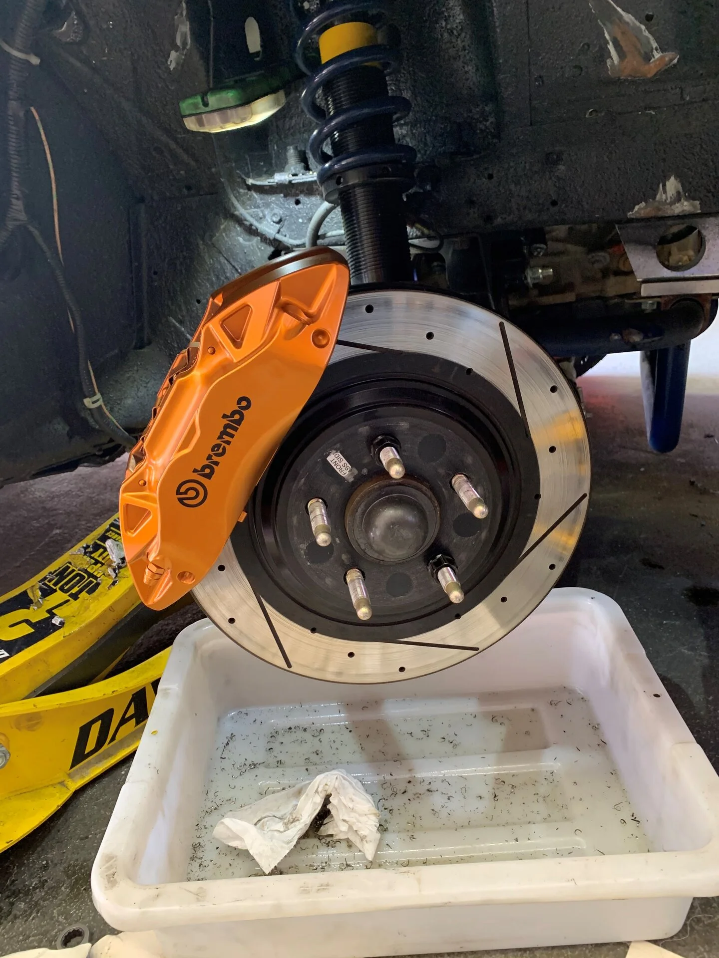

Damn we both did the ATS calipers and the same rims... lol. These are from over the weekend, something to note... the bleeders are meant to face up apparently, to help get air out.

Nice color.
How did you manage to bleed them with the bleeders pointed down?

Mustang5L5 said:
Nice color.
He didn't, I'm sure he has corrected this.
How do they fit on your car. They fit perfect for me. And good to know about the bleeders lol
Mustang5L5 said:
Nice color.
Thanks. I did not realize about the bleeders but had no issues at all bleeding them just did one at a time and worked out fine. But maybe if i swap them around it will be even better
Thanks for pointing that out gentlemen

I used the ss engineering kit to do my installation, when done the caliper was centered over the rotor. I have plenty of clearance for the rim.

I was debating for a while on ordering a kit for it but decided to just drill the spindles i do have a minor overhang of the bad not enough to bother me. I may change it in the future when i powdercoat my new spindles and upgrade the K member again

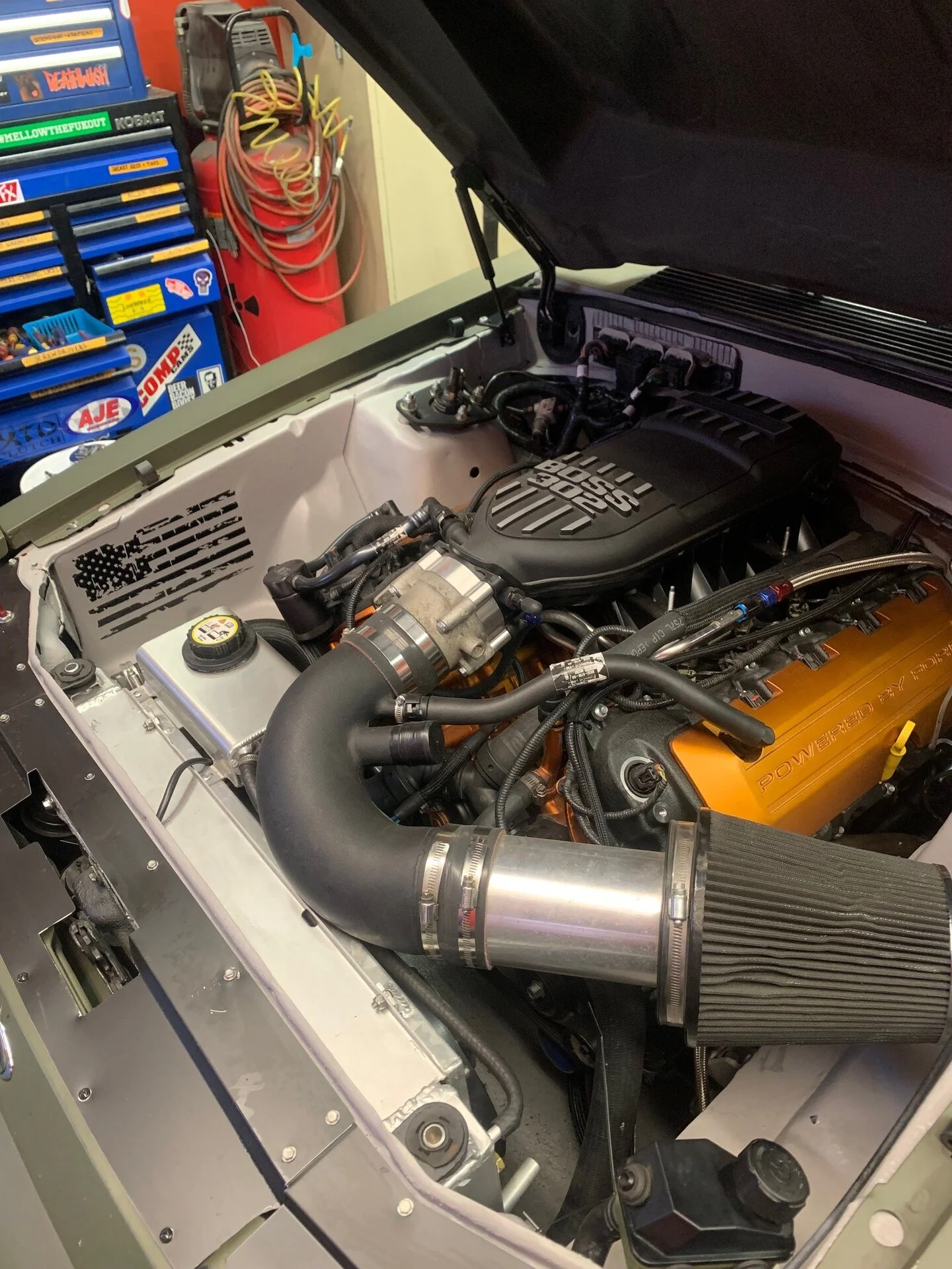

Long time no update for me. Killed the t56 last August and made a decision to do a 6r80 swap. Other than the engine swap the 6r was a very satisfying swap. While had the transmission problems I also had a cam cover leaking and decided to drop the motor. I ordered 2021 gt500 aluminum cam covers and had them coated. Then decided to clean up and paint the motor and add a boss 302 intake. Redid the engine bay pulled the dash rewired everything added a Lokar electronic shifter and redid the exhaust to be a full 3 inch all the way throughout the car. Next up will be a Whipple or VMP supercharge and Holley terminator... Decisions

My thoughts exactly and the battleship grey makes everything just pop.

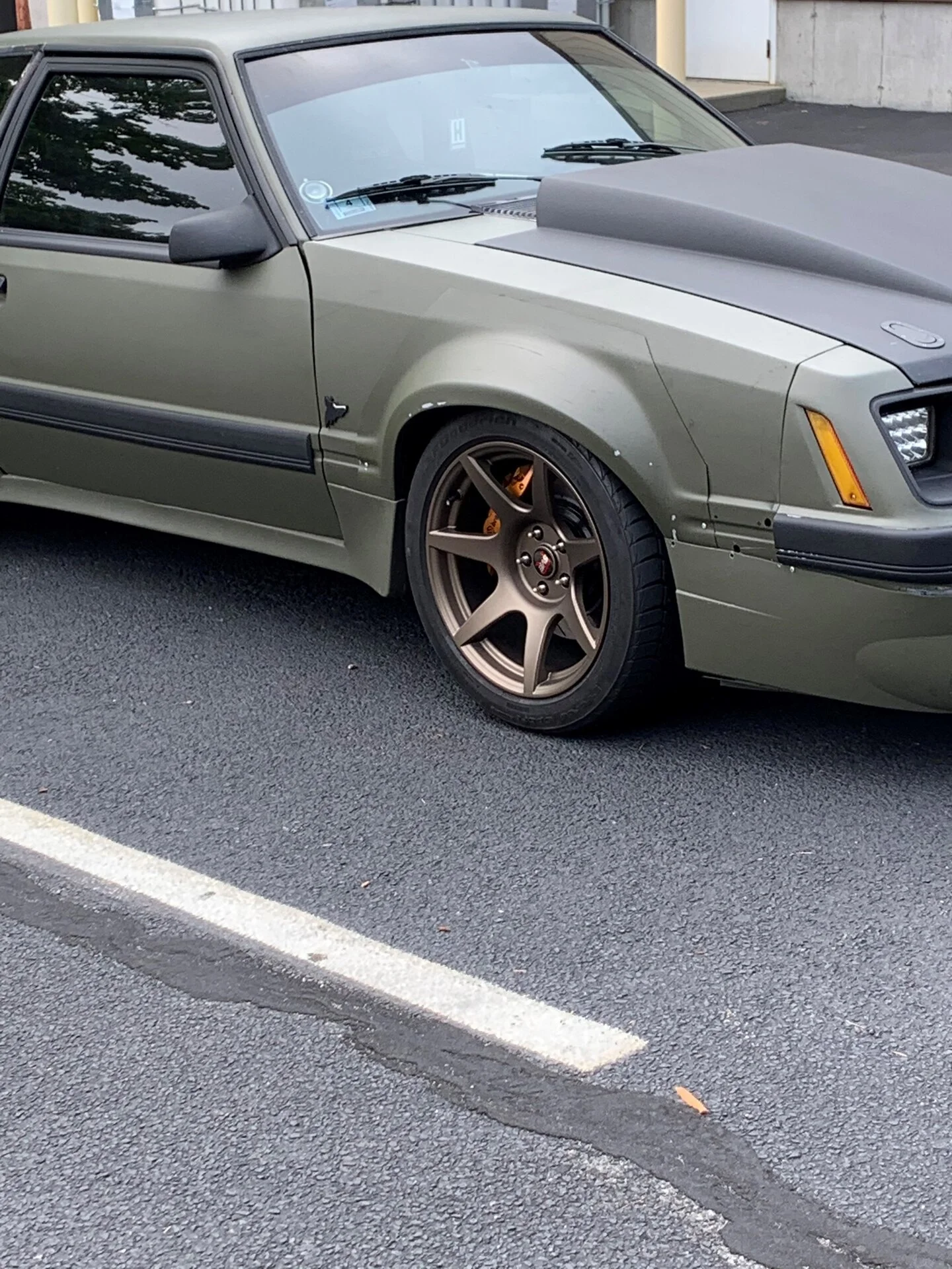

Figured id post up some more pics of the car. Been driving it almost daily bringing it to work to shows anywhere I want. With the amount of hours i put in at work I've had no time to finish up a lot of minor details on the car like the bumper, chipped paint on fender flares, and some interior work. But I do get to enjoy the time whenever I want so that's the upside to it all.
