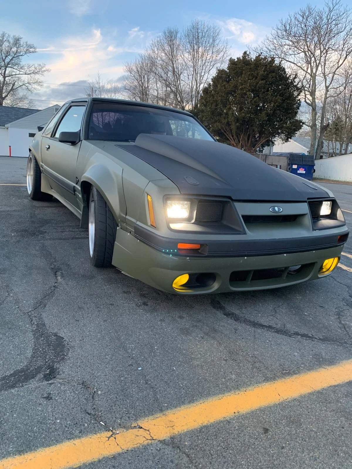

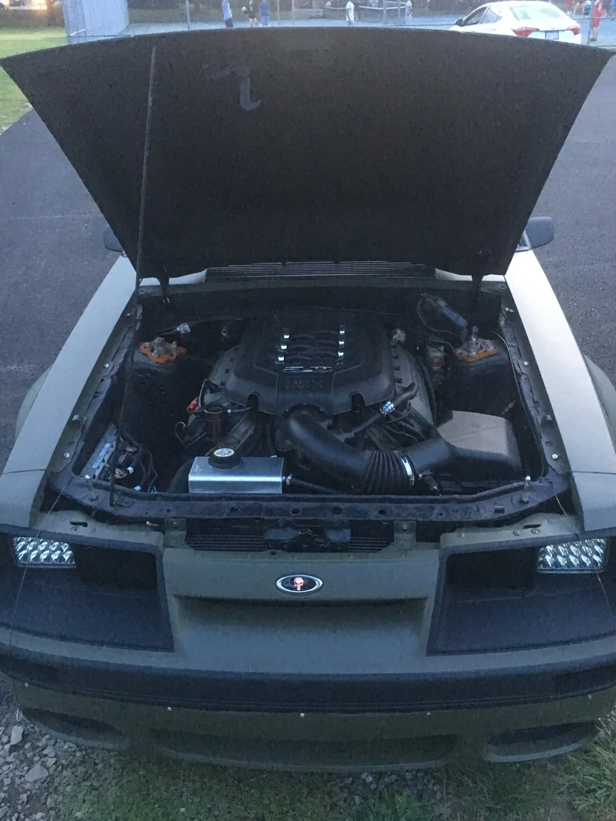

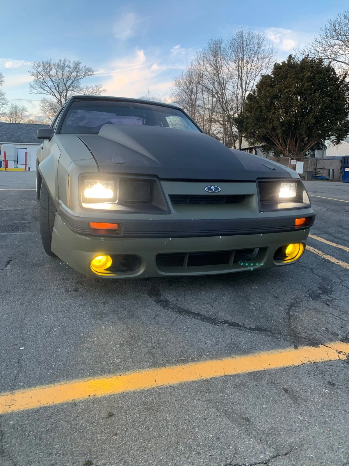

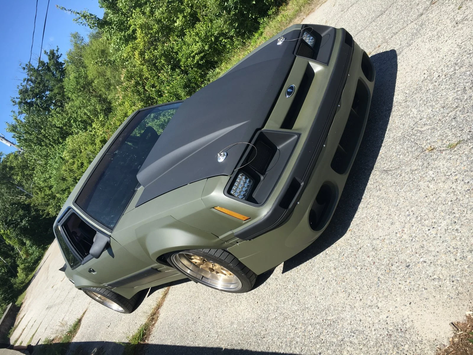

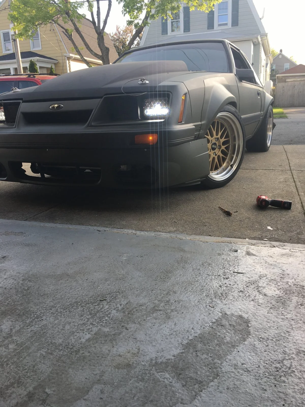

Also wondering what everyone thinks about my headlight vents i made up. I figured why not because one of the 4 eye headlights dont work the way i want because my car is a 89. And it will get the extra air to the intake i need.
Sick!! I like those rotors what brand? How will those hold up once the pads hit does it just stuff down?
They are from ebay Callahan brand like from the movie Tommy Boy lol. Ive used them for a few of my other cars never in the black zinc and they have held up fine. These i touched the brake one and it pulled off the finish. It did not bother me much as i am preparing to purchase a big brake kit front and rear in the very near future.

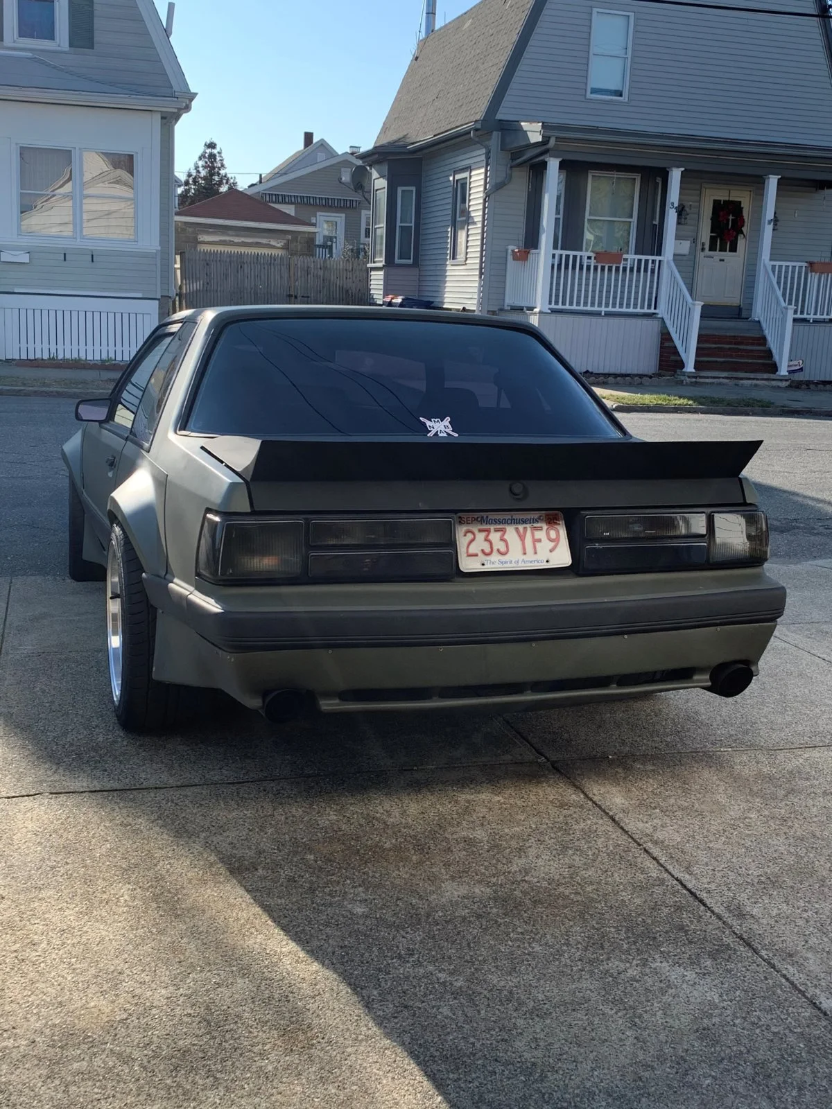

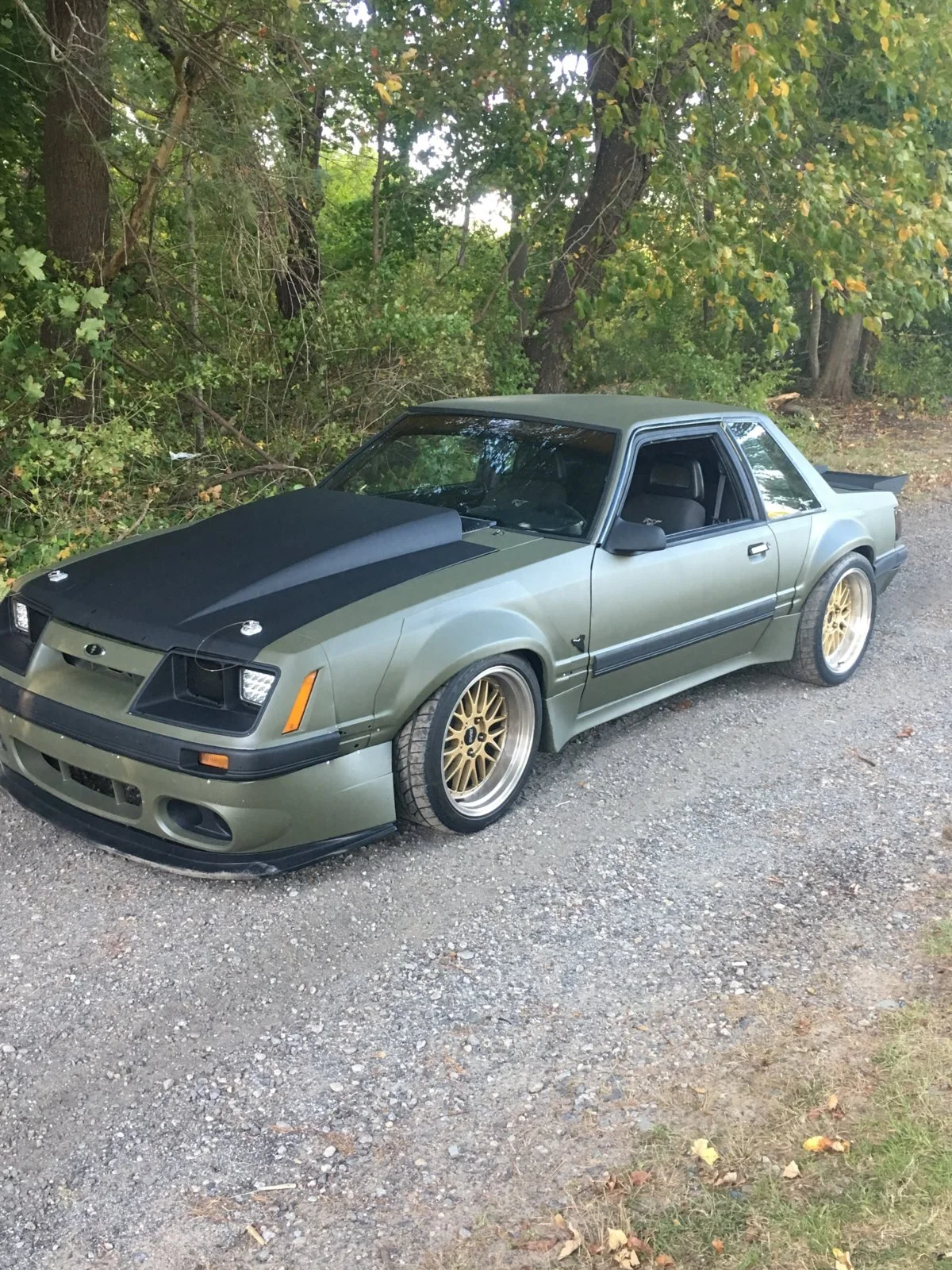

Small update just need to align the car. I do plan on molding the flares and bumpers to the car over the winter it is far from perfect and im fine with that as long as i can enjoy it a few times this year. Also i could not get the moldingt to all work without heavily modifying them because of the flares so those will need some love as time goes on also. I will post some more pics very soon

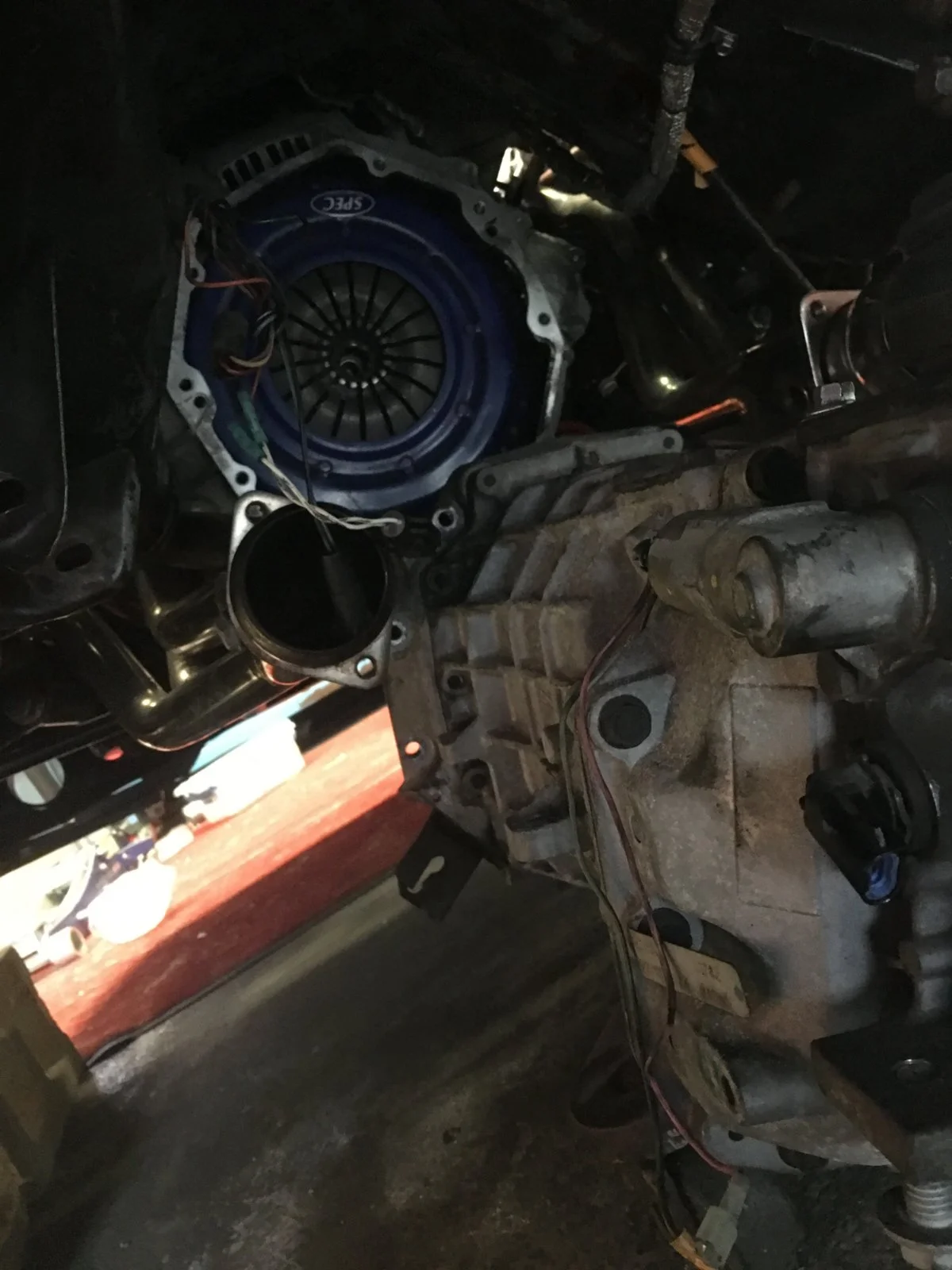

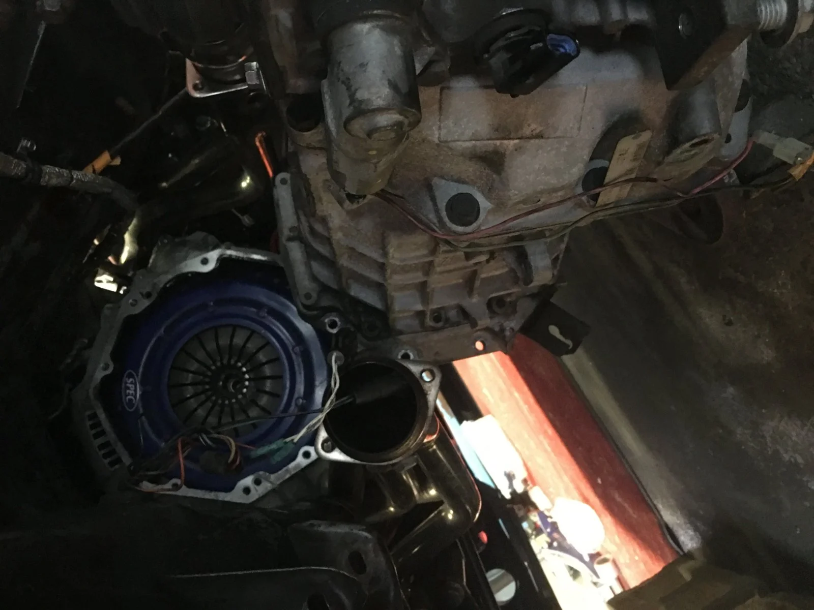

Long time since i have posted.. Got the car up and running for the last part of the summer put maybe 1000 miles on it. Killer gas milage and the car is quicker than i anticipated. I learned very quickly I screwed up when I installed my tremec 3550 and a cheap clutch. Now its time to correct that. I picked up a spec stage 3 which will be swapped in the future to a twin disk when i build the t56 i picked up. I also plan on installing a sequential over the winter and tuning the car. Anyways you guys dont care and probably just want to see pictures.

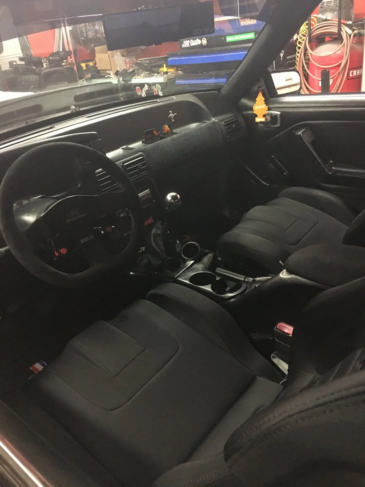

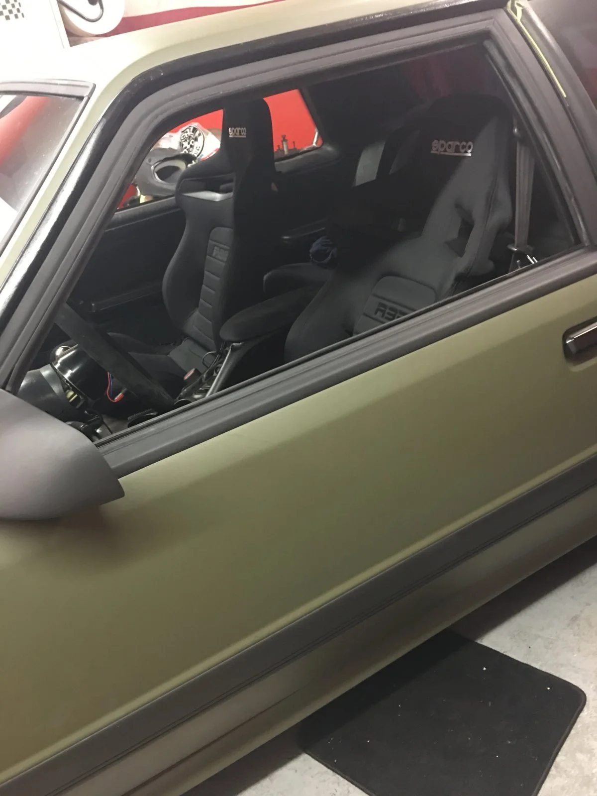

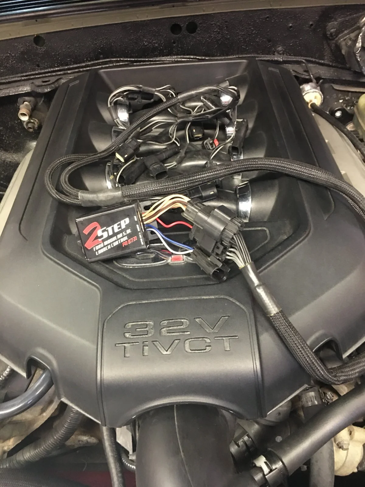

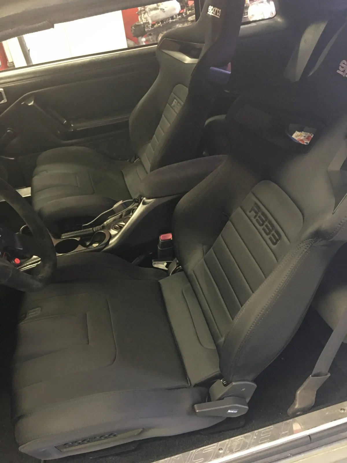

A few updates on the beast. Finished up the T56 swap and have no complaints other than needing to resolve some annoying clutch adjustment issues. I decided to have a some fun and bought a msd 2 step which will sound rowdy with my cut offs when i get around to installing them. Also spent a little more than i wanted on a set of seats. They are
r333 and fit perfect in the car but they sit up a little high so ill have to fab up some lower mounting brackets. All in all im happy with it.

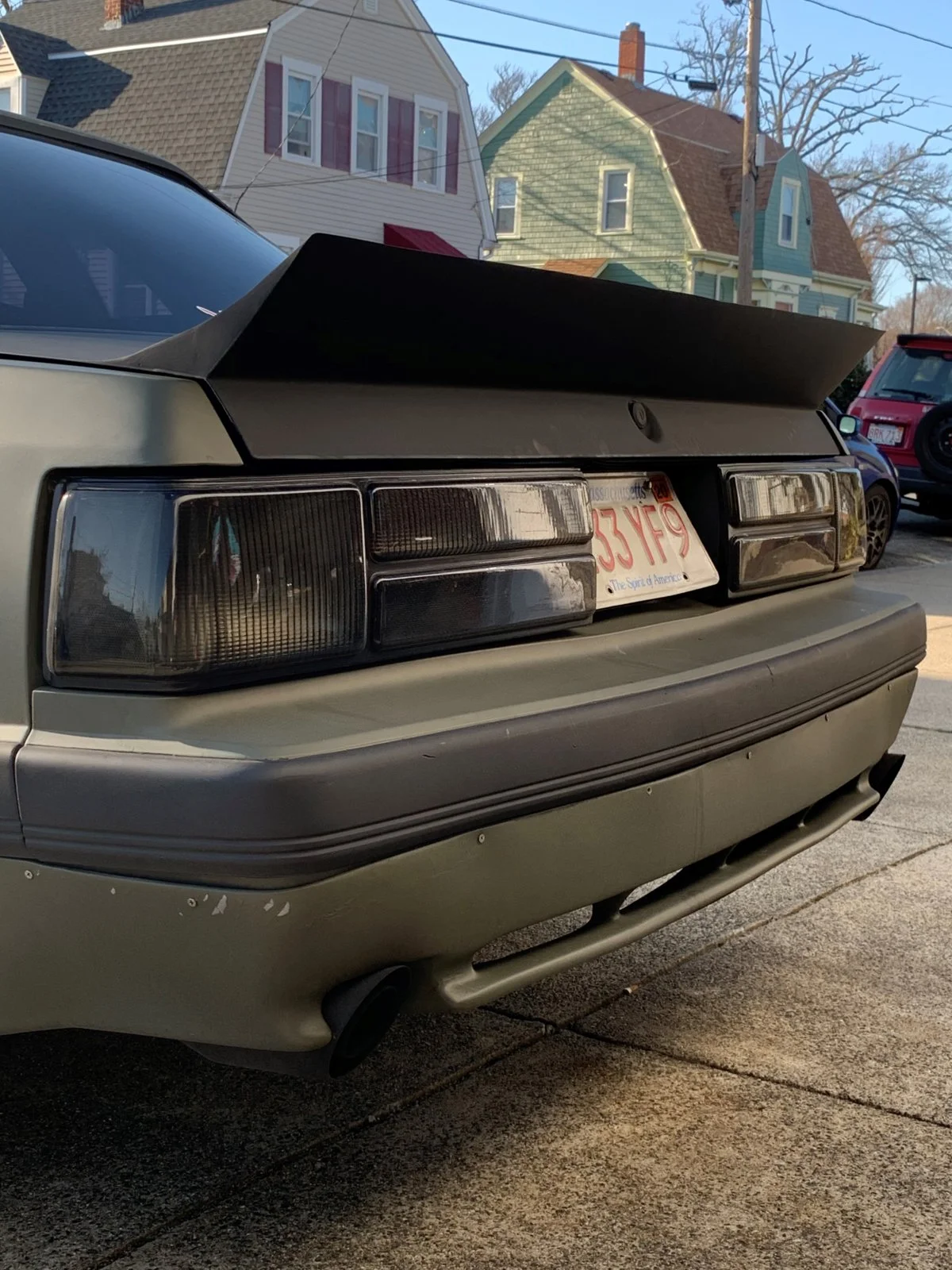

Which “ part “ of this duck drawing would you say the spoiler more closely matches?
Here we go again,...a ducks “tail” is what the spoiler is named after. It’s even on the right end of the animal So that it makes sense ending up on a rear deck lid. Whoever decided that the duck bill would be on the back of anything is another instance of somebody that should’ve paid more attention in biology class, and how we get these incorrect word usages into the mainstream.

I am so sorry to inconvenience you I will not do it again sir please forgive me.:lol:
