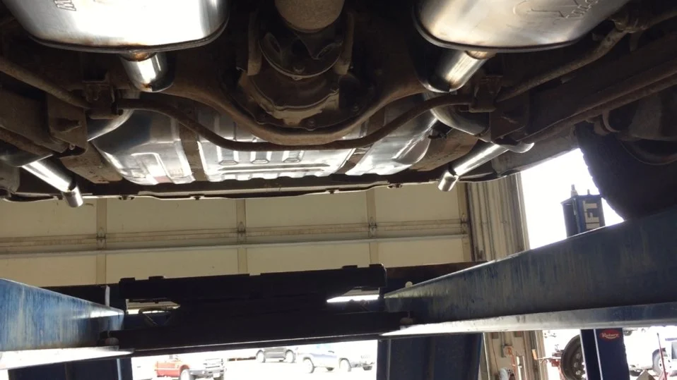

I've freed up the exhaust with dual crossover pipes and MagnaFlows. The setup is very mellow and well mannered as far as sound but the gas really kicks out the back with some considerable force.
I have a brand new aluminized-steel gas tank installed.

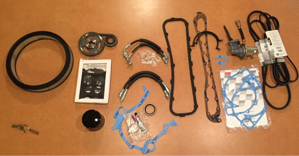

Next:
I've already purchased my "straight up" timing gear that will reset to 0° offset, the proper original timing. This will be installed as I do the following.
Replace fuel pump and filter
Flush block coolant
Clean oil pan/replace gaskets
Replace valve cover gaskets
Clean and tune 4bbl Motorcraft 4350 carb (650cfm I think)
Replace and tension accessory belts
Flush radiator and leak test
Replace air filter with Wix-brand
Clean or replace distributor cap and rotor
Set ignition timing and recurve for new cam phasing

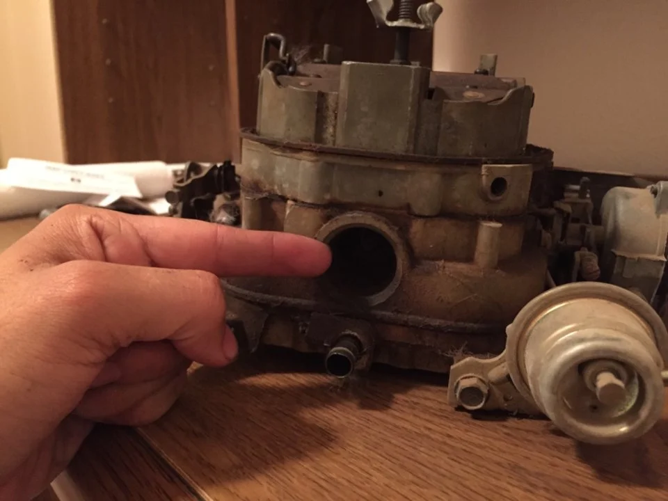

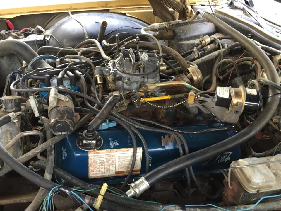

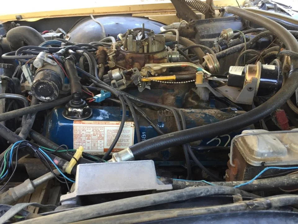

Pulled the carb off and found that a sort of freeze plug had blown off of it. Good thing it sat tucked in the intake manifold. This may account for the backfiring when you drop the throttle.

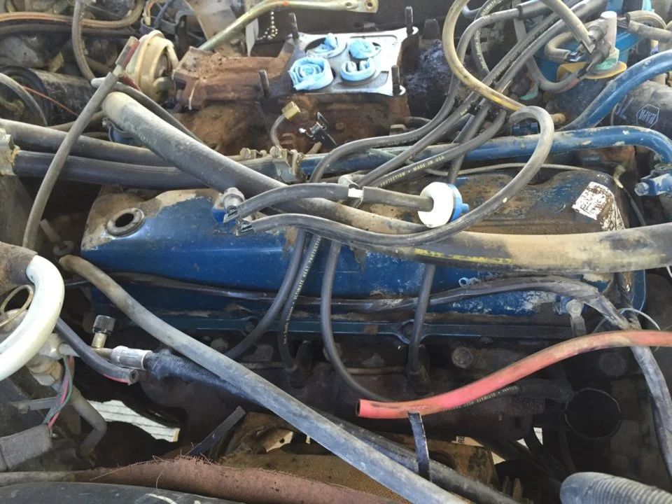

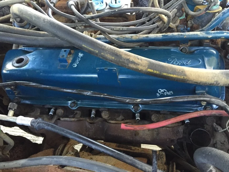

So I've cleaned the valve covers and replaced the cork with rubber while the carb is out. I'm debating removing the AIR system entirely. Opinions?
Ok I'm keeping the AIR injection, but I'll need to replace the valves to end the popping in the exhaust. I find it only happens when the vacuum signal hoses are plugged in. Unplug them and no noise! So time to diagnose and fix that.
I only had the weekend to get this done, so everything was rushed. Very impressed with my first car carb. She fired right up and hasn't had issues since. A lot more response now that the accelerator pump lever is adjusted, as well as the float.

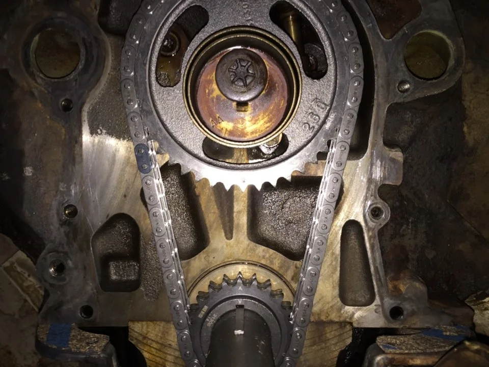

Next week I hope I have the guts to get the new chain in there. The more I look at it the more it looks like a tight fit. I may also replace the front main seal since oil is appearing around the balancer.

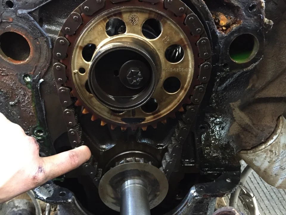

Boy was that chain STRETCHED! It was even starting to wear away one of the oil plates in the timing cover (one of the little shields that keeps oil from dropping onto the crank.).

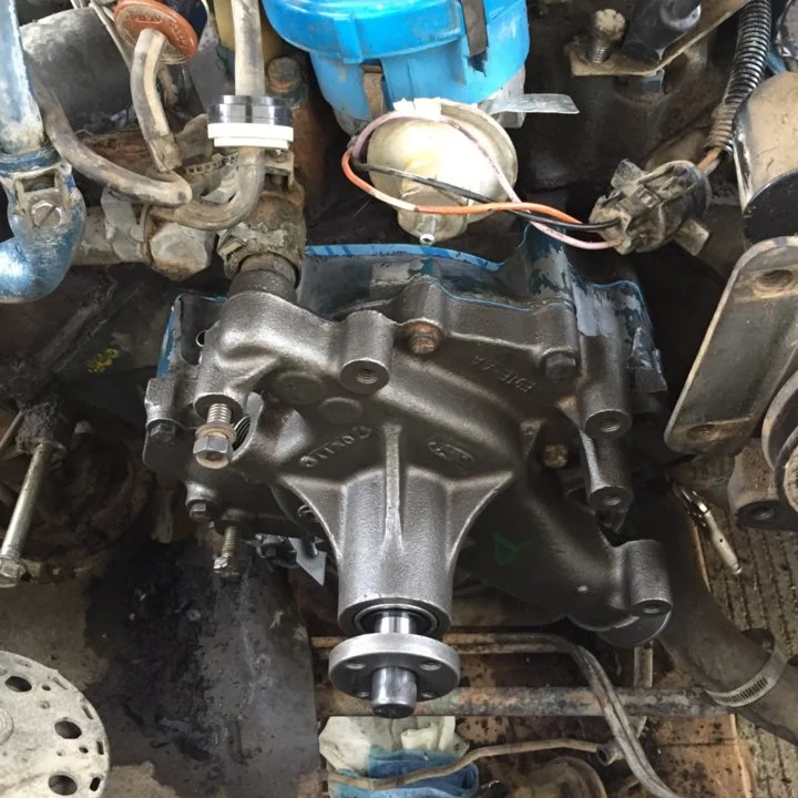

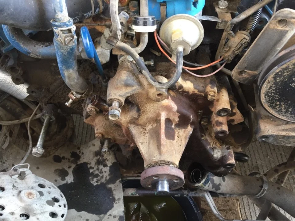

This weekend I've replaced the fuel pump, water pump, front main seal and the timing chain.
The cover is on, but needs to be torqued down. Then the pulleys and accessory brackets can go back on and that's it!

With the fiber teeth gear and loose chain, that was a disaster waiting to happen!
I can not tell for sure on skittle screen, but that is a 4bbl carb and square bore intake? If it gives you more trouble, I would replace it in ainute with a street vac. secondary Holley. You can make the secondaries open only when you really romp on it and mostly sip through the primaries. And they are easier to tune than most stock designs.
As far as the leaky radiator, re-core or replace are the best answers. Then I run a tube of silver powder stuff in my coolant just in case (for my heater vote too) in my classics. If you have to cheap out after spending all your funds on the rest, use Bars Leak. The industrial strength rat poo in it works the best. It also can slow heater core flow of you use enough extra.
You called it on the carb. Motorcraft. It doesn't give me any trouble starting or stomping the throttle. The secondaries open only when you're practically wide open.

I'm glad I took the chain out too. I assumed it'd be ok for only having 103k miles =\
