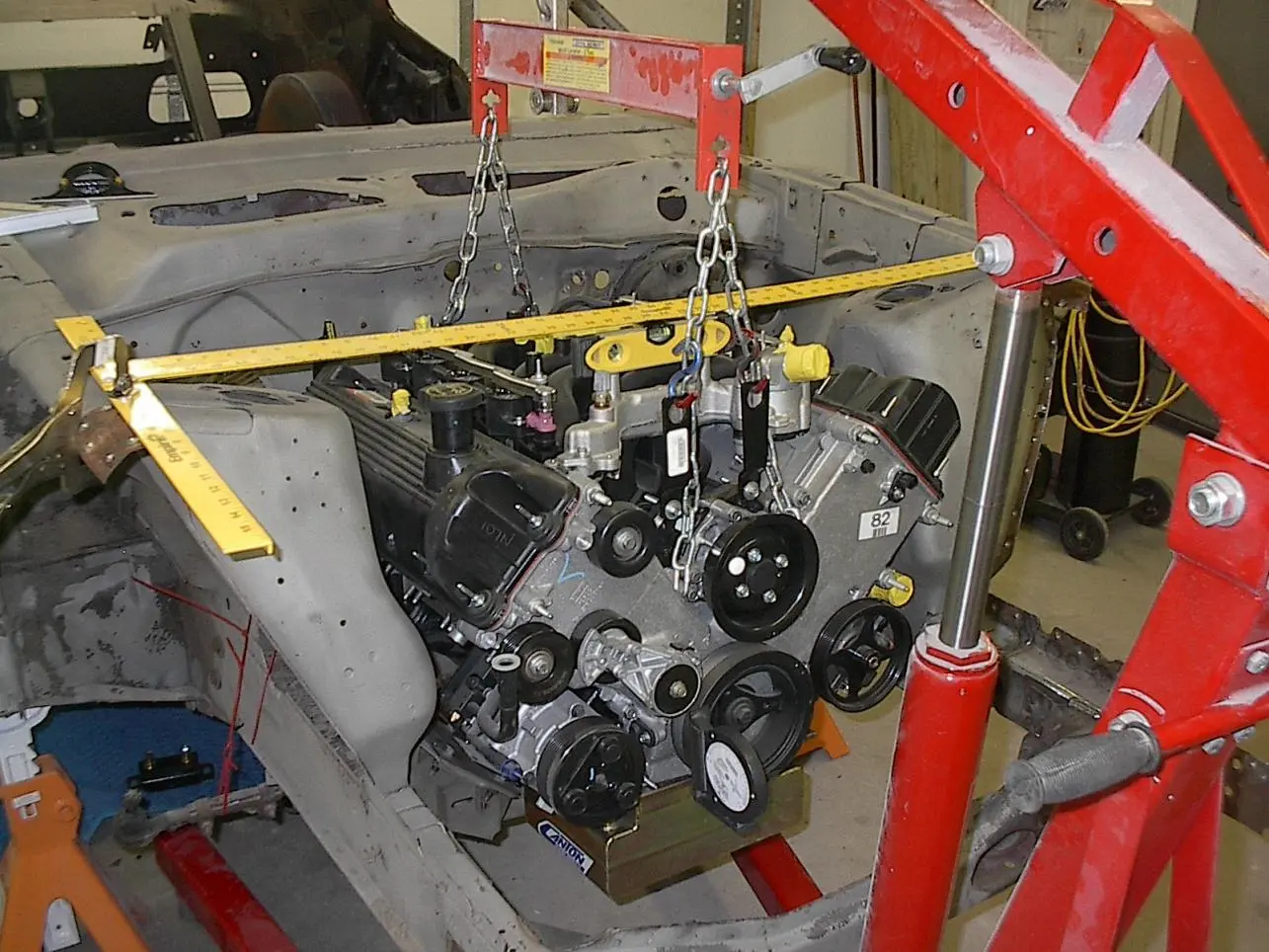

hello everyone! Been a while since I've been on here. I finally finished the install of Ridetech rear 4 link airbar setup. A few minor modifications and it fell into place nicely. The 4.6 2v Mod motor fits like a glove with plenty of room to spare. I have the motor tucked back and up for ground clearance. Being that its sitting much higher now,I will have to raise the driveshaft tunnel an inch or so to clear new larger aluminum driveshaft and the brackets for the console/lever style ebrake(from an 04 mustang) The stock brake booster is retained,will need to use explorer style master cylinder because brake lines will need to exit on drivers side to avoid valve cover. The stock exhaust manifold fit perfectly on passenger side but,drivers side just touches the steering box. So,right now,I'm looking at either building some custom headers or building my own rack and pinion setup to work to allow more room. I want to go with TCP front suspension with shockwaves and that is next on the list aswell as finishing my exhaust system. I'll keep pics posted as I go along. should have my site up and running soon.
