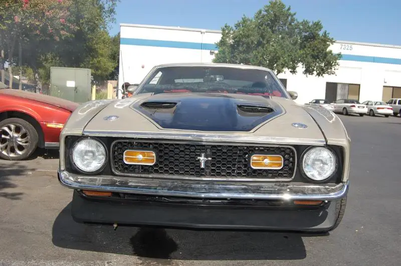

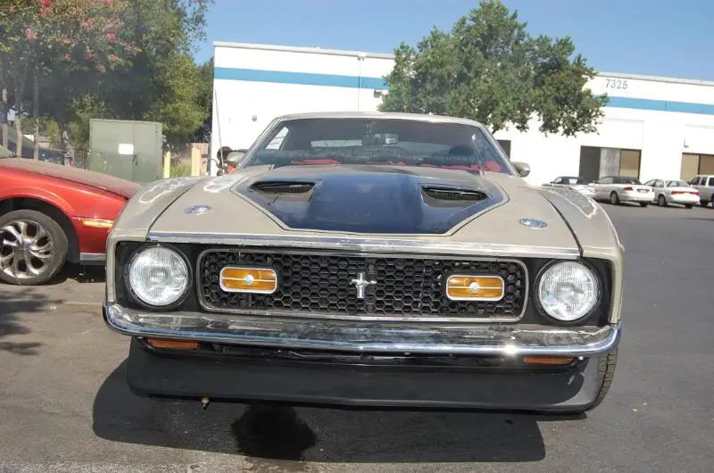

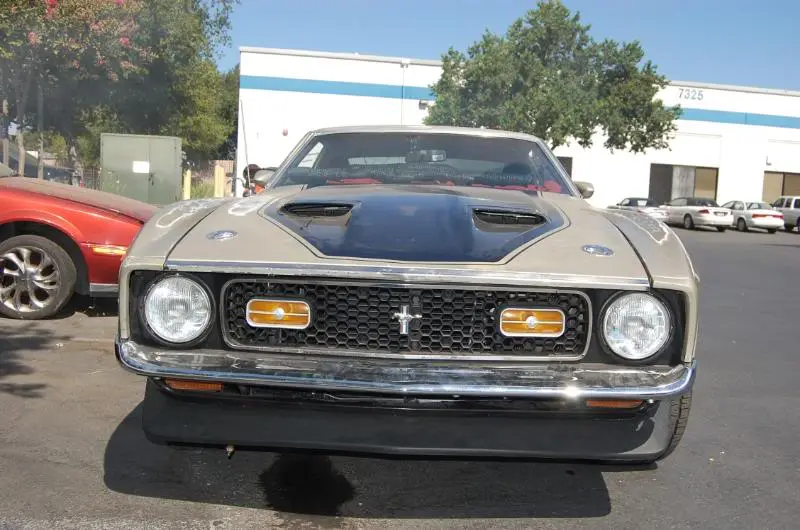

Right now this is the best pic I have. The car is presently in the process of getting painted, once I have it back I'll take more pics and post them.

Looks straight on. Did you use a 71-2 Latch or did you cut through the grill to permit the 73 Latch to work?
And what about the bumper mounting brackets? - they're completely different between 71-2 and 73.

I did use a '71 hood latch. I also used the '73 bumper mounting brackets. From what I've read, and in experience, they are the same '71-'73.

Nope, sorry, that's just plain wrong. All 73's use a different mounting bracket as shown in my pics here: 73-Inner-Bumper-Bkt.htm
71-2 Mounting brackets have horizontal mounting holes that line up with the horizontal reinforcement plate.
73 Mounting brackets have vertical mounting holes that line up with the vertical holes on the Bumper Support channel.
Maybe someone started the conversion on your car prior to you purchasing it - highly probable since urethane bumpers aren't available as repros.
Did your car have a 73 Urethane bumper when you purchased it?

My car came with the complete '73 front end including the 100lb urethane front bumper. I also did the complete front end conversion myself.
Well your 73 Urethane bumper certainly wasn't mounted with 71-2 mounting brackets. And your current 71-2 bumper could only be mounted to 73 mounting brackets with some serious (unrealistic) modifications. The only thing I can figure is maybe your chassis is actually 71-2 :shrug:
I do know for a fact the car is a '73 by the vin. When I get the car back from paint I will take some detailed pics of the brackets and post them up.
