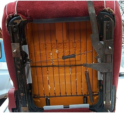

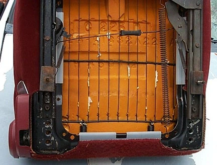

Here's some pics of some '87-'93 Fox seats on the original seat brackets.

Just to say the seats will fit fine when swaping out the seat tracks. They feel great and will work great. The bad part is that it's costly to reuphoslster them even if you do it yourself. I believe each seat foam cost $180, the Front uphosltery set was $230, good hog ring pliers was $15, Small 'bolt' cutters $15, and a bag of hog rings $5 (from a local fabric shop, it was about 60% less than the parts venders and i got more hog rings). But once you recover the seats you won't be disappointed. I love how they feel, support, and cushion.
