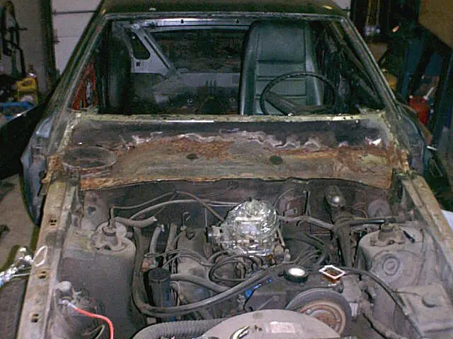

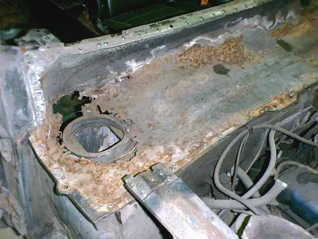

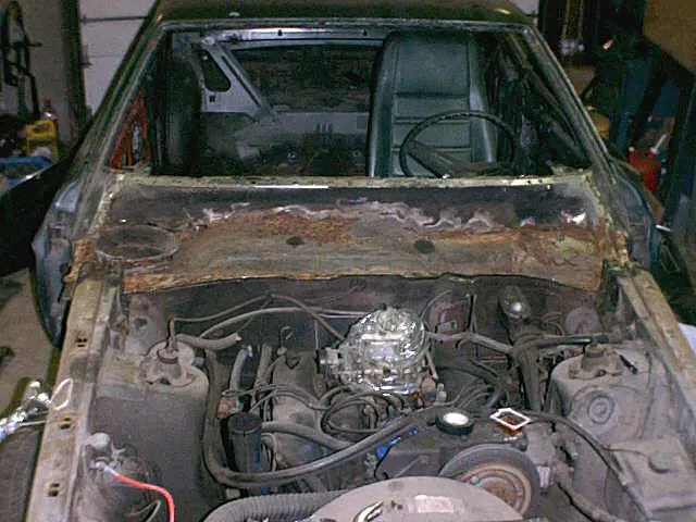

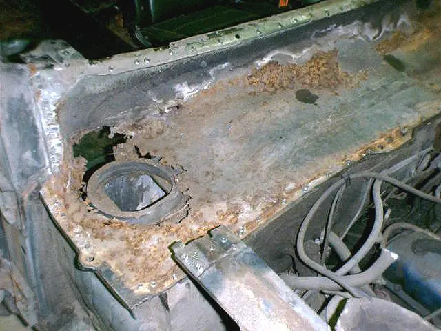

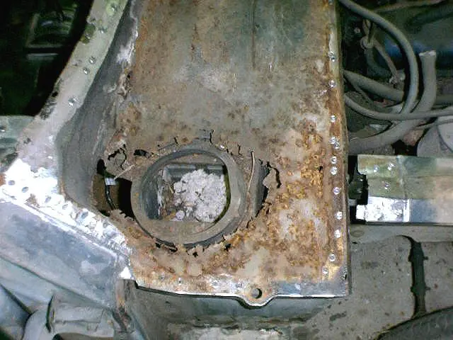

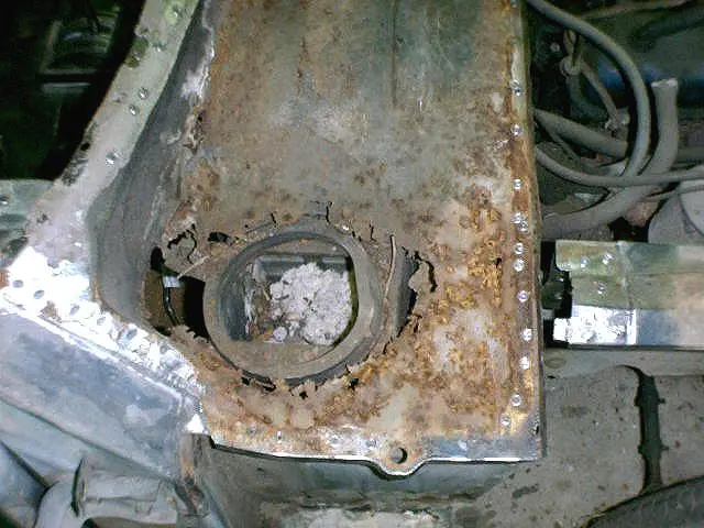

When you do go look at the car, pop the hood and remove the two plastic snap-in cowl covers at the base of the windsheild. Shine a flashlight in there, or better yet reach your arm in towards the passenger side and feel for rust. There is a hat shaped chimney (approx. 7in in dia.) in there that provides air flow to the heater. If that area is rotted out, you're looking at a difficult repair with no aftermarket parts available to help you. Here's a couple pics to give you an idea of how bad this area can get. (Note: the top cowl sheetmetal has been removed in these pictures.)
