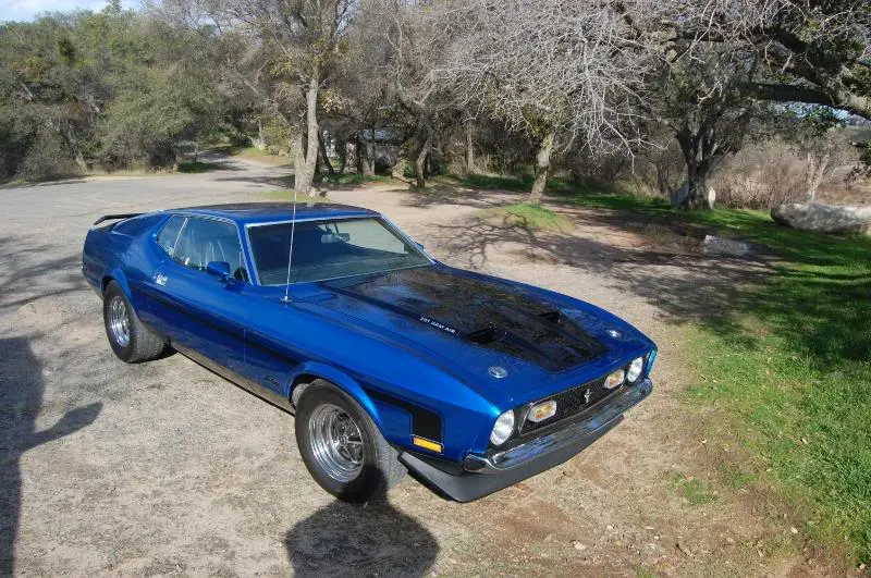

Here's my '73 in blue/black, I like the combo. What color is your car painted and what color are the stripes, I like the combo, gives you car a sinister look. And it will really be bad-ass when you get done.

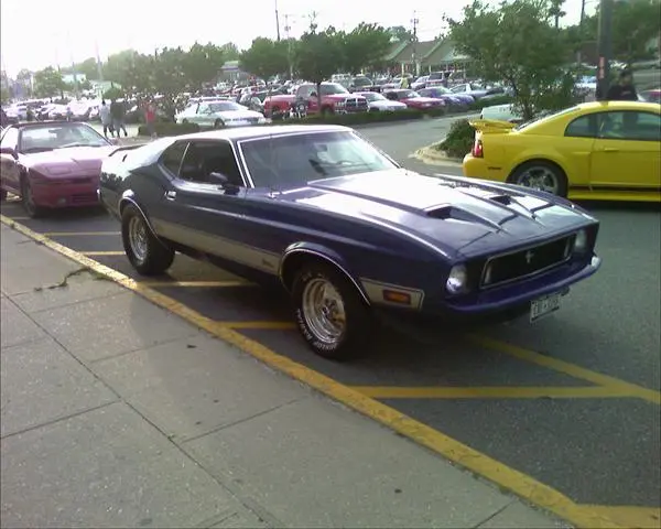

This is how the car used to look.. Blue with argent stripes. The last owner must have done a cheap paintjob, the paint started to peel and rust was forming underneath. It'll get another paint job after I'm satisfied with driving it lol.
