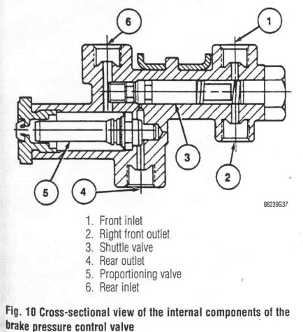

Scratch that idea. Took off the drivers line the M/C and the prop valve and it's not another port. theres a spring in there. Now I will be buying the Tee you linked to me. I'm hoping I can get one fast since now the car is down.
Well I found an even better solution to the problem.
In the link you gave me they used a "T" and an adapter, at the Front Passenger Port, splitting the pressure on the front brakes, which defeats the design of the non adjustable prop valve since the front Driver was going directly into the Master Cylinder. I found an internal diagram and Tech info on the prop valve (I'll give it a try attaching the diagram.)
The solution I found was from these guys - http://www.maximummotorsports.com/svo.asp = Supplied by "mineralgsvt" on this thread - http://forums.stangnet.com/showthread.php?t=528935
How they do it is add the "T", adapter and short brake line to the Rear Port of the M/C, the Front Driver is getting direct pressure just like before from the M/C just in a different location, then into the rear port of the Prop Valve. The 2 original lines going into the prop valve stay the same, thus the pressure is still the same as the original.
It cost me $45+ US with shipping, i already got an email stating they have recieved order and are mailing it monday morning, we'll see how their design does and the quality of their parts when it arrives. I'll post the installation when I do it.
