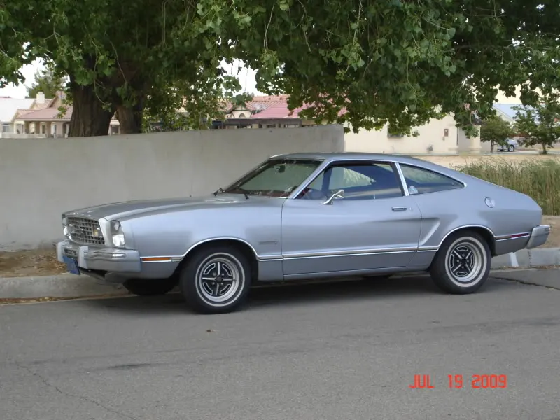

Wow! That's a beauty! Looks like all you need are some center caps for your wheels and speaker grills and its ready for showing!
Thanks!! I did get some center caps from ebay and put them on. However, one is a little flimsy and I'm afraid to lose it if I hit a bump on the road or something.
Yea, I don't have the speaker grills but I do have the carpet pieces that were cut out to install the speakers.
