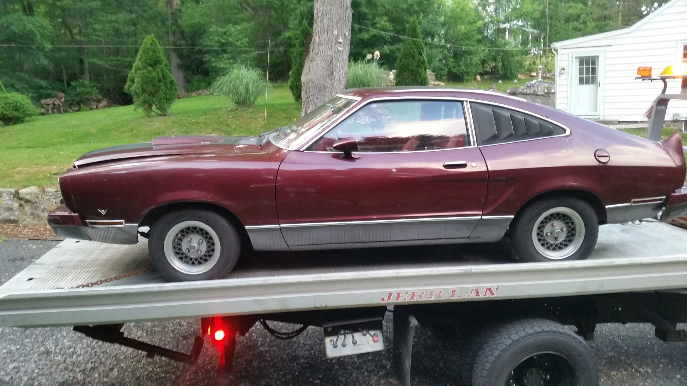

Hi, 1977 Mustang ll Mach 1 V8 project. I picked it up from a guy who was running out of space for all his project cars! Now its my head ache! 'lol' once I fix these its off to paint.
