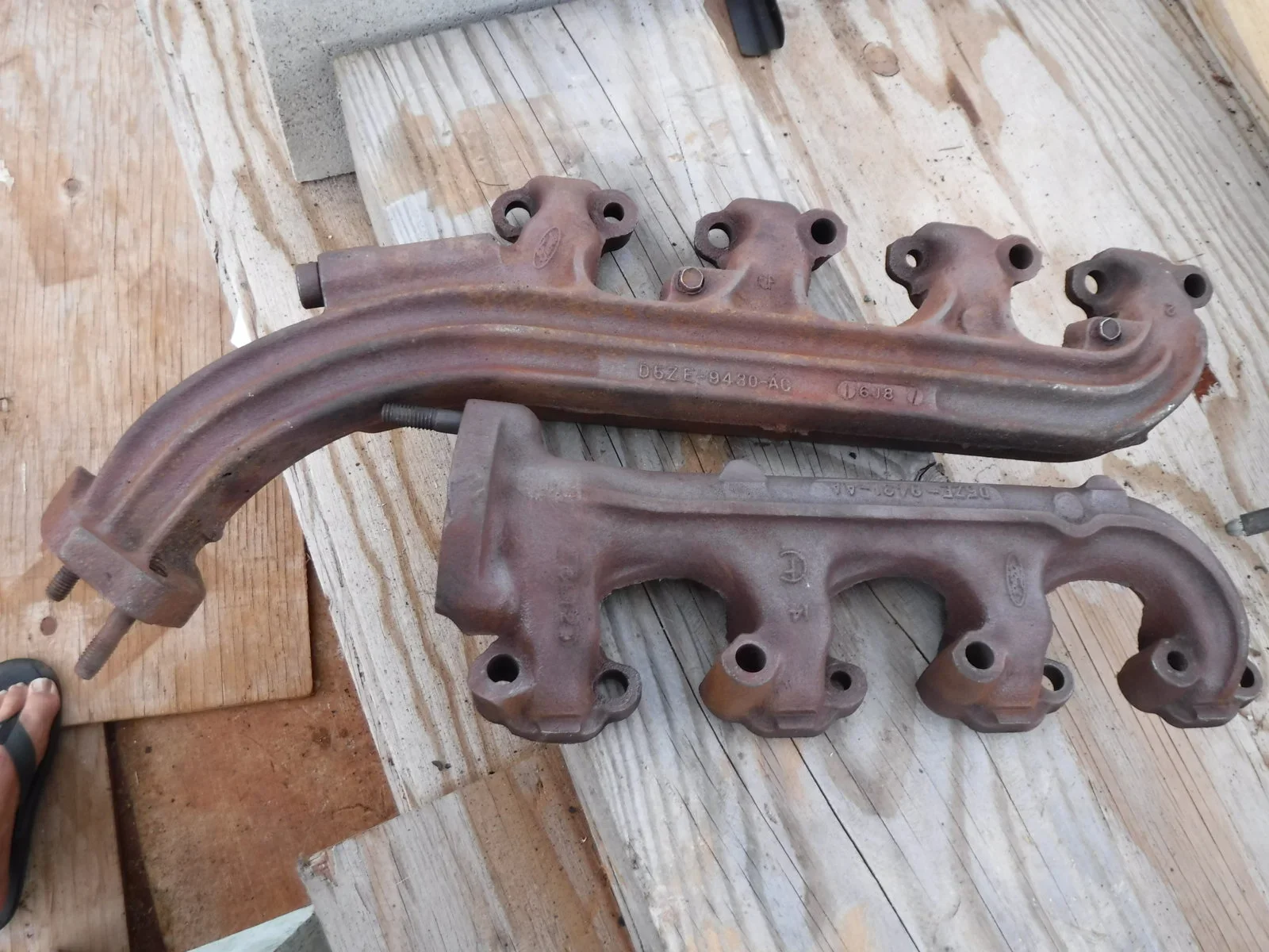

Heres my '77 302 V8 ones
and factory Y - pipe

Dang it. I was hoping mine would get 3 more inches

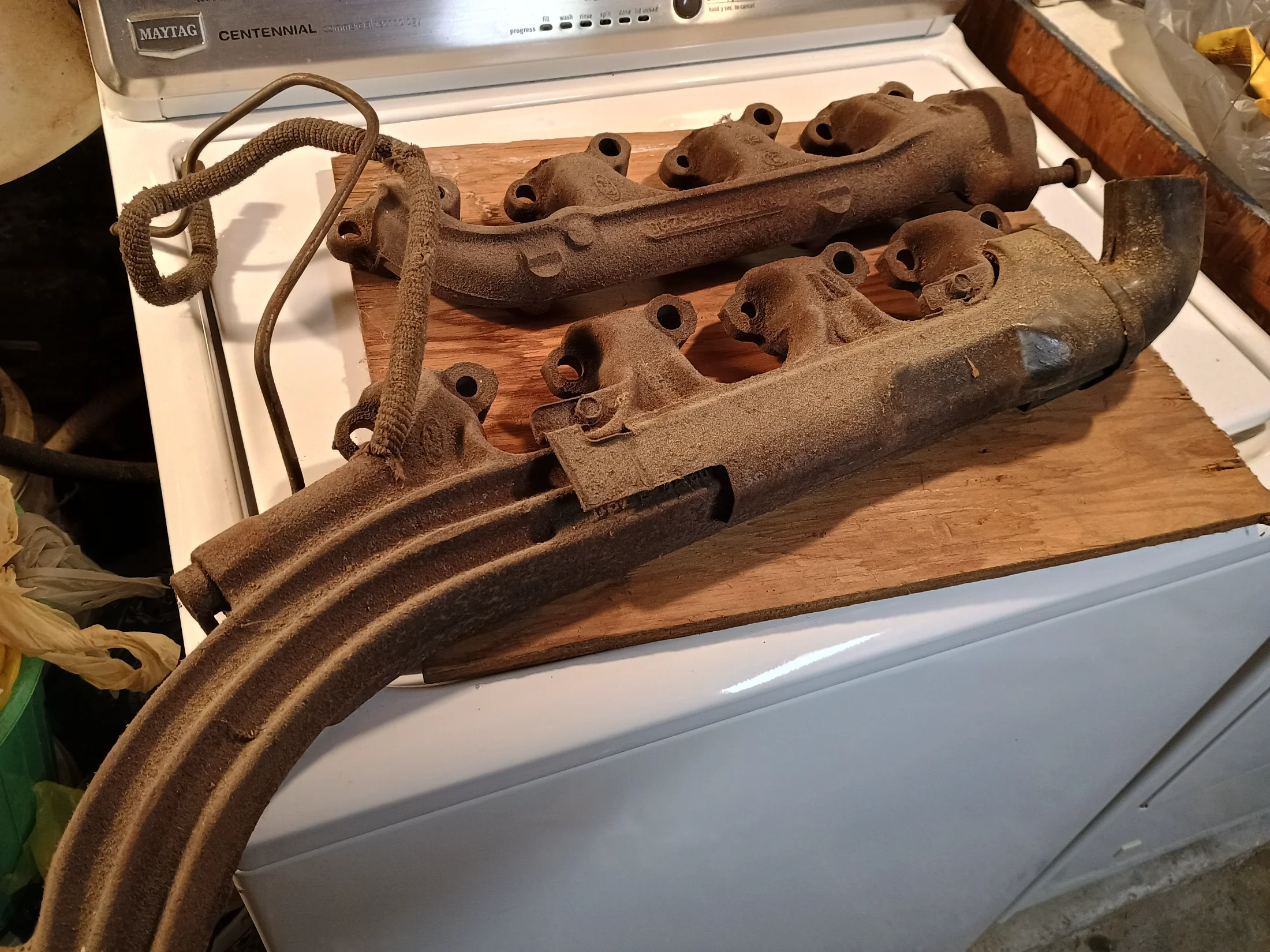

Texas275 said:
Thank you for the part numbers Welder4956!!!
You're welcome. However, looking at 2Blue2's photo above it appears the correct numbers are D5ZE-9430-AC for right side and D5ZE-9431-AA for left side. The crash guide part numbers were D5ZZ instead of D5ZE. I would go with the D5ZE part numbers.
