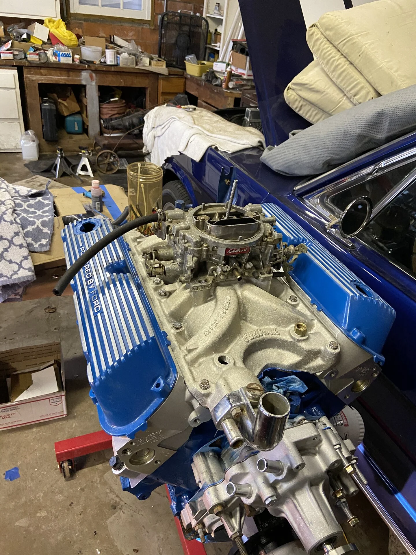

Update , picked up engine and have it home . Short block back together. Will have to wait on head till I can come up with more cash .
But the engine they bored out to .060 over . New pistons and rings . Polished the crank and now new main and rod bearings. Put in a high volume oil pump with new pick up . Cam in and timed . That is where we are now . Anyone have advice on heads ? Need at least 550 lift .
Thanks
I have most of the engine back together now . Just have a few things to go . Money kind of dried up so things are going slow . New question I have a C6 transmission for it but don’t think I will trust what the P.O. told me since the engine was a wreck . So can anyone tell me what is a good rebuild kit and shift kit set up for it ? Also where to get it . I am thinking on doing the rebuild on the trans myself . At least I will know what has been put in it . Thanks in advance .

The engine is a 351 Windsor not the 302 . I would like to stick with the C4 but I have the C 6 . I would trade it with someone if I can find one with in a reasonable distance . I am just trying to work with what I have and get it back on the road .
