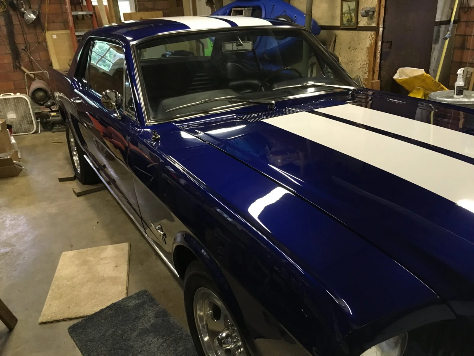

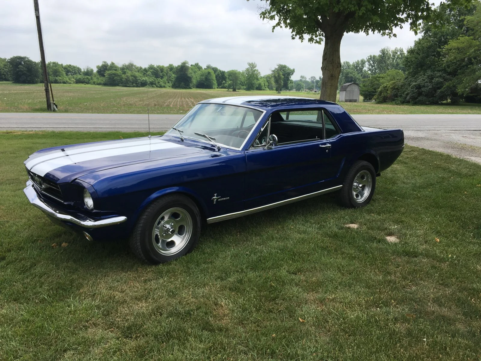

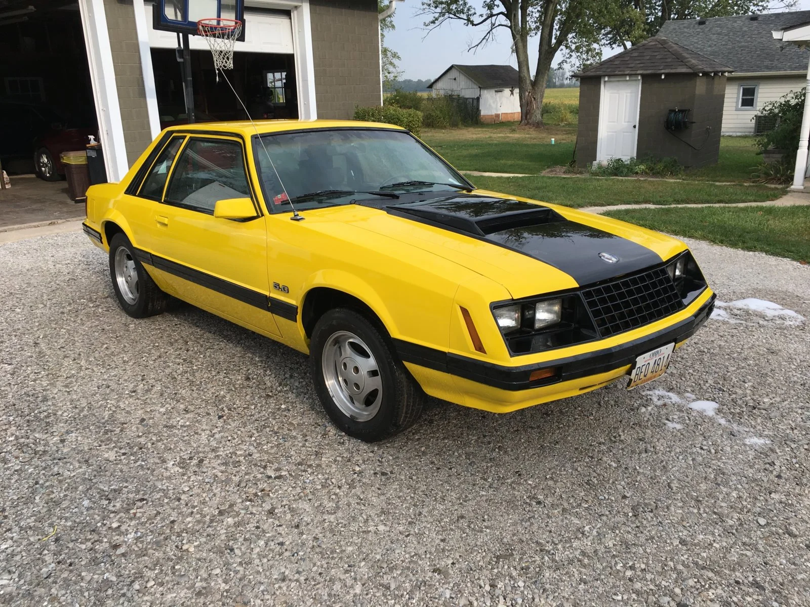

Here are a couple pictures of the 65 .down to getting a lot of wiring finished up. Also one of the 79 View attachment 636451 View attachment 636452 CA24B93A-E8C0-4236-BFEE-AE43EF26D59C.webp C077F9F6-F5EB-41C8-A193-CEF6CA64B2F2.webp 294E238E-FA8F-4CE0-B910-0FB6D6DC4A1A.webp
Nice! The 65 and the 79! I really do like the 79, color and it's a notch.....very cool!
I think I want to extend the black stripe all the way back and down in the front . I think it looks a weird with just the hood . The yellow does need a few touch ups also. Here is a better picture of the 65 , the shine is better then the pictures show . Too bad it’s just a 200 in it . 9638220D-1741-43E4-A48B-B4B6CA238A4E.webp

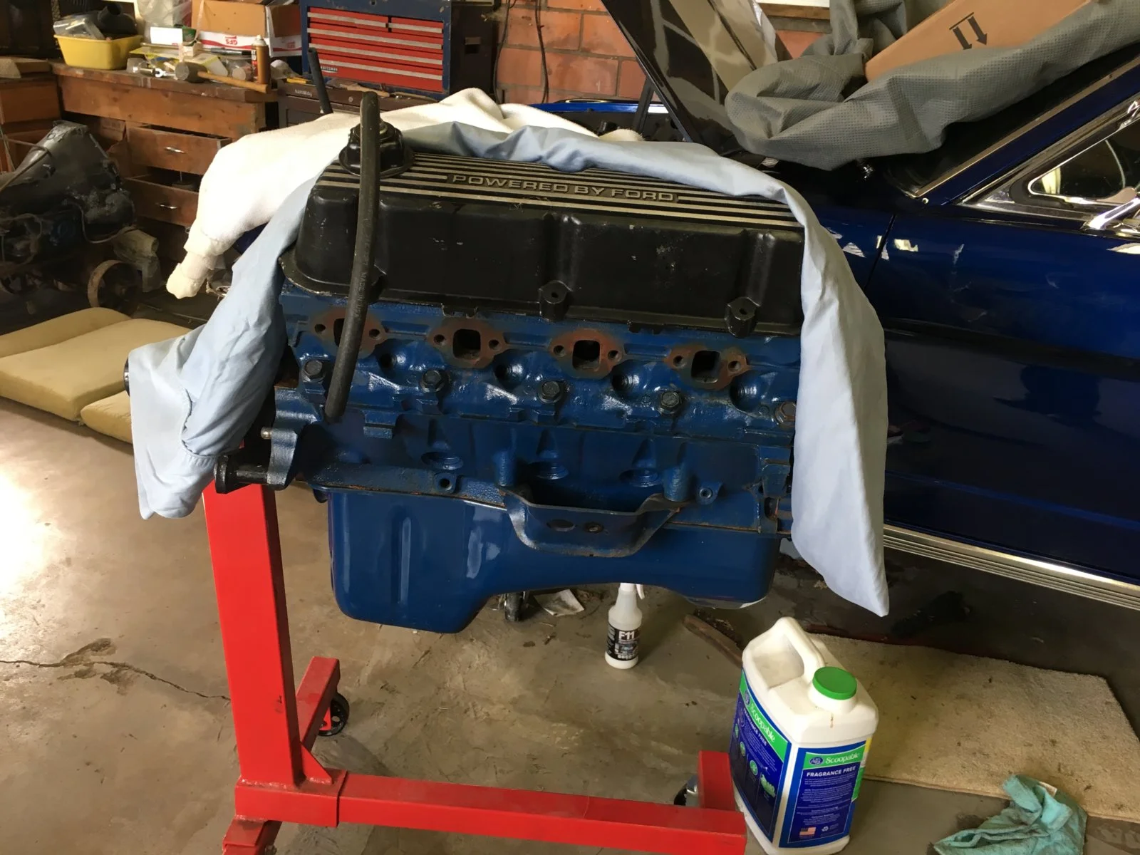

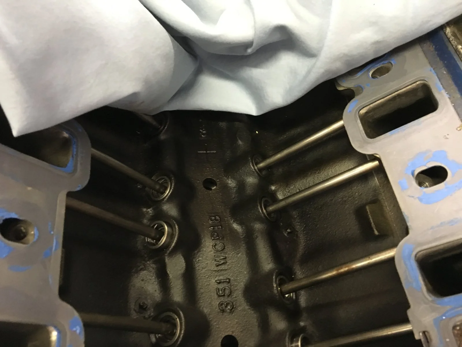

Pulled engine today . Found torque converter was just set in place . Not bolted in . Engine looks real clean . Will pull heads tomorrow when I get back to it .i did pull the intake and very clean in side so far . But dry . Not oiled up at all . Looks like it’s been sitting for quite a while . AB0D31FF-E4AA-4D34-94D2-13A050D8B08E.webp B3211E6A-6FB3-4A73-A186-700E8ACFB51B.webp

I talked to a radiator shop near me and he said I would be money ahead to just buy a new 3 row aluminum and put in it . I did get it pulled and it has started to break free . I am going to break it all down and clean it all up and put it back together. I have found a few things that make me think the previous owner did not do it right .
