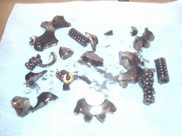

I actually broke mine! Here is a pic of some carnage. :D I completly wore out another to the point where the axle's moved a half inch in and out. :nice: I now have a 8.8 disc in there with no more problems. I do race mine though.
