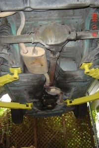

got a question for you smart guys out there, when was stand blasting the rear end that big weight thing on the bottom of the diff, i took it off, whats is that even for, doesnt seem liek its functional or anything, not sure if it was to balance it or summin, heres a pic of what im talkin about....
Its the thing thats resting on the ground underneith the entire rear end........
Do i need to put it back on, i reall dont wanna screw nuttin up by not using it, what do yall think?
