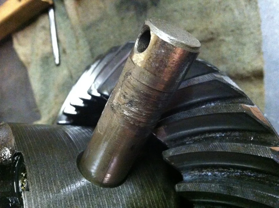

Anyone ever seen this sort of damage? Not sure what caused this other than possibly the wrong fluid. Anybody have any input. I'm new to the 8.8's and Trac Loks. Thanks for any input

Wear, time, abuse. If you think about what that pin actually does it gets alot of stress put on it. If there are no shavings in the bottom of the housing and the slot were the pin goes looks ok get a new pin and retaining bolt and put it back together.

Was the green lock bolt still there? If it backed out, that could have caused it too.

Bolt was in there tight.

Sounds like the bolt was in there tight, but broken. The axles only spin against two, opposite sides of the pin, not all the way around it.

Are we talking about the same bolt? If you are refering to the bolt that goes through the end of the pin, then it was undamaged.
