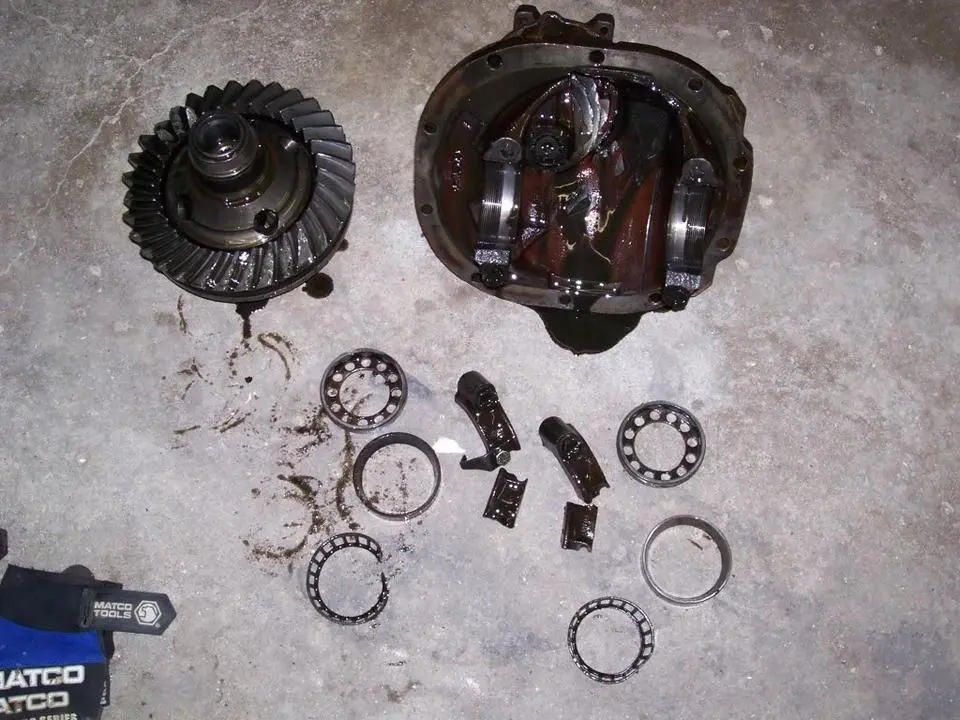

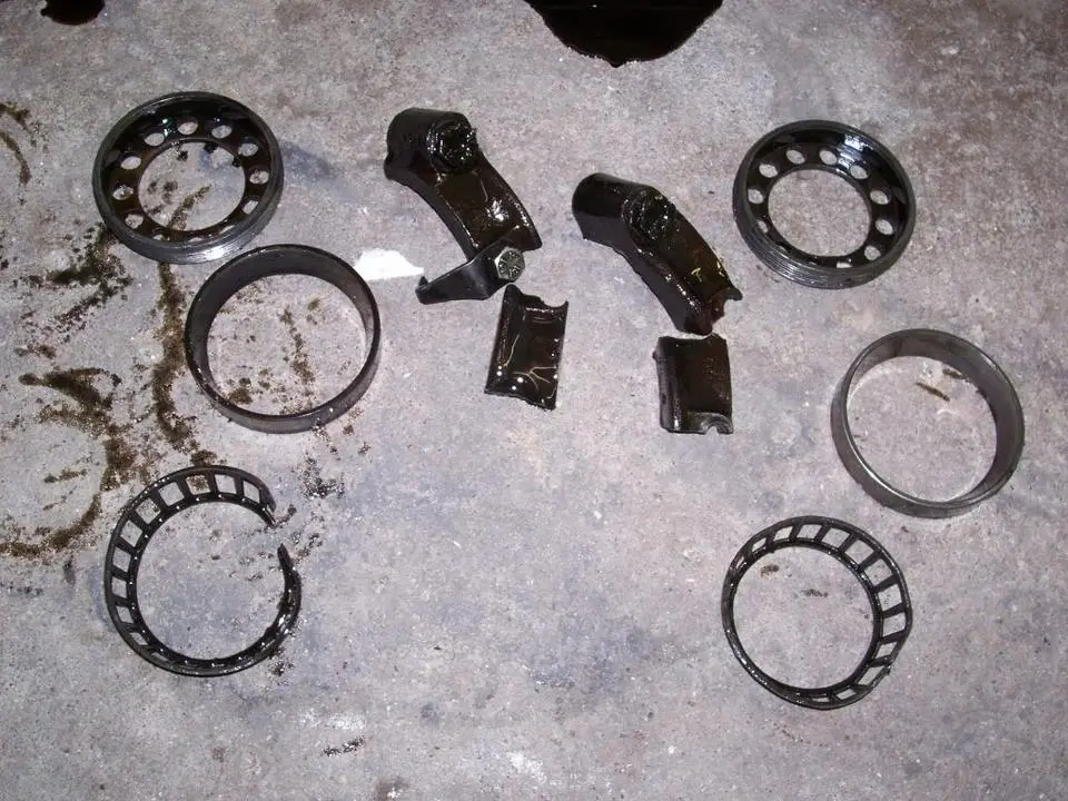

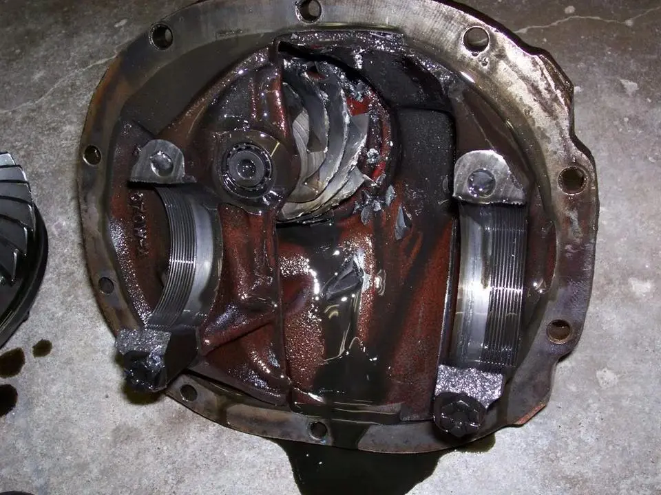

I broke the bearing cap bolts off of the stock 8" in mine. It was on 17" street tires. I never had wheel hop untill I put the 17s on it. The very first time I side stepped the clutch with those wheels it hopped and snaped the rear end. I went to the 9" cause it has bigger bolts. here are some pics of the failed 8".

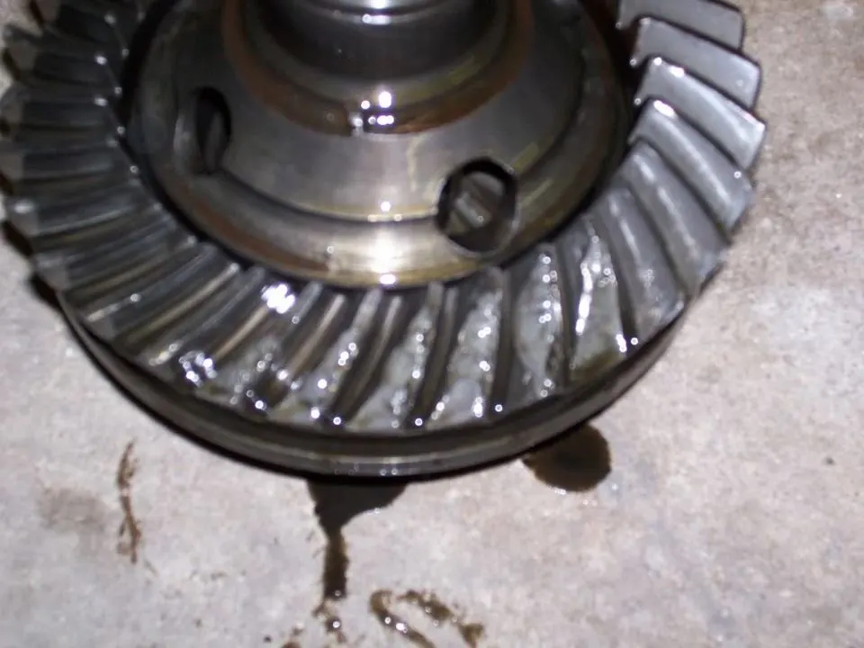

Got it all apart, and think I had lost a couple bolts that hols the pinion in. BTW, tooth gone from ring gear, so I can't swap gears. Did get it back together last night with my spare diff with 2.79 gears. Oh yeah, I also broke my 3.5" plastic fan shroud. What a night.
