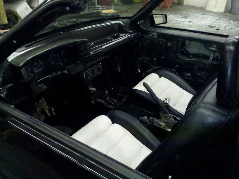

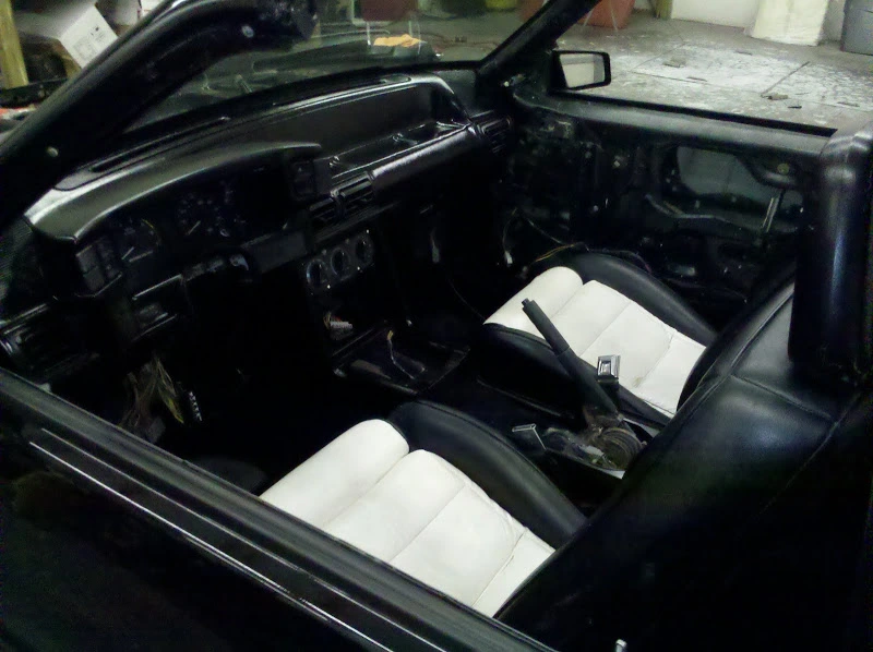

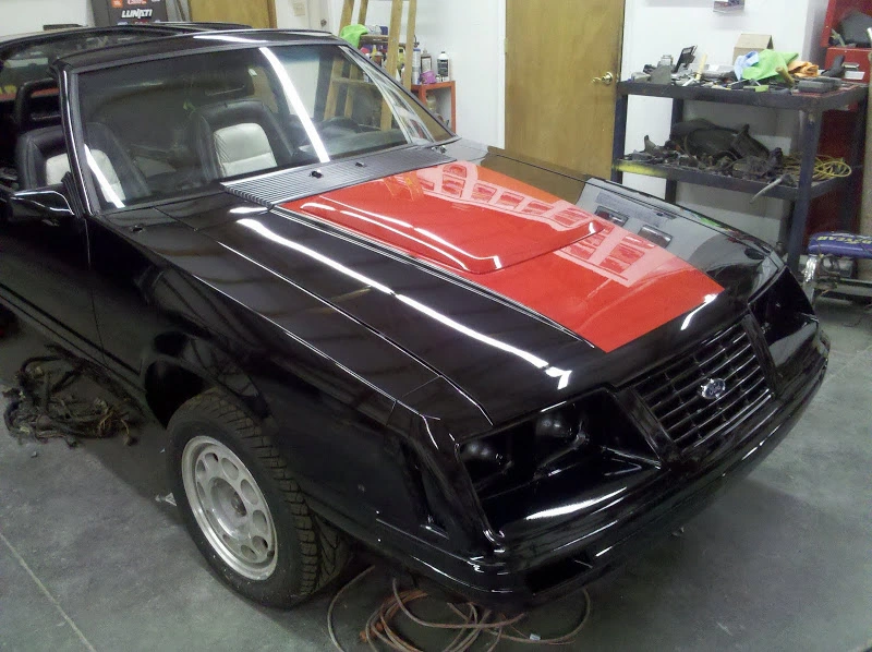

Thank for the advice guys, I got the swap completed and it really wasn't that hard at all!
Idk how well you can see this pic, i'll take more when I get it moved outside shortly:
Fresh out of the booth:
The Powa:

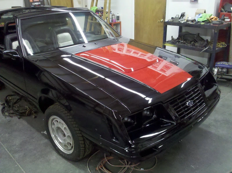

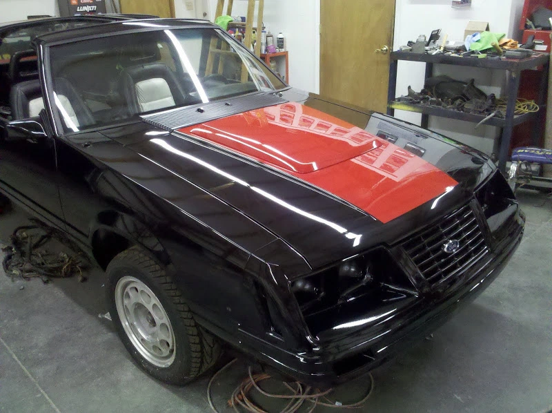

Did you put a different front end on that '82? The grill looks like it's from an 83 or '84. Mine has 3 horizontal "bars" going across for the grill....it's not mesh like the one shown here. Just curious but I like that swap you just did. You should write up a tech article on how it's done and what all is involved with that swap. I surely would be interested in reading something like that!

No sir, you are absolutely correct on the year. When I started this thread, I wasn't aware of the '82-'83 year break, and my car is in fact an '83. :hail2:

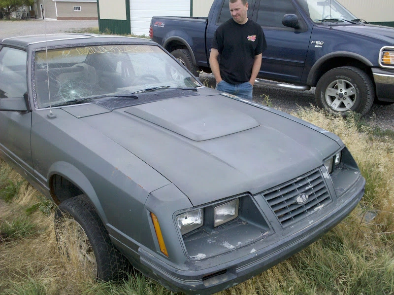

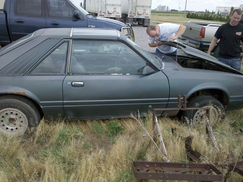

And, as far as the swap, the entire process from when I pulled the car from a field in Western KS:

But, unfortunately as far as the dash swap, I didn't get much info on a complete how to. However, it was very easy to physically install. Being as i'm using none of the Ford injection stuff, most of the wiring was easy as I just had to graft the '88 front lighting harness to the '83 Nose harness. The rear tail lamps and everything else worked fine as-is. However, I did have to take the donor car's heater box as well for it to work.

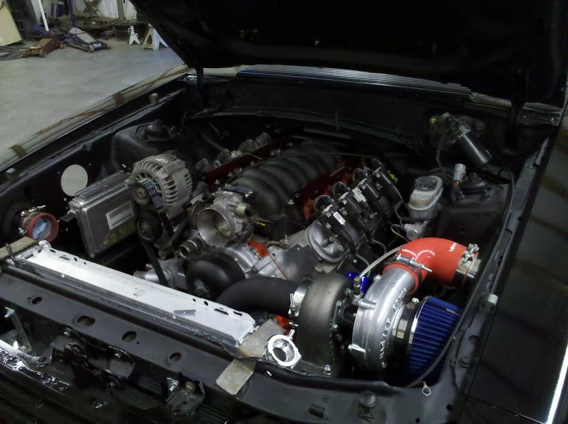

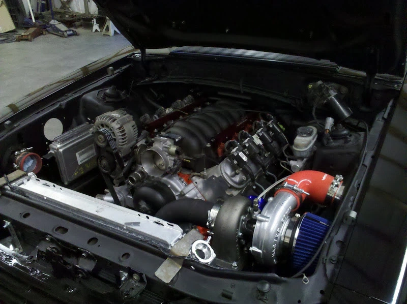

More tuning tonight. This setup should make around 15psi peak. This video is just a neutral revv to the 5K limiter. Makes around 4-5 psi, I was just checking the turbo out and setting up the BOV:
