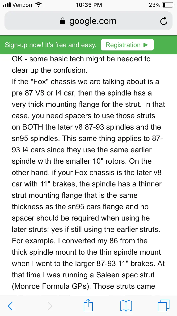

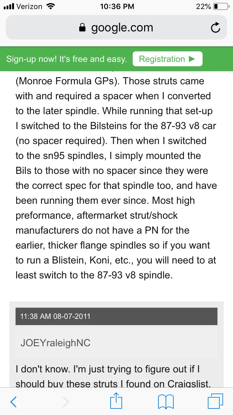

I havnt figured this out for sure or not, but i think our older foxes going with 94/95 spindles either need to use a spacer, or get 87 and up struts. I believe the older spindles are thicker at the strut mount (unless I have this backwards... someone please correct me)
I’ve been paying attention to everything I could find before I started this project, and it is my understanding that the struts should be 95 because of higher mounts on the strut,
Or visa versa.
Or visa versa.
I found this on another forum with regards to struts: (screenshots of the pertinent post)
Alright then
Thank you for going to all that trouble.
No problem. I’m in the middle of collecting parts for a 5 lug swap on my 86. I feel like every time I start researching, I learn something new.
This is a great resource with everyone helping each other out!!!
Or visa versa.
No if you have a pre 87 car you just need 87-93 v8 struts
