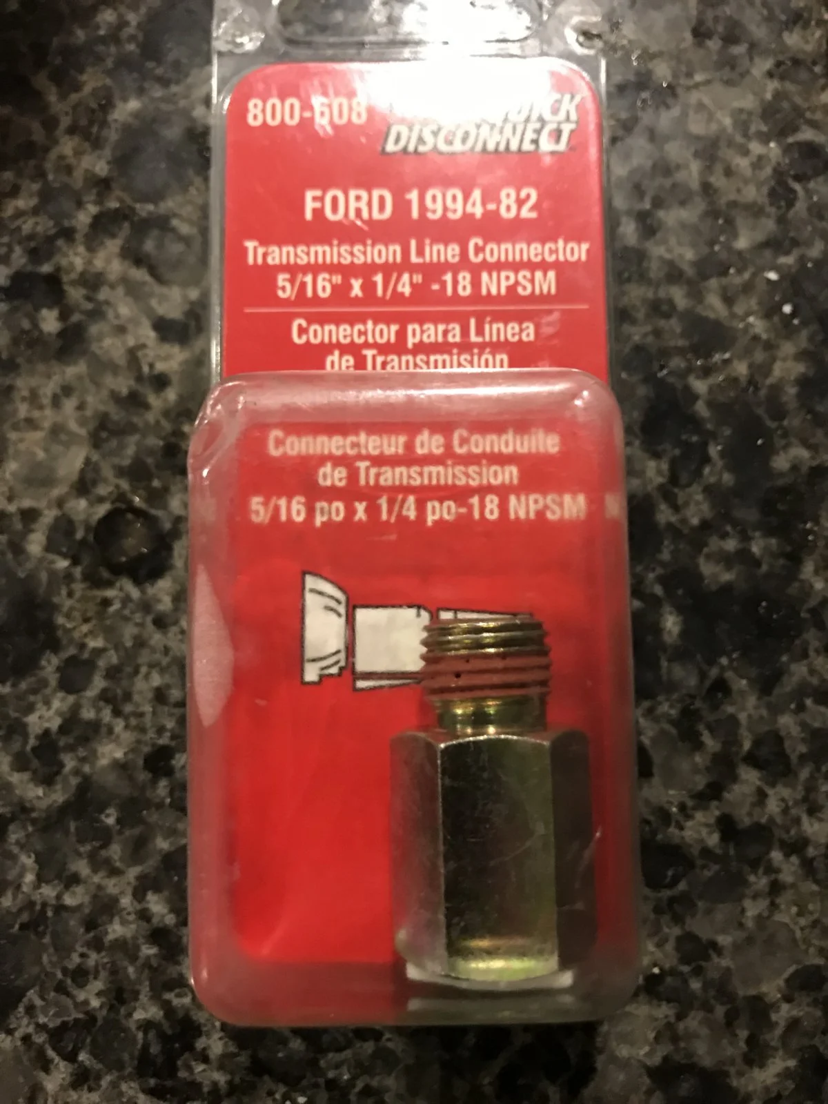

It has Dorbon (sp) fittings at the transmission .
Sorta like Shark Tooth fittings for water lines.
Called around, and of all places O’ Reilly’s said they would have them tomorrow. :)

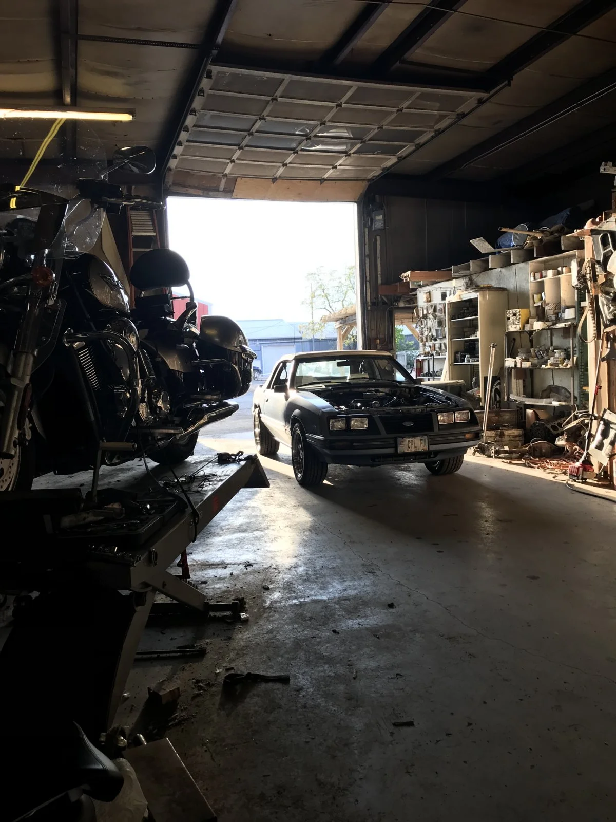

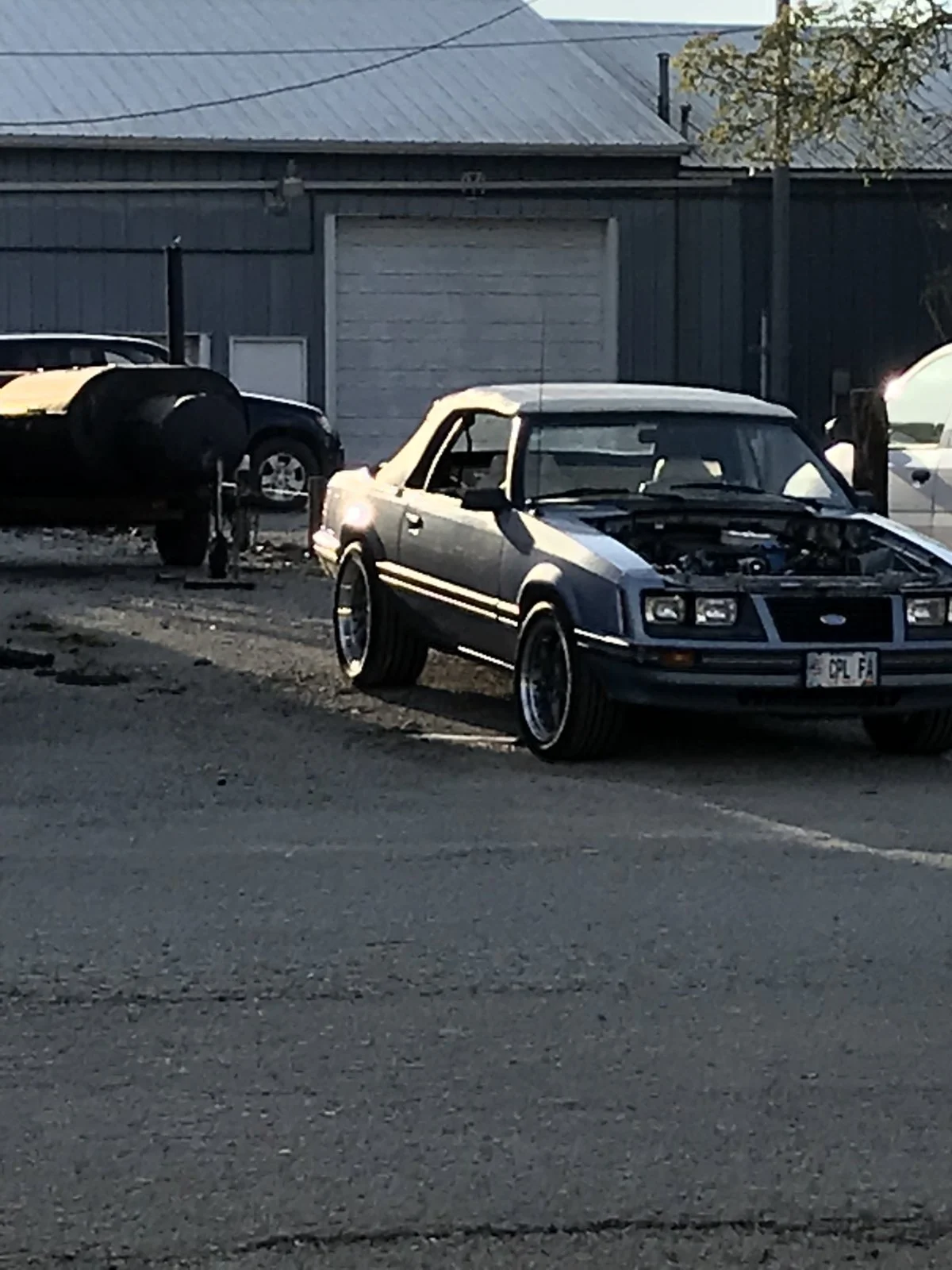

Looks kinda bada$$ in that first pic. Hood off, just waitin to go!!! Those wheels/tires and the stance look perfect too!!

Transmission cooling line fitting came in today.
Took the tool they sold me to release the tube from the fitting.
Wouldn’t budge.
Sweated under the car for about 15 minutes— wouldn’t release.
Finally go down to Ford to borrow their tool.
Said the tool I had was right, just fight it some more.
RamJet finally came over to see why I was cussing.
He looked at the new fitting, then looked at the old fitting.
“Hell its just plastic in there”
Told me to get the vise grips and hold the fitting.
Lit up the torch and melted it right out.
Sprayed the tube down with water,
Inserted into the fitting —wrenched it in—no more leaks:)
