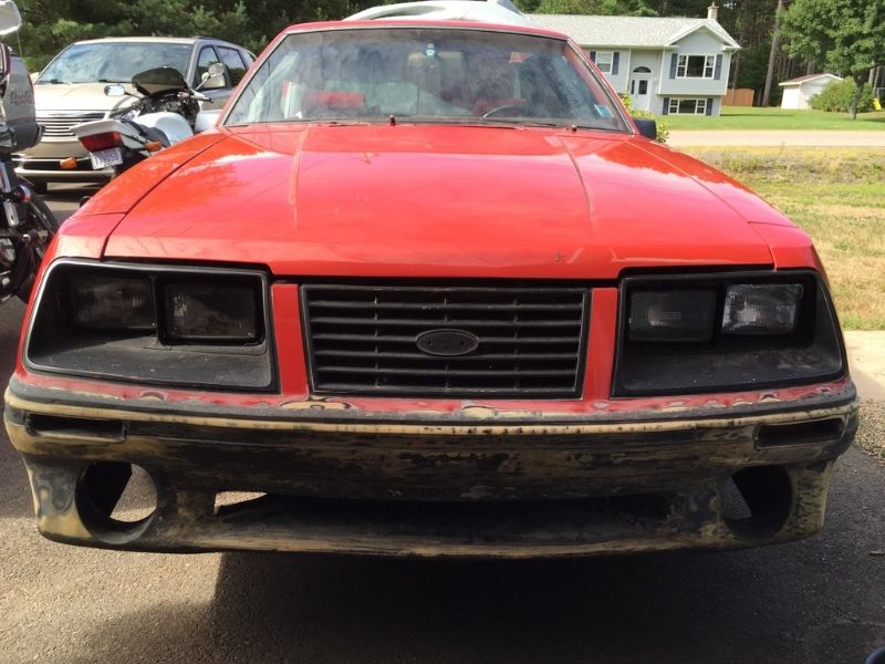

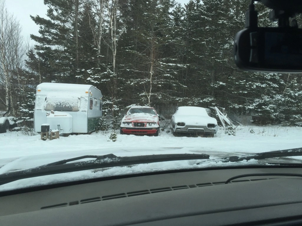

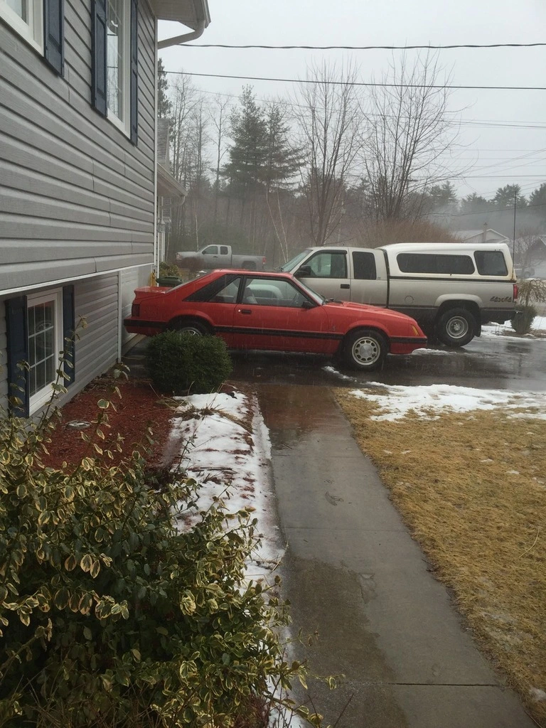

Coming home after being stored in a friends field for about 5 years:
That's my old 62 TBird beside it. Sold it off earlier this year since new house didn't have the space to keep both. The TBird went because it had terminal rust. A guy bought it for the parts.

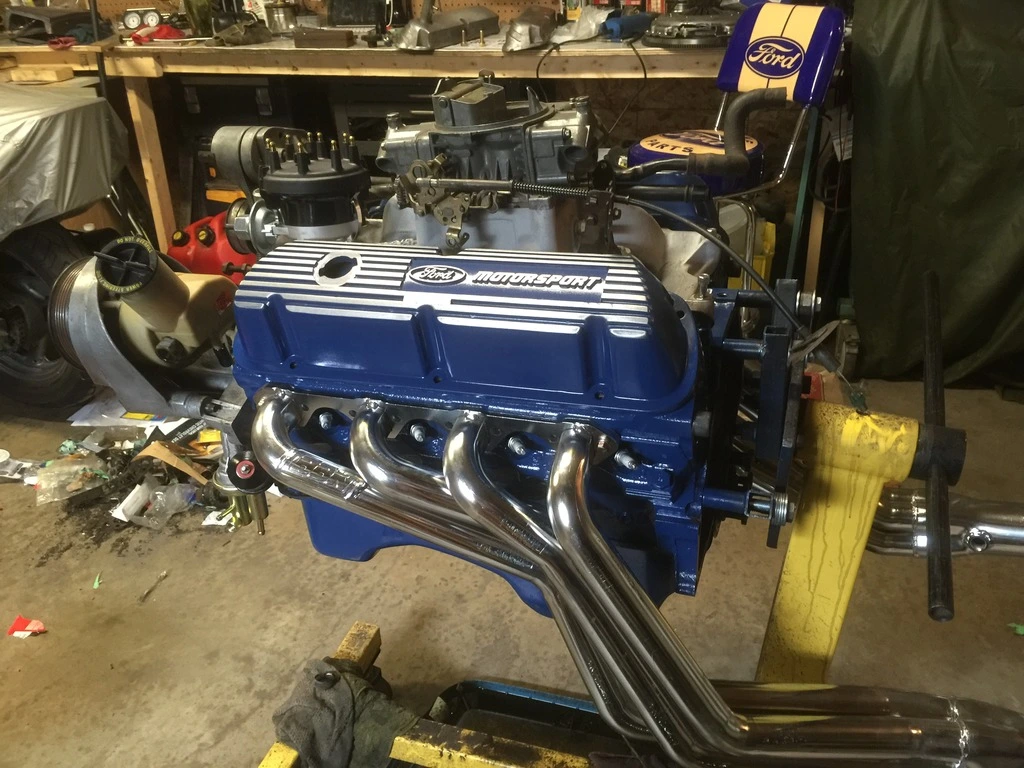

89 roller block, edlebrock Performer RPM air gap, holley 750, bbk longtubes and a few other bits and pieces:

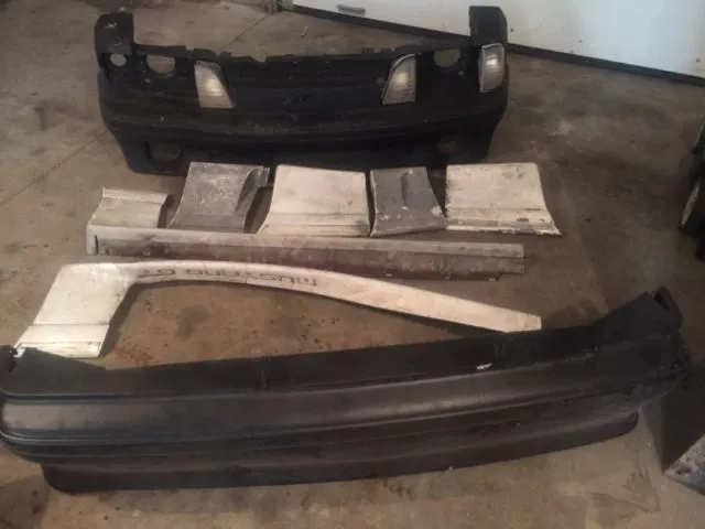

picked up some used body parts cheap:
grafting 87 lower on to 83 upper:

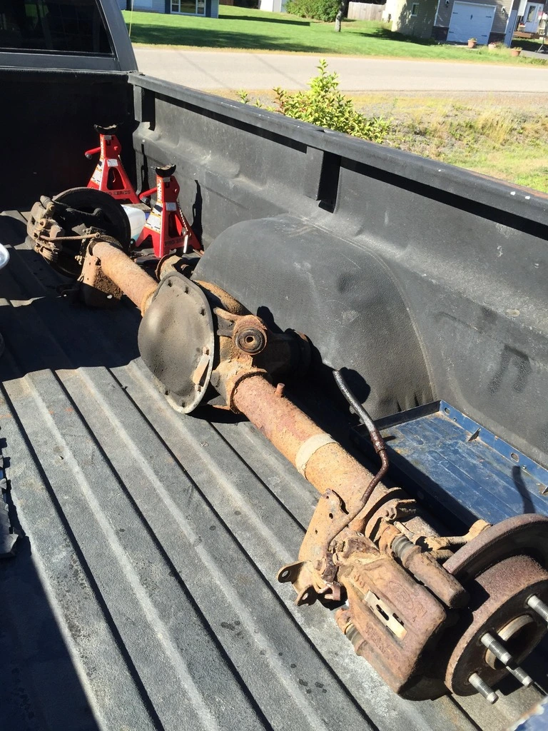

It's just a 7.5 from a 1996 SN95 V6.
8.8's are as rare as hen's teeth around these parts. anything in the scrap yard has long since been crushed and guys don't part out V8 mustangs around here. Any that are left are garage queens for the most part. I'm in Atlantic Canada and cars that are used year round are rust buckets within 5-10 years here.
The 7.5 will do until I run across an 8.8 for a decent price. Good thing is the axles and brakes will swap over from the 7.5 to the 8.8, so I can use either a fox 8.8 or an SN95. Whichever shows up for affordable money.

Welcome to Stangnet brother!
Neat car, I have an '83 myself.
That sucks about not being able to find an 8.8. Oh well, patience I guess....
Why the 750 carburetor? Seems a little big. I guess you might have some supporting mods that need that much air though.
I really like the front bumper splicing. @90sickfox did something similar.
Your mustang looks remarkably nice considering where you're from.
We have a number of fellas from the frozen north, @Gearbanger 101 is one. The last time a Canadian joined I joked with him how all you Canucks knew each other. Turns out that guy lived ten minutes from him, proving me right, of course!

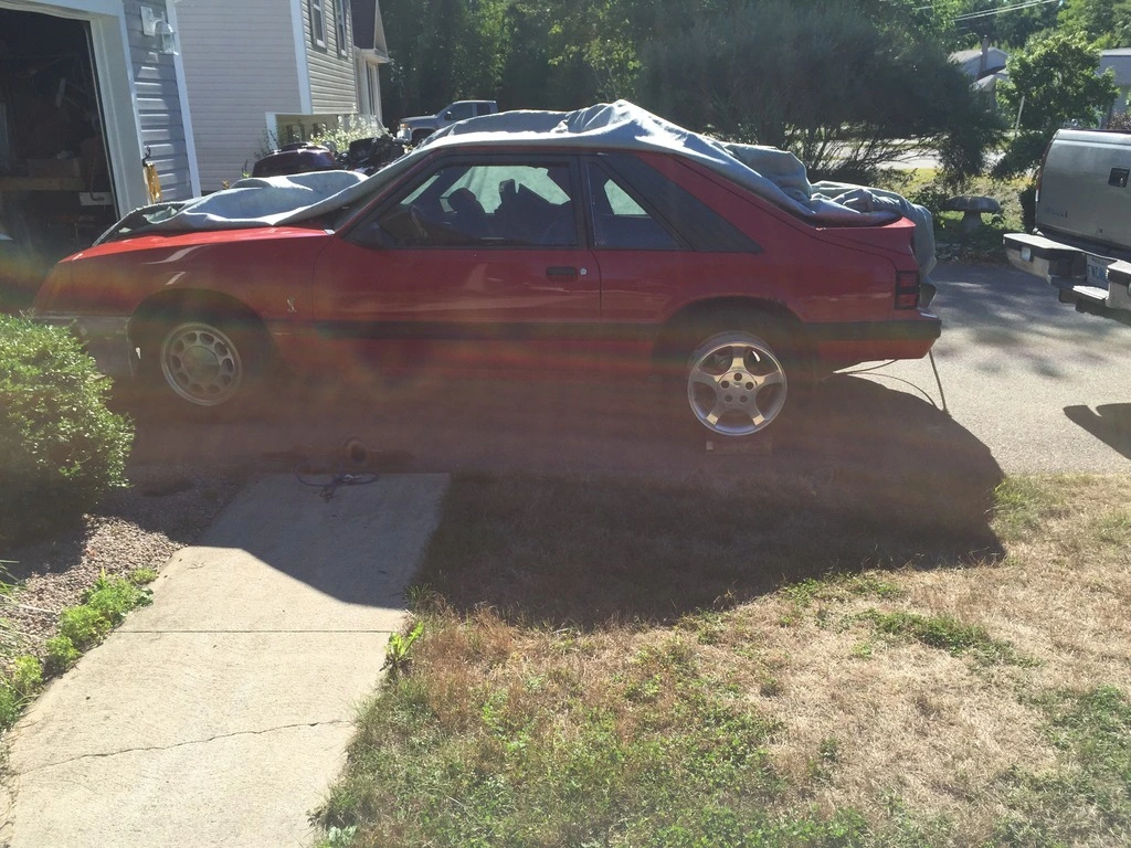

Wish I had the foresight to put a car cover on it or at least cover the cowl vent. Had clean original floors in it when I parked it....

Nice. Just my opinion but I prefer the stock bumper on that particular car.
G
great white
Sep 4, 2016
32
41
28
Sep 4, 2016
  • Sep 4, 2016
no worries. Everyone is entitled to their opinion.
At the end of the day, doesn't matter if someone else likes or dislikes it. Only one that matters that likes it is me.
Every car isn't for everybody.
With this front end arrangement, I have brake cooling ducts already built in. That's what the fog light holes will be re-purposed for to help with brake fade on autoslalom days. Was one of my reasons for going this way in the first place.
I always liked the 83 nose (85/6 is probabbly the best looking fox overall to my eye) but the lower always looked like the car had an "overbite". Always looked like it was missing something to me and I never liked any of the aftermarket lowers that fit those years. The funny overbite look is probably why you can't give away a nose for an 83/4, but 79-82 and 85 up disappear from Kijiji (IE: Canadian Craig's list) in a flash.
It's also a bit of a cost savings for me too, as the rub strips are part of the 87 GT side pieces, so I don't have to go looking for replacement 79-84 moldings. My originals are not just curled, they're split down the middle on the edges. Now, all I need to find is door strips instead of all of them and 87-93 strips are easy to come by (they're even re-popped if I want to spend a bit more)
Then there's always the "plus" of not running into the same one every 5th corner or looking like everyone else at a car show/run.
If it all goes to crap, I've got an 85 nose and fender extensions up in the loft I was going to put on the car a few years ago.

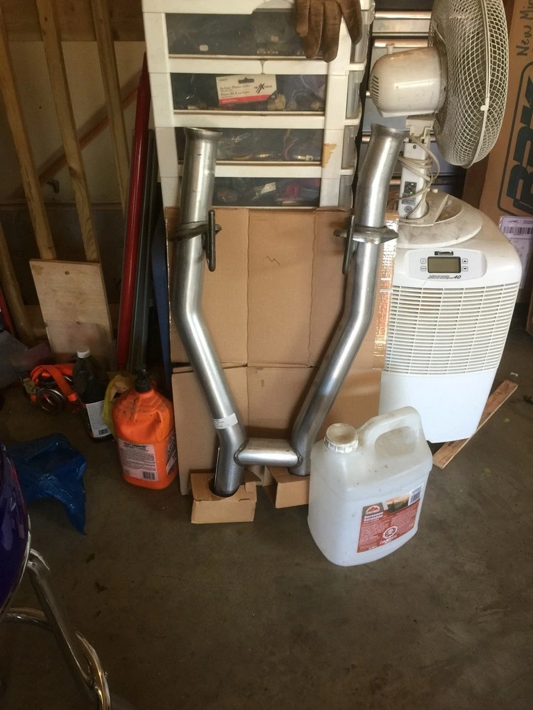

few other bits and pieces.
H pipe to go with headers, paid $150 NIB for both:

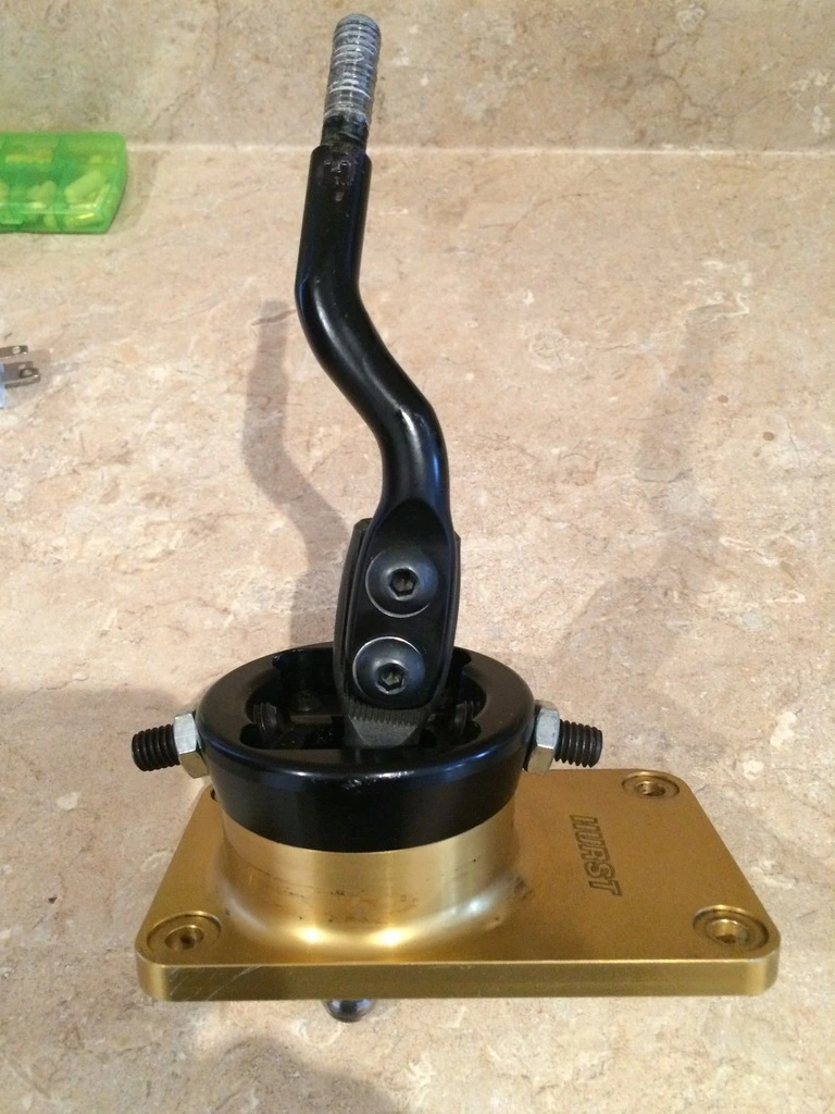

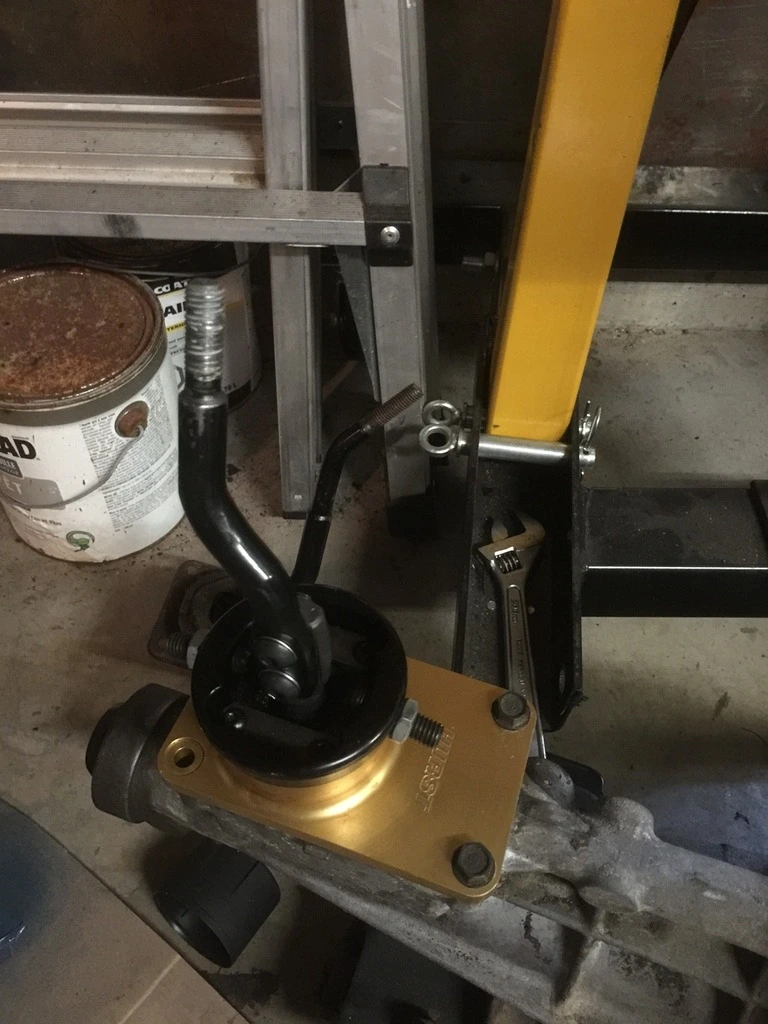

Hurst shifter, $50:
Shifter balls, ebay grabs, 15-30 bucks:

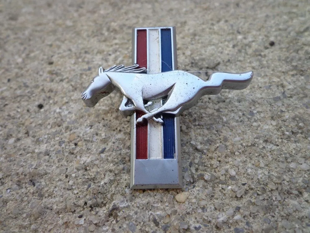

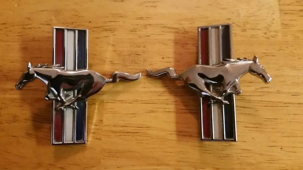

Ditching the Cobra emblems for:

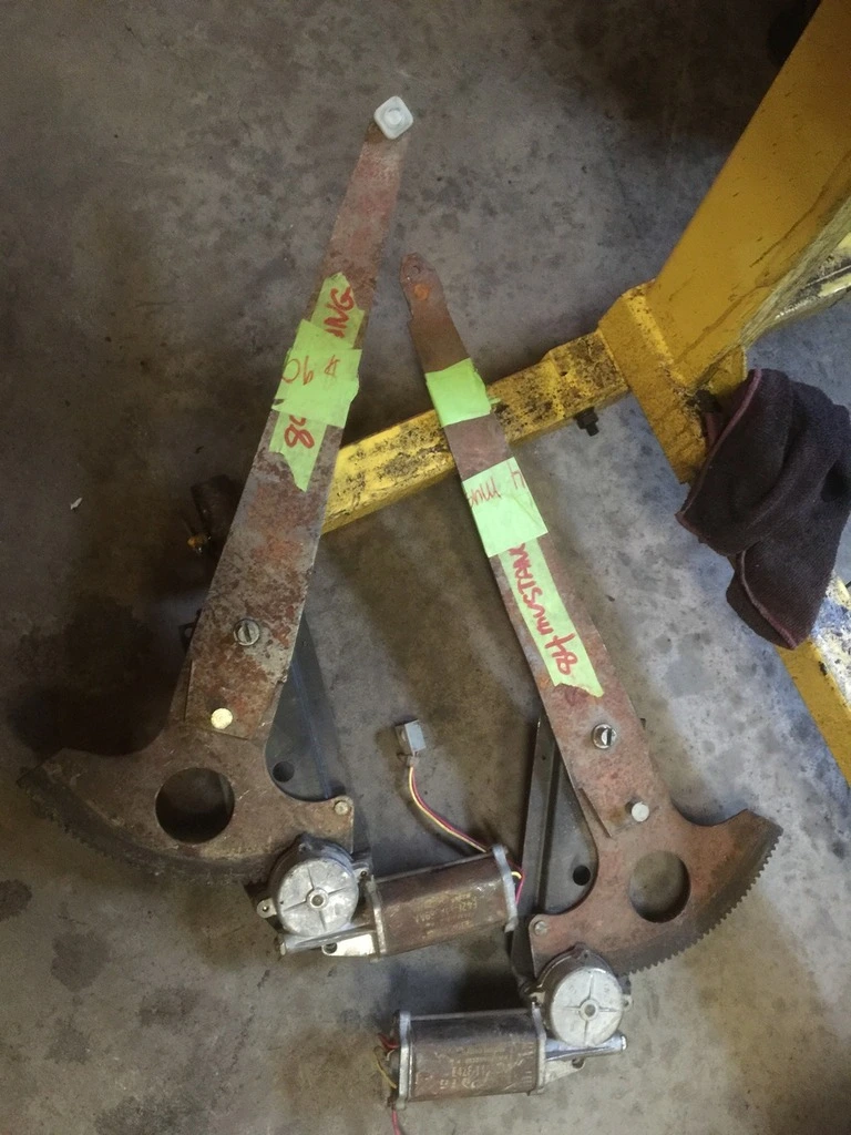

This is a non-A/C car (and not getting one) with manual windows. With no A/C I need to be able to at least open and close windows while driving, so:
30 bucks from an 84.

Might I suggest 5.0 badges for the fenders? After all, that's what came on a V8 car. Being that's what it is now it seems fitting. I think those badges are only $15.00 US, so it's not like it's a fortune, haha.
nope, I'm putting the tri-bars on it or maybe even blank.
Car didn't come with a V8 and "5.0" on the fender seems to attract every kid within two counties with an import and a fart can when stopped for a light.
I'm a bit more "under the radar" at my age....got nothing to prove. Just want to do my own thing and be left alone.
