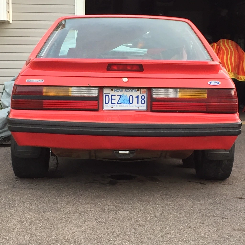

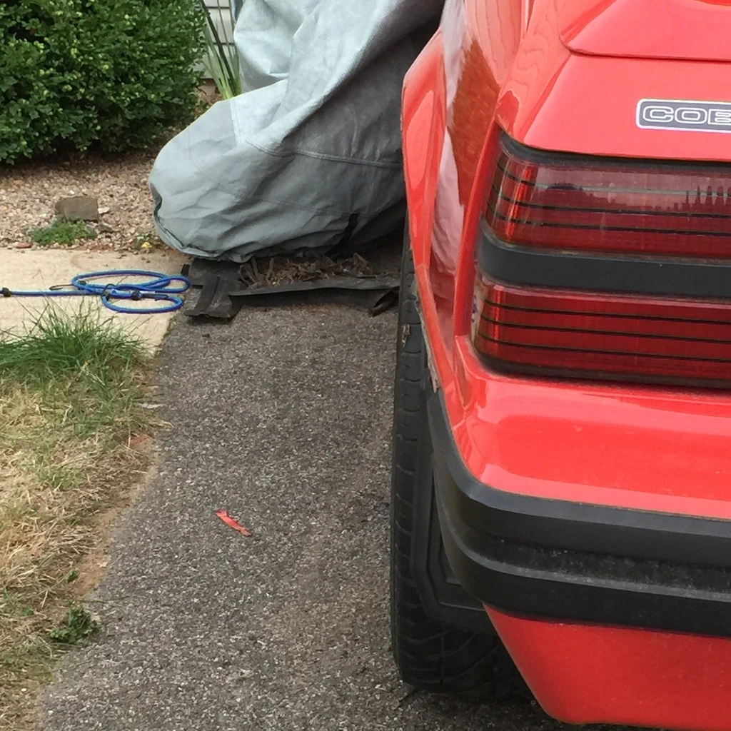

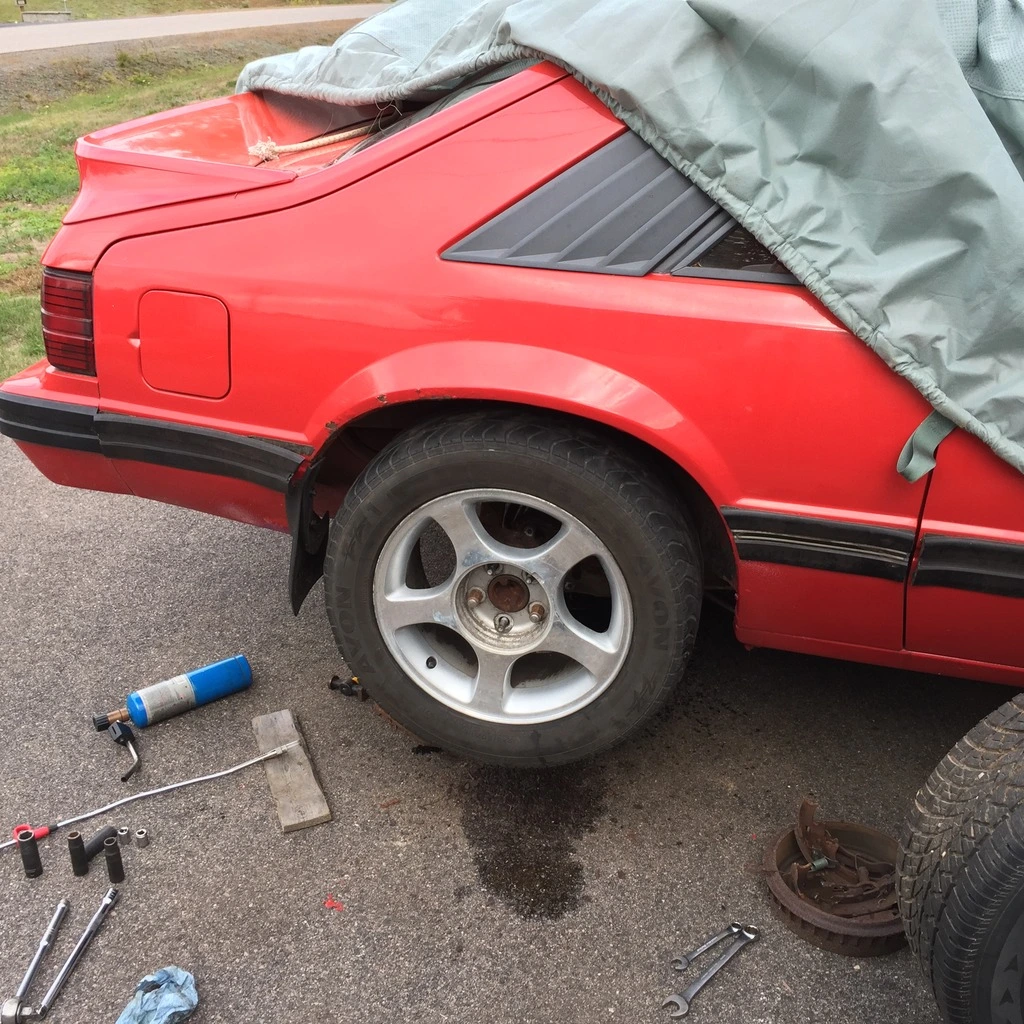

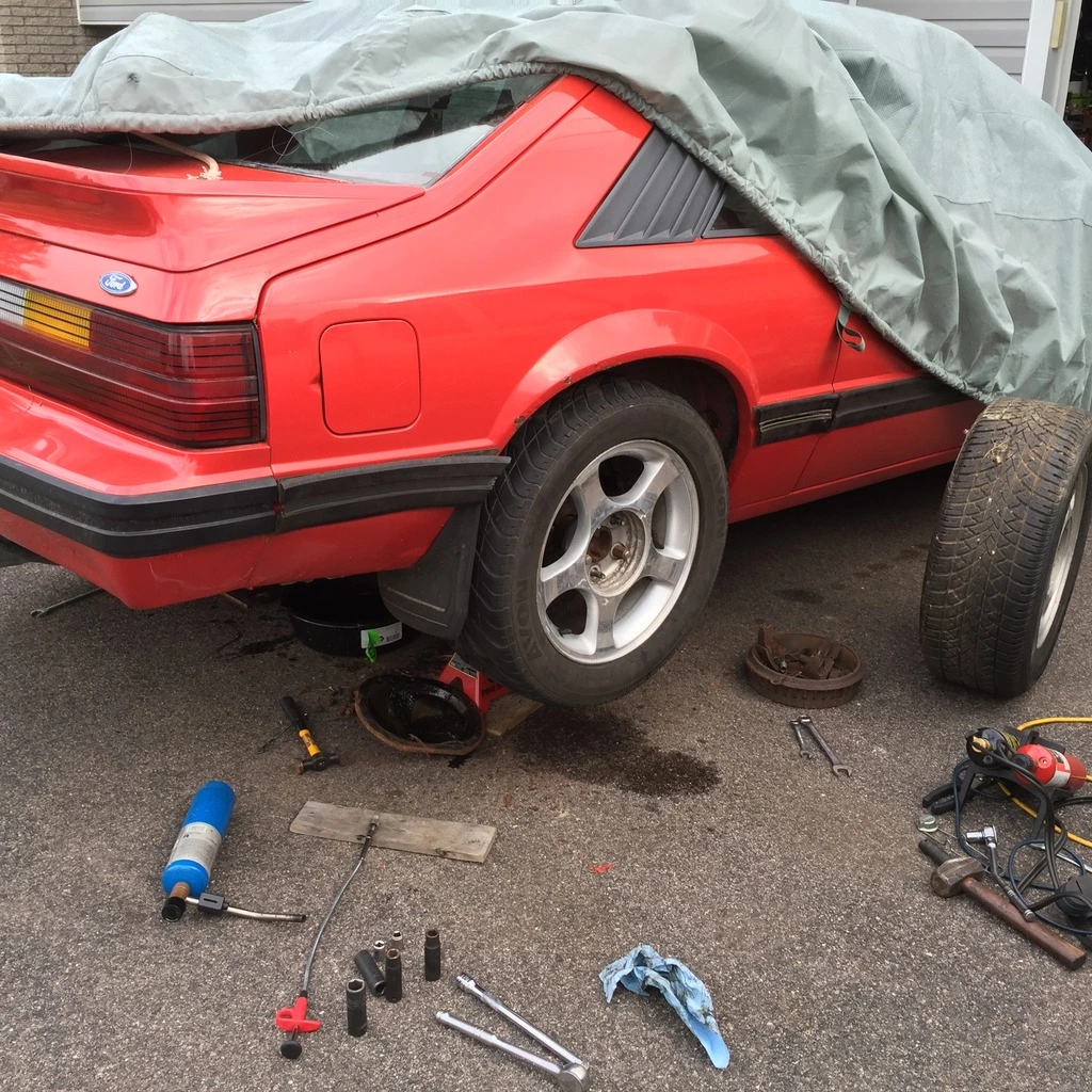

SN95 axles in the 83 7.5 and rear disc brakes:
Currently cleaning and painting calipers.
8.8 axles are hard to find around here and when you do, stupid expensive. One guy I found wanted 700 bucks for a rusty (and I mean RUSTY) 1996 one with seized brakes. No thanks. Yards don't have any and when you do find them they're rusted junk. And they still want 250-350 for them.
My car is only going to be street driven and around the 300 hp mark so a 7.5 will do until a reasonably priced, decent shape 8.8 shows up.
Crappy thing is both 7.5's are 2.73's. I'll keep my eyes open for a ranger/Bronco II 7.5. They could be had with 3.73 and T lok. Still not great, but better than an open 2.73. At least Ranger 7.5's are a dime a dozen around here. Should be able to find something that will work.
I was just going to swap in the 96 SN95 axle, but tearing it down revealed the seal area on the tubes was rusted so thin I could squeeze it with my hand and distort it. The axle in the 83 hasn't seen winter roads in a couple decades so it was in much better shape, making swapping the SN95 stuff into it a "no brainer"....
There's ample fender clearance even with the SN95 axle length:
(Mudflaps will hit the bin soon enough)
No rotors in that shot, but even with the rotors on it's going to clear the lip fine.
