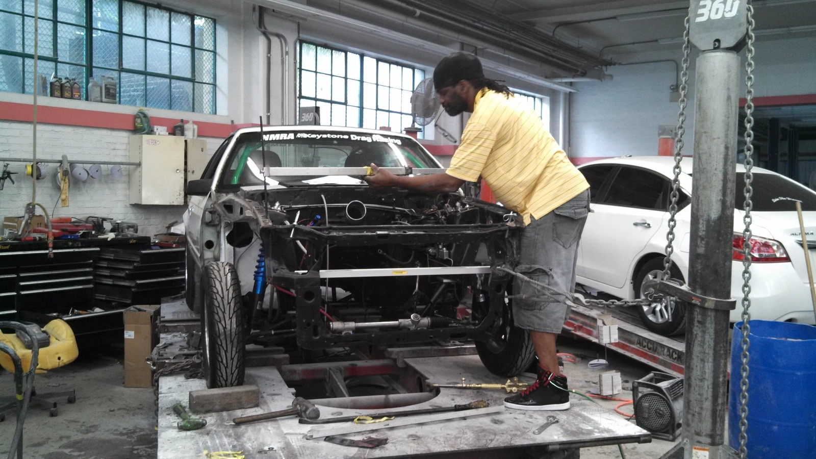

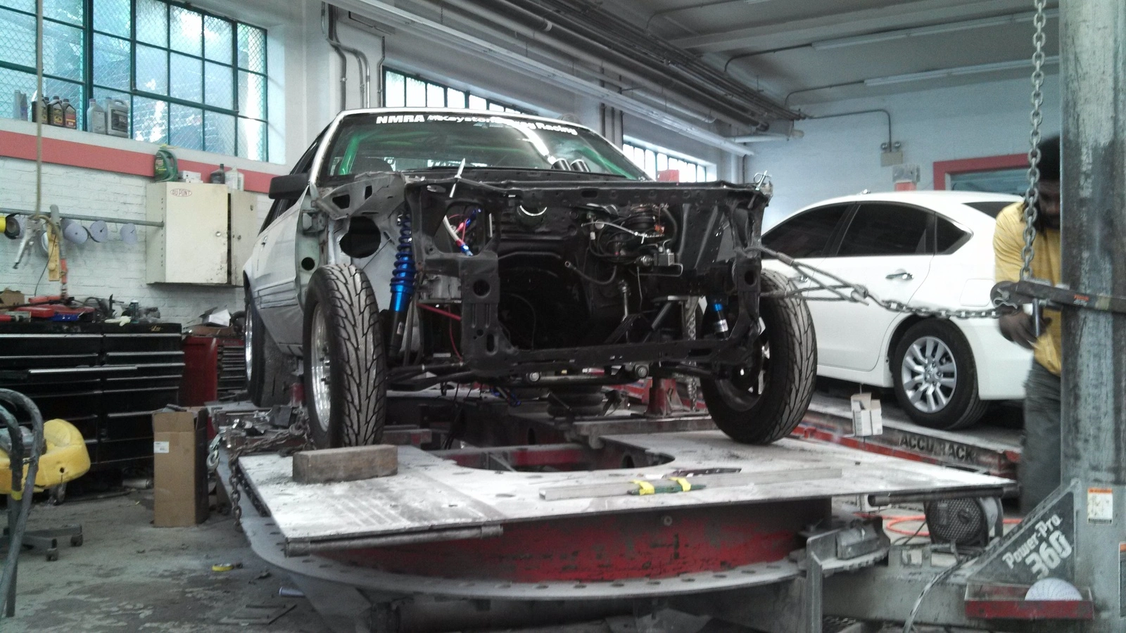

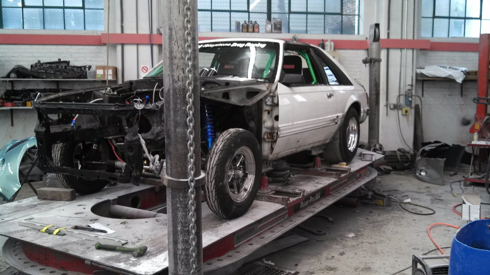

Update. This Saturday the car went to my friends body shop to have the frame pulled back into shape. The pass side rail was over almost 3 inches and the drivers side rail was up a bit over an inch. The engine actually stopped the drivers side rail from moving over any farther. The frame is completely square now and I will be starting the tube front end on the car in the next week or so after I clean out my garage. I'll update my progress here.

how did the pull go ?
Sent from my iPhone using my fingers
Everything pulled back into shape nicely. We squared the front and measured out the whole car. It's tied together pretty well and the only thing that moved was front of the fire wall. I'm hoping to start cutting the rad support out tonight and just have to go pick up more tubing to do the front end

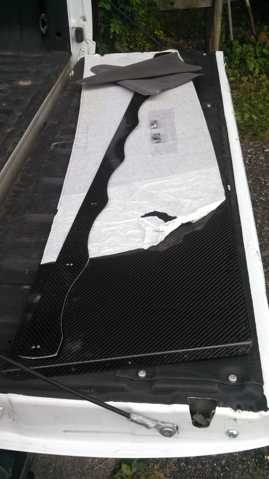

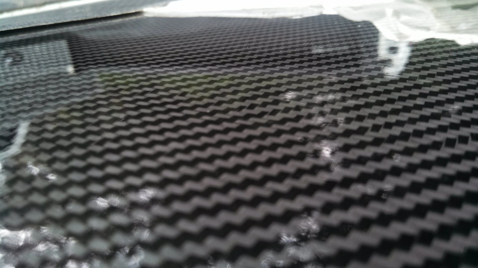

So I may have splurged a little bit. I was on the fence about putting a race wing on the back of my car or not... I wound up getting a screaming deal on this hyperformance carbon fiber wing. Stay tuned for more goodies I have coming and pictures of the car as it gets put back together. Front end fab starts next weekend.
