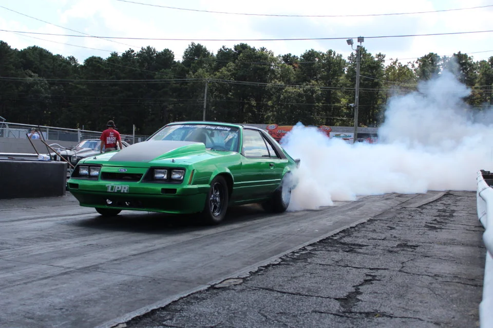

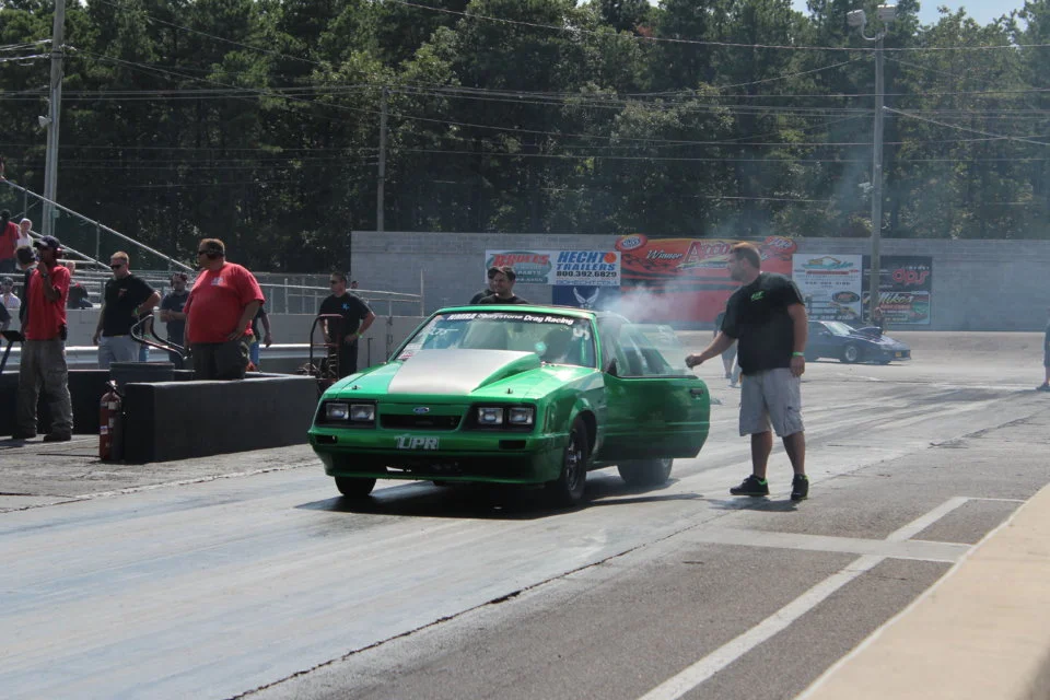

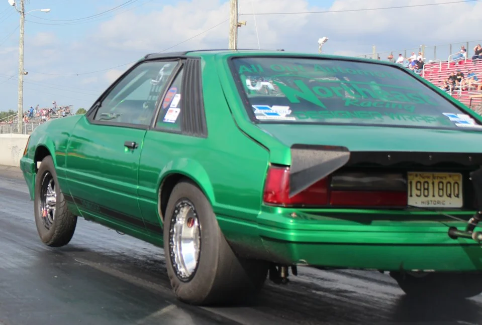

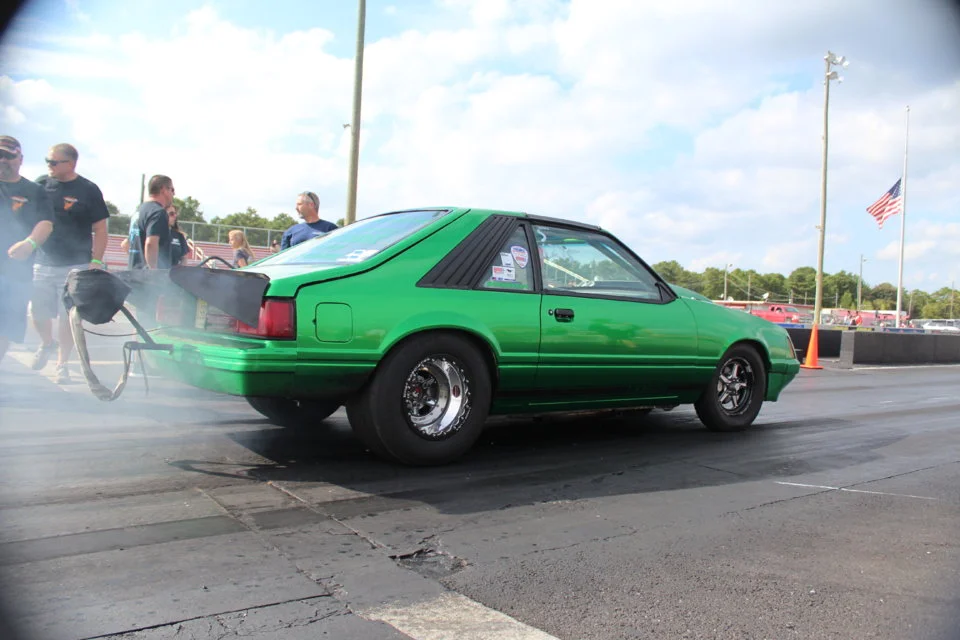

Outlaws at Atco was great this past weekend! We learned a lot and got some good data from the car. I'm fairly confident that we could bracket race the car at this point.... It goes 5.0x almost every single pass at this point. We have been taking small steps in creeping up on the tune and had our best time Saturday, 5.00@143 which I am very happy about! I think I will make a few small changes in the winter but nothing to major. I see a gear ratio change in the near future as well... It's been really nice not having to completely tear the car down after taking it to race, here are a few pictures from the weekend
