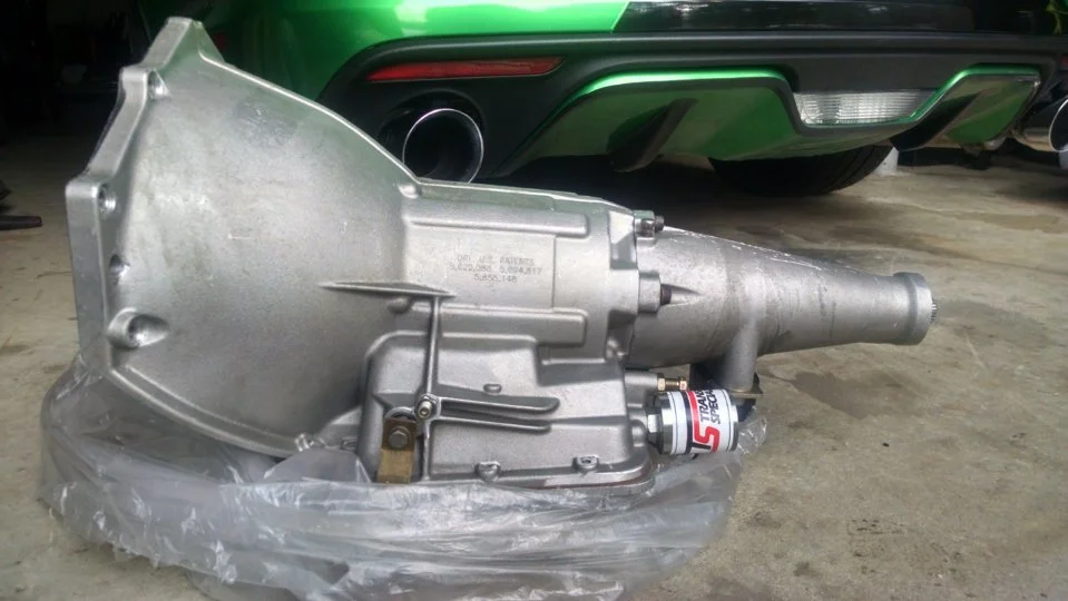

Transmission was freshened by my friends at Transmission Specialties who were gracious enough to sponsor the car for this season. They addressed a few concerns I had with the trans and found a broken band and retainer while they were in there. Everything is fresh and ready to rip!

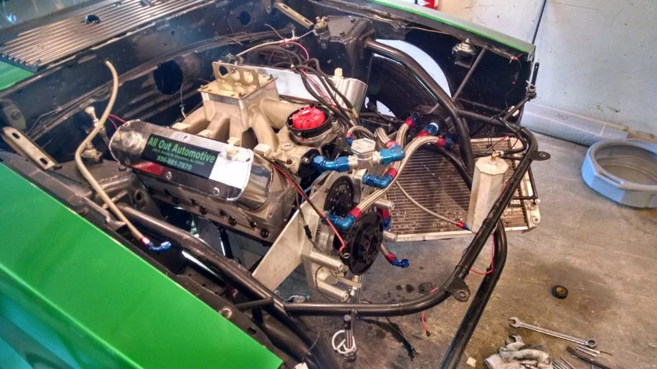

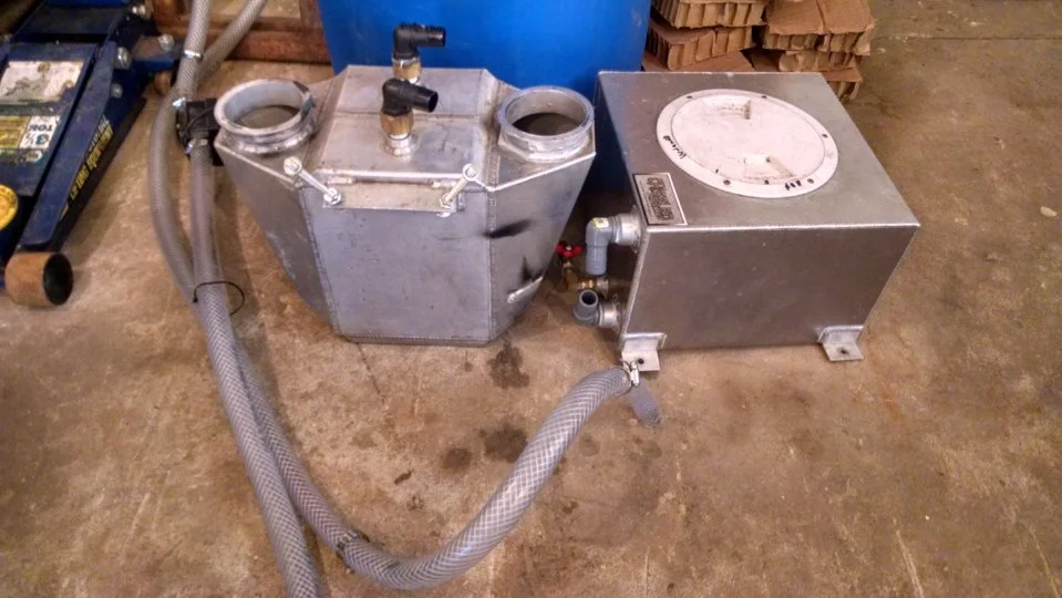

I did some final disassembly yesterday to get ready for the motor which is going back in tomorrrow (fingers crossed). Intercooler...who needs that anymore? Going to give this non intercooled thing a tryo_O

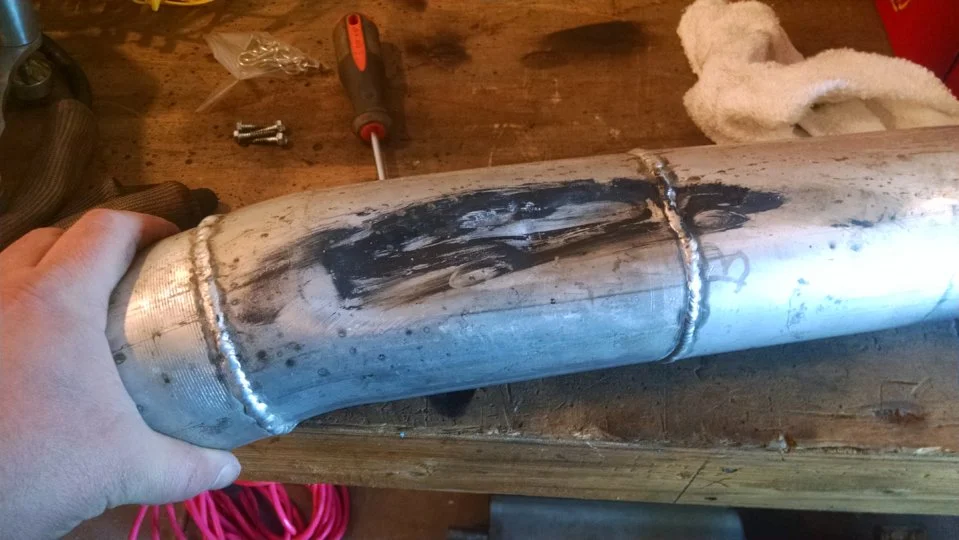

I'll be replumbing the blower tubing so the old tubing had to go. This is some of the carnage I found from when the tire must have met the tubing:eek: I don't even know when or how this happened!? Oh well, it's scrap metal now
Reactions: Sharad
Not gonna save any of it? Ya know......'just in case'?
The tubing will get tossed, if it wasn't smashed up I would keep it. I have enough tubing, v bands, etc laying around that I can make new tubing in an hour or two. I've been trying my best to not be a hoarder... If I saved every last smashed part I had I would need a storage locker as big as the one @tannerc91gt is working out of:cool:
Making some progress yesterday, I can see the light at the end of the tunnel
Light at the end of the tunnel huh?,.....that is usually a train.

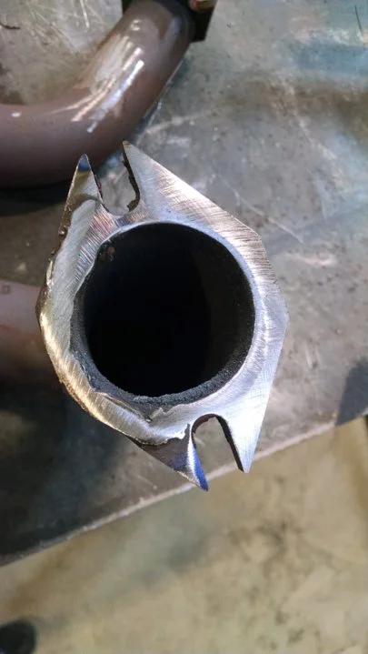

Well, I was able to get something accomplished today! I started to put the headers back on the car and though to myself " Self, I wonder why these headers leaked so bad last year... Maybe I should put a straight edge on the flanges and see what is going on" I did just that and come to find out, two of the flanges where not even close. Go figure that these are the two that would never seal for more than a few passes. On the straight edge they were more that 3/16" off from top to bottom. "Self, How the hell did this happen" Then it dawned on me...
The first pass out last season I did this:

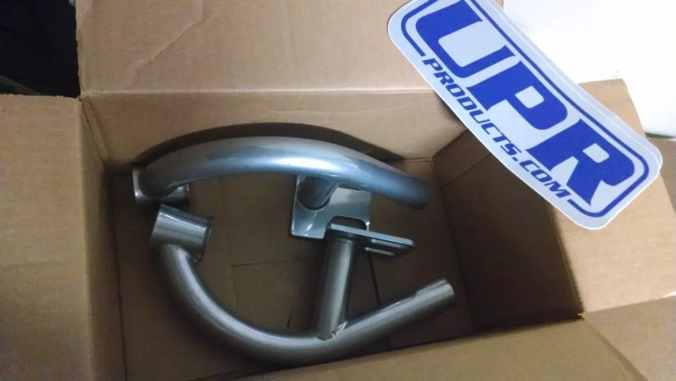

And smashed the crap out of the headers. This was before the UPR oil pan savers were installed, I have no worries about doing this again now that I have these!
Buying new headers was not in the cards... I did what anyone else would do, I got the welder out and "fixed" them. I welded the flange up and ground them back down until they sat perfectly straight on my welding table. We shall see how well they actually work in a week or so.
