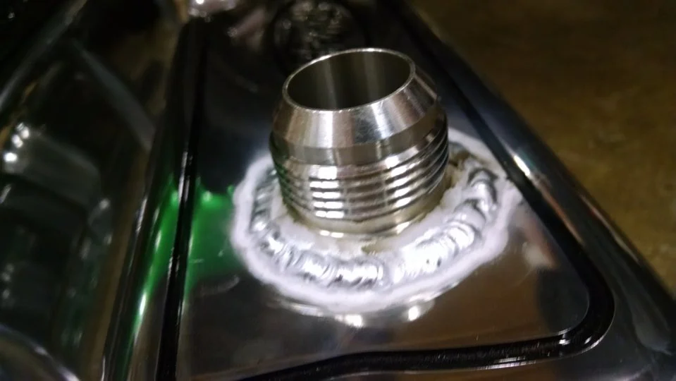

First things first, PROCOMP can suck it... I've had really good luck for years with their cheap fabricated valve covers, until I go to use them on my junk wagon. How the hell do you miss the flange pattern on a set of valve covers to the point where I can only start 2 out of 6 bolts? I only find this out after I spent the time welding fittings on the stupid things only to wasting more of my time and money. WHATEVER:bang:

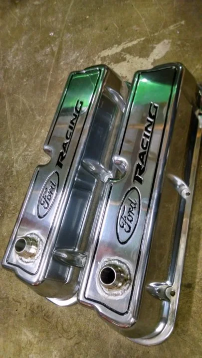

I called my buddy Booth over at Proform and had him send me out a pair of the cast Ford Racing valve covers that I know will fit. It's been a while since I've welded on cast aluminum, wait a minute, it's been a few months since I've welded on aluminum at all. It's been years since I've welded on cast aluminum let alone brand new polished cast aluminum. All in all they didn't turn out too bad, I have to polish them up where I welded on them but I managed to not burn the black painted pinstripe:nice:. The one thing that I can't say enough is the support that we get from all sorts of different manufactures is incredible and really does make a big difference in our racing program!
And yes... they are 16AN vents on the valve covers!

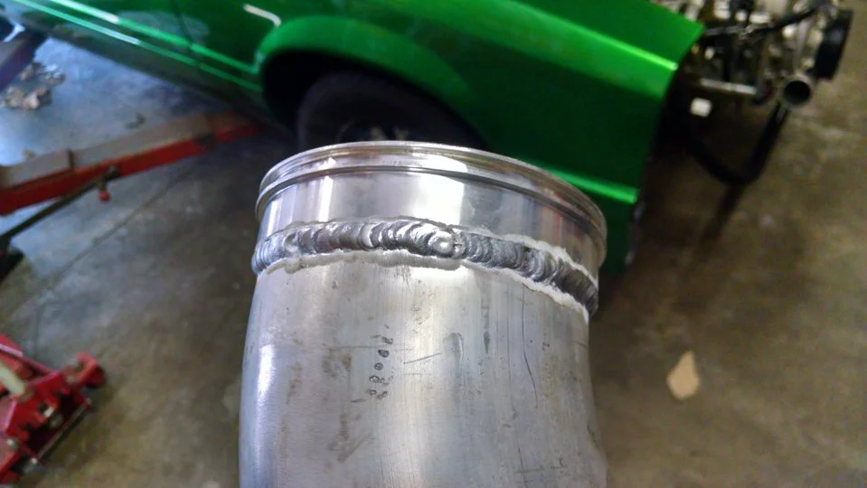

I finished welding the discharge piping last week as well, my Snycrowave hasn't had this much work to do in a while
Keep in mind that this is .058 tubing, 80 amps blows through this in about a millisecond flat if you're not careful
