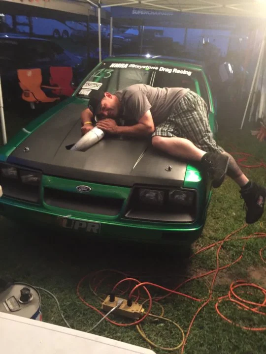

kris bonding with the car View: https://vimeo.com/138385781
