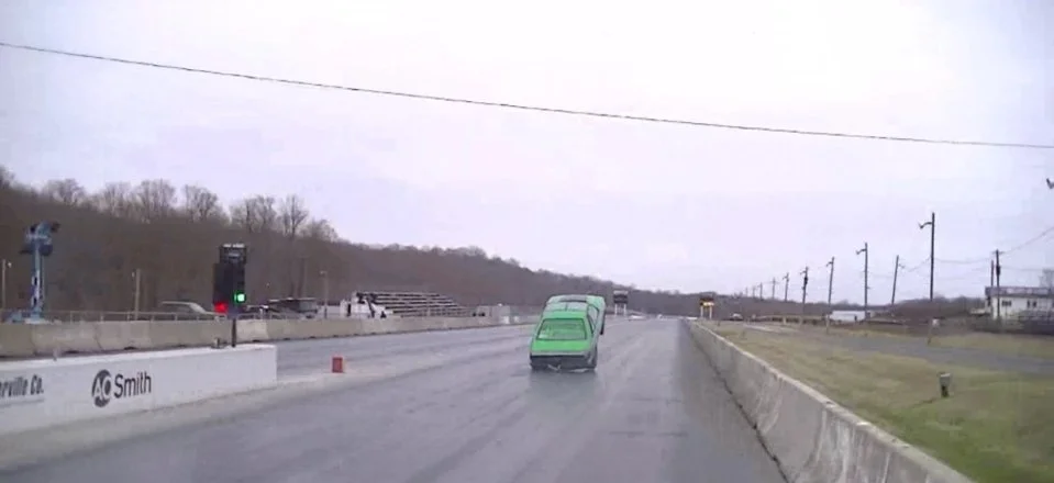

Here is some of the video footage from this past weekend. I'm still working on getting the rest of it all together. You will see the passes that we made in order first in real time then slow motion, with the exception for the pass we left in 2nd gear hahaha. You can see in the later video's that the car hooks on the hit and carries the wheels for a short time before blowing the tires off with the front in the air. After looking at the car in close detail last night I have found a few things that will get some attention and will hopefully get this issue sorted out. We have come to find that the tuning window to make this Gen 1 tire work with 1300+hp is exceptionally small.. The Pro Radial has a much larger window and is considerably more forgiving! I have a neat video of Kris pedaling during first round of qualifying from inside the car, it's a true testament to how much work goes on inside the car. More to come
View: https://youtu.be/fCi0Am7_fxs
It's really awesome to see the rear suspension work in slow motion . I think the idea from the guy who built the shock was to unload the rear enough to carry the car forward . So that it did not get all up on the back tire again .
Reactions: 84Ttop
It almost looks like the rear of the car jumps instead of squatting just after the initial hit, but that's just an uneducated observation.
correct... which is what you want. with this much power and trying to dead hook a tire with no bars what you want to do is drive the tire into the track with loose extension on the shock and tight compression to keep it digging into the track.
after seeing the slow mo video im thinking looser on extension tighter on compression and full tight on the front unless those struts are shot. then that will change what im thinking up front
I guess it's counter intuitive then. Seems like you'd want the chassis moving down to keep weight on the tires which would be loose(r) compression and a tight extension and a tight front end.

In case anyone forgot about the first trip out in this car a few years back, lmfao...
Reactions: TOOLOW91
And I was excited to see daylight under my drivers side front tire back in the day. Sheeesh!:rolleyes:
