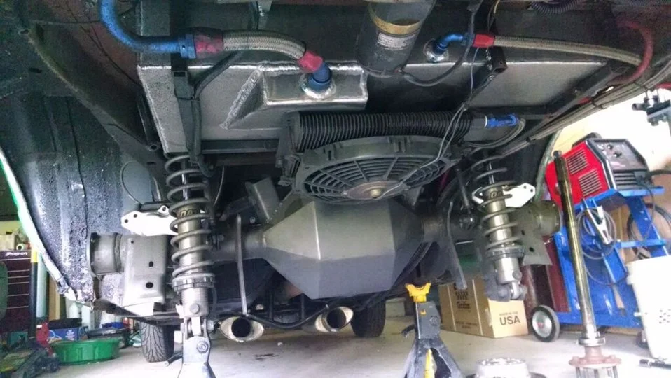

This is a photo from last year but you get the drift. It has a lot of new "ish" under it now, like a mechanical cable driven fuel pump and gangster shocks lol
There's more money in your rear end than most people have in their entire car. Wait what?
