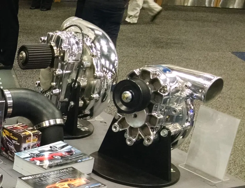

Why so few of those ysi's in existence? It seems the demand is there for a good sized production run? Or is it just an obscene cycle time on the billet impeller?
84Ttop
5 Year Member
Jul 2, 2009
5,222
3,254
204
South Jersey
Sep 16, 2015
#1,002
  • Sep 16, 2015
  • #1,002
There isn't a huge demand for these blowers, mostly due to the limited market. While the impeller and Volute of the V27 are identical to the V7 Ysi-b, the similarities stop there. This particular blower uses a different case, heavy duty transmission with a different step up ratio, completely different bearing pack, different oiling system etc etc etc. These are "race" only type blowers and only fit into the NMRA Renegade or Ultra/Ultimate street rules hence the limited market. All of the bits and pieces are built to order with very small production runs, typically they would have the parts in stock to build a few if needed it just so happened that the timing of a few of these big races has them waiting on the machine shop.
Not the best picture to illustrate the difference but you can get the drift here. On the right is a V7 JT trim and on the Left is a V24 Xb105 (same transmission case as the V27)

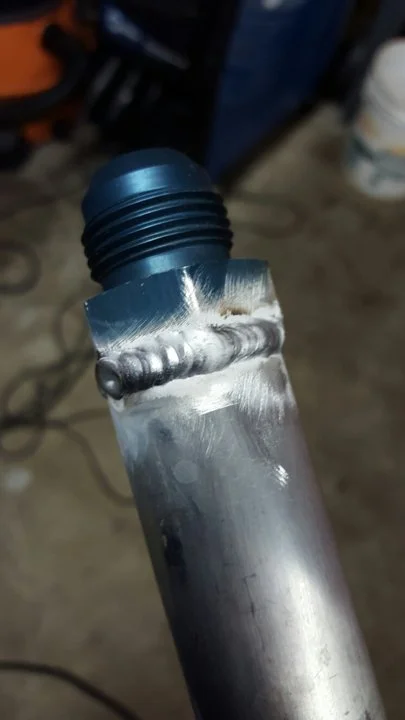

Today I "made" some time to do some things that needed to be done. It's not easy finding time, running a business, spending quality time with my family, working on and number of ridiculous projects.. it all takes a lot of time. Well today I had one of the most epic time management wins of all times! I wake up today knowing that I have a meeting to attend first thing in the morning 8:00 followed by a funeral at 11:00. I knock those things out no problem. I think to myself, self you need to weld the fuel rails on the 84' so that we can actually go back to the track before it snows... That is what I do. On my way back from the funeral I stop at the shop (one of three different shops I have my crap spread across... and decide to weld these fuel rails. The caveat to this is I'm wearing some nice clothes, clothes that have no business being in a shop. Oh well, if I ruin these pants or shirt that is too bad... I weld this junk and go on my way. I'm now at work completely caught up and typing this on the interwebz before I head home to actually fire the car back up... I'm winning all over this day! The pants and shirt in case you were wondering... they survived unscathed!
Mandatory welding selfie... That ain't no racing T shirt
This is one of my finished fuel rails, it isn't pretty welding on contaminated aluminum but I made it work
