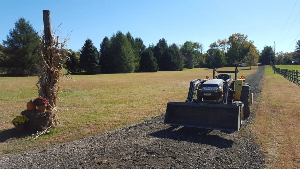

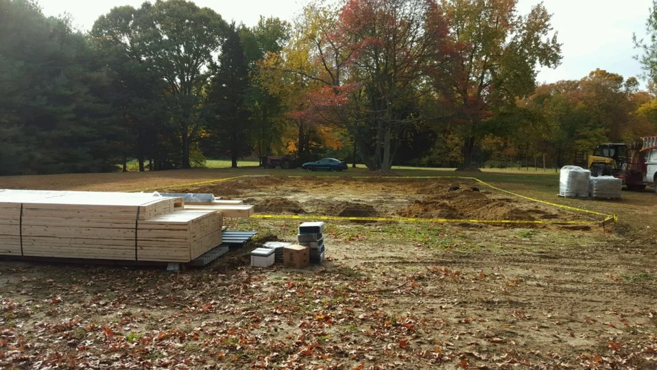

In other news... trying to keep up with @Boosted92LX we started construction of my new shop!
80 tons of stone spread to put in a driveway and the building is under way, footing inspection done and more to come in the next few days!
Reactions: stangboy, RacEoHolic330, A5literMan and 2 others

That's great on the shop, man! Looks like a good size! What are the dimensions?
40x60x12
The plan is to house a pair of lifts, fabrication area and the dyno

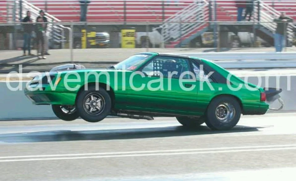

Well today went great! @TOOLOW91 came out to crew with us and was a big help in getting the car situated today. We had a great test session and ran the best we've ever done with the current setup. 1.19 60' and 5.16@137 to the 1/8th with the little YSi-b blower. Not only does this put us in the UltraStreet mix, it should put up some 7 second times 1/4 at the World Cup Finals next week.
View: https://youtu.be/nBwI8DyQg9Y
Obligatory video.... It was great, no other way to put it lol
