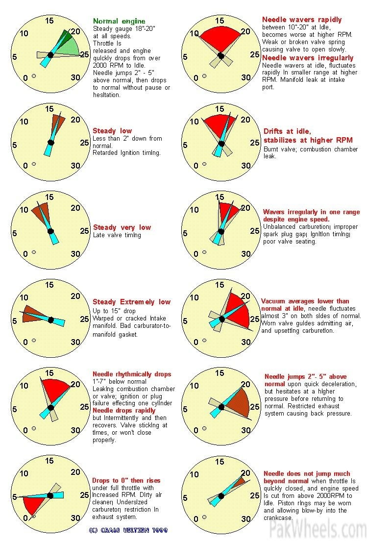

It is time to beg, borrow or buy a vacuum gauge to troubleshoot the problem. Most auto parts stores will rent or load one if you have a credit card.
Vacuum Gauge readings
attachments\606429
