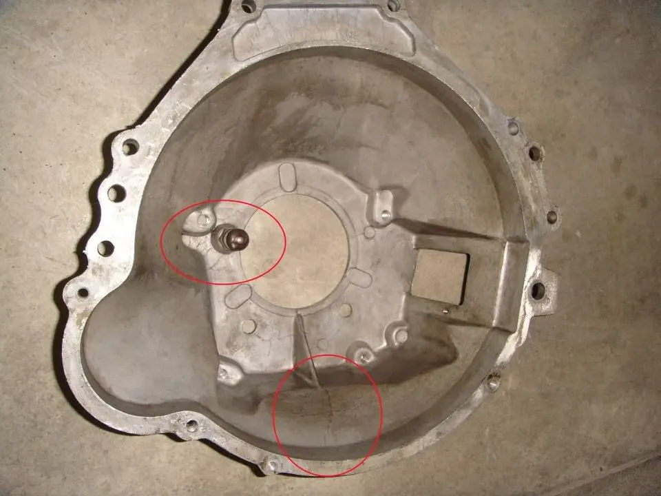

Are bellhousings known to crack much? This is the housing from the aforementioned '85. See suspect areas I circled in red. Are those just surface fractures? Or indicators to stay away? Thanks in advance!

OP-That could be casting flash not cracks, Ive seen that on bells as well but usually that area is smooth...it is really hard to tell in pics but it would be an odd place for it to crack.
