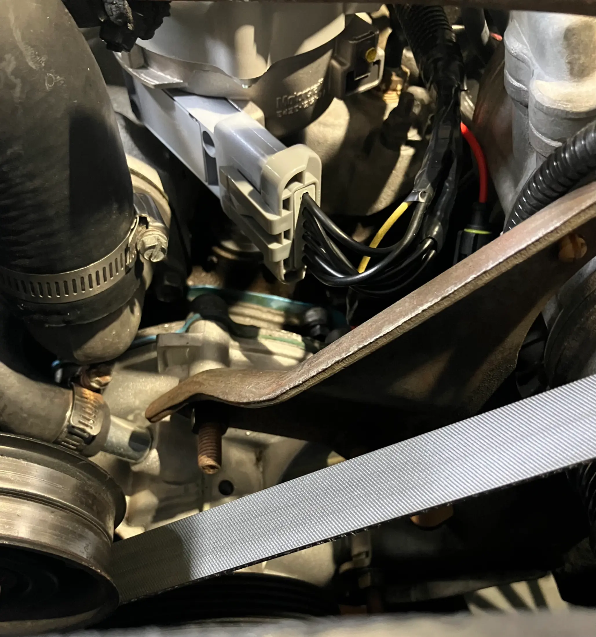

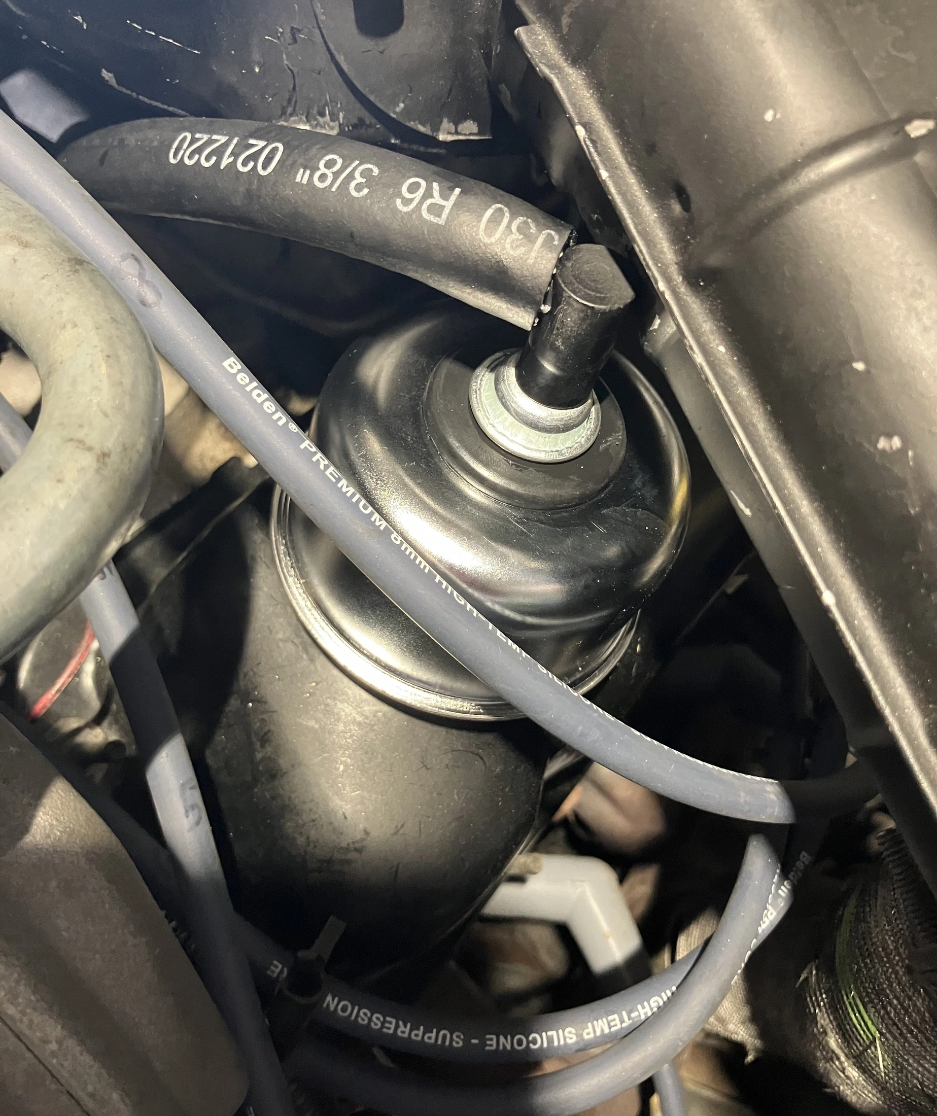

Did some more maintenance work today. Replaced what I believe is the original PCV valve/breather cap/hose as well as the EGR sensor to try to clear my KOER EGR codes. Also replaced the original TFI connector that I had been probing with needles for few days. Only 1 EGR code remains, code 32.
