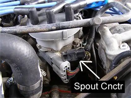

When setting base timing Ive heard that you have to unplug the spout connector to stop the computer form changing timing. Now Im wondering what is the spout connector? Does any one have a pic of it, and/or where is it located?
Thanks,
Dave
my.php
Its on the end of a wire that hangs by the distributor. http://img440.imageshack.us/my.php?image=timing1fe1.jpg

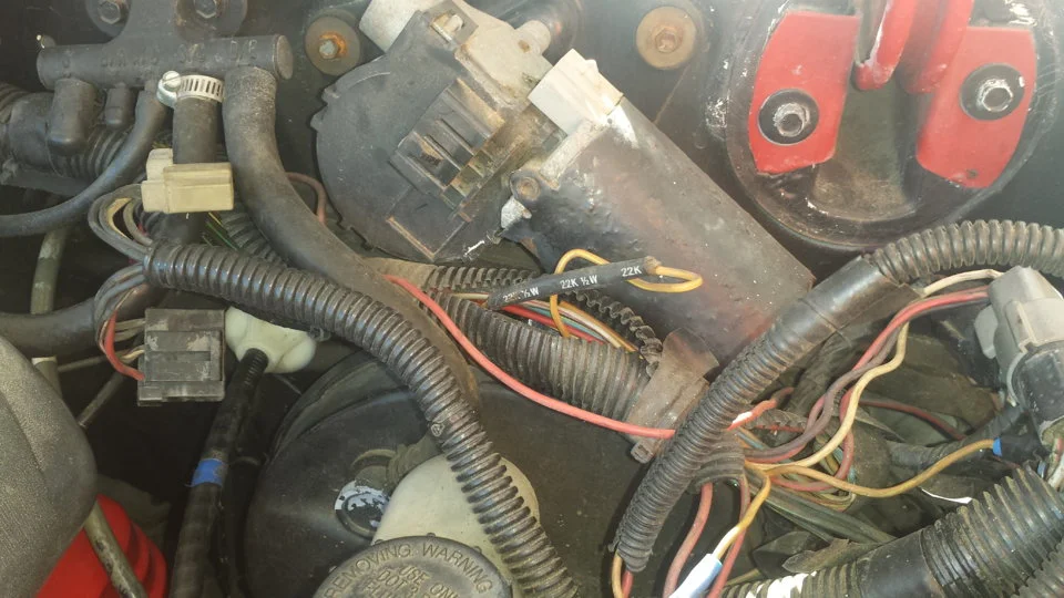

If you look really closely at the engine diagram I posted you will find that the 22K ohm resistor is about 6" back from the TFI module connector. You get to very carefully peel back the wrapping of the TFI harness to find it. When you put it back together, be sure to carefully re-wrap the foil shield back around the wires. The foil shield prevents electrical noise from the spark plug wires from interfering with the signals the TFI sends to the computer.
Is it 6" from the TFI connector, or 6" from the computer in the kick panel area?? Also, if using the Ford Racing EFI harness without this resistor, do you anticipate any problems??
Check over by the brake booster. Its not in the harness on the TFI, its on the main part of the harness over by the plugs that connect to the dash harness. About 6" or so from that, going back toward the EEC.
Good info, I will remember that. The diagram seemed to point at the TFI module wiring.
For informational purposes, the if the resistor is marked with color code bands, they should be red, red, yellow and a tolerance band. See http://nearbus.net/wiki/images/7/7d/Resistor_color_codes.jpg for more help
If I remember right, the resistor is covered in a shrink tubing that is sealed to the wires. So, you wont be able see any markings. The shrink tubing is labeled though. It's a 22kohm 1/2 watt resistor.

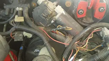

Here is the location.
Is this 22K Ohm resistor in 1995 5.0 Mustangs as well? Same pins (2 on the ICM and 4 on the ECM)? I tested this wire and got 1 which from what I understand is open. I have been trying to track down the cause of my 212 code Loss of IDM signal - short to ground in spark output (SPOUT) circuit.
