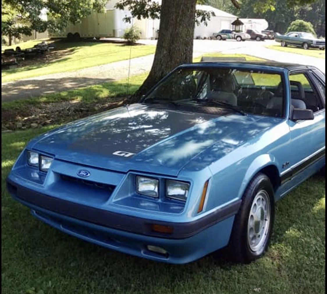

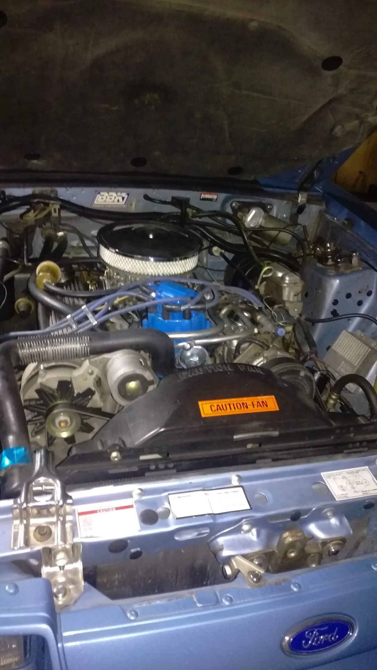

new here from southern Indiana. I have an 85 gt t top in pretty good condition. as far as I know the only mods are a 2.5 exhaust. eldebrock carb and intake and aftermarket distributor. there's nothing wrong with the car runs fine it does have rear seal leak and has a 5spd. anyways I wanna pull the engine and trans and rebuild them. do I just do a straight rebuild or do I stroke it. I have a reliable spot to check over and bore the motor, they can also redo the heads and balance the crank.
I have rebuilt engines before but never modded one. if I go .030 over what all do I need besides new pistons. I do know I am installing a Holley sniper and some shorty headers.prob keep the intake. it is not the original motor so until I get it out I'm not sure what year it is or if the heads are aftermarket as well. looking for options and opinions. thank

A poke and stroke cannot be seen from the outside, good way to get HP without distractions, I would do some research on the intake manifold, likely not a good choice for the larger displacement, choose your parts wisely.

If you add displacement then the induction will need to be addressed. You have it covered with the Holley Terminator setup but the intake, cam, and heads will need to be spec’d. this could be porting the intake you have vs buying a new one and porting the heads you have (if they are worth porting) vs buying new ones.

- 306 is a 302 with a 0.030" overbore.
- If the block will just clean up with a hone then you may be able to just re-ring the stock pistons. If you need new pistons and the block needs to be bored then make sure they deck the block, line bore & hone the cam bore & mains, and when the bore the block that they use a torque plate. Again, let the shop figure this out and if you need new pistons I would see if anyone on here has a set of 0.030" for sale as new pistons are not cheap now.
- As far as getting the crank balanced they will need the pistons, rods, crank, flywheel, and clutch setup to properly balance the assembly.
- Stock heads are boat anchors. Any money spent on them other than a quick freshen up for s stock motor is flushed down the drain. If the car has stock style heads (GT40's are typically worth keeping and going through) then I would get a set of AFR Renegades and be done with it. Realize you will need a set of stud mount roller rockers and most likely will need non-stock length pushrods but again the machine shop can figure this out.
- Again, depending on what intake you have you may be able to reuse it by just sending it off to TMoss and have him port it for $150 or so. He ported my Cobra lower back in the day and it greatly improved the flow. Website is below and scroll to the bottom for contact info.
- Once you know what displacement motor you are going to go with, what heads, what intake (will need flow numbers or projected flow numbers), gears, trans, exhaust setup, etc. than you can fill out the cam card for Ed Curtis and get a cam that will work with the combo. You can run the stock roller lifters on a new cam but they will need to be inspected very carefully so you may just want to order a new set. If so I would recommend these for a fairly stock setup:
