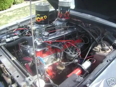

That is a 300I6 in a fox,... so it can be done. (sort of). The engine will fit front to back,.. but will stick outta your hood in one form or another. The biggest obstacle to the swap revolves around where the oil pump is located,........ right in the middle of the engine. You are kind of forced to accommodate it by either sitting the thing up into the wind,... or cutting the k-member, and lowering the rack and center. The latter opens A can of worms bigger than the coffee can velocity stacks dude has here with bumpsteer/steering/suspension geometry.
The previous solution invites poor handling due to a really high center of gravity,.. and excessive engine overhang in front of the wheels.
Trust me dude,.... I'm Stangnets' torch bearer for taking the path less traveled,.... but a 300 in a fox would more than likely make traveling that path scary.
Now, as with all things,.. if you want to do something badly enough,.. there are ways of getting it done. If you lived near me,... and I wasn't sticking a inline six that isn't supposed to be in a fox already,...i'd tell you to come over,..and we'd cut the k-member, lower the rack,.. lower the control arms pivot points commensurately. Then we'd throw that pig in there and hack your hood where it needed to allow whatever is gonna stick out,.. room to stick out.
Anything that involves cutting the k-member scares the crap outta me. Like Mike said, it opens a whole new can of worms. Unless you REALLY know what you're doing and REALLY know your way around welding, I wouldn't touch it. I guess it would be interesting to run over your own engine when the k-member collapses in half :crazy:. The skeptics are right on this one...
