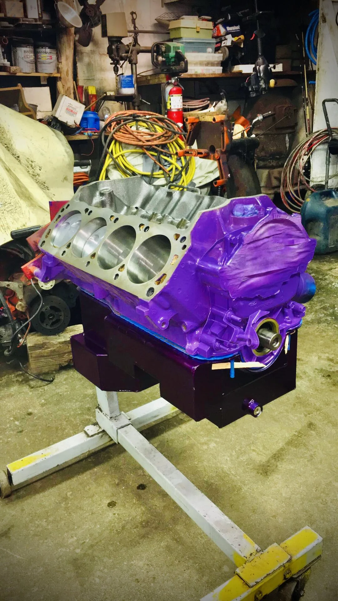

i don't really have too many pics, we're still building the motor. i'm buying the new set of victory's titanium valves either this weekend or on payday, thursday, so i can post some pics on this thread after we get the heads on and such. many of the parts, like heads and such are still in my room lol, here’s the beautiful block.

i appreciate the share of experience man. sounds like this should work if we can keep this motor happy, it should make my desired power. the most powerful sbf stroker we've built prior to this was around 815whp~ on FULL boost thru the controller. definitely a few new experiences in high horse engine building for me.
