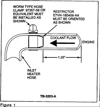

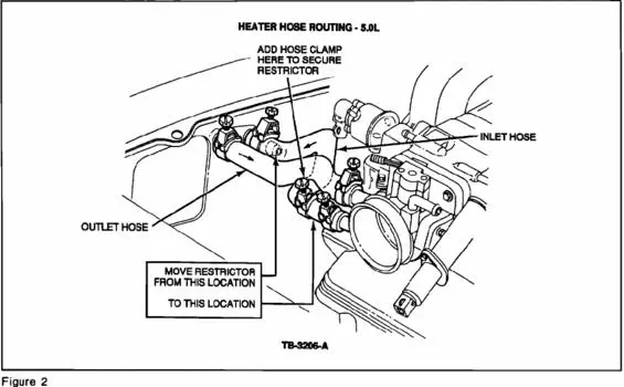

http://pweb.netcom.com/~skent/mustang/1990/heater_core/hcore.html
"When you install a new core, make sure that is has a plastic restrictor on the inlet (the core may come with this, or your old core may have one that you can re-use). If you don't have one, get one from a radiator shop or other source. You need one because the Mustang's heater core's inlet is larger than its outlet. This means that a pressure drop is created across the core, and this is probably one of the reasons why they fail so often. Adding an inlet restrictor causes the pressure drop to occur before the core, and will hopefully lead to a longer life. Ford started putting the inlet restrictors on sometime in the mid-late eighties, but it's a good idea for any year of car."
Actually the one I got from Ford was metal. It is a small round piece of metal that you clamp inside the one heater hose (the inlet hose, hence the name). It has an orifice to limit coolant flow through the core, especially at higher RPMs. It was originally used only on police Mustangs.
