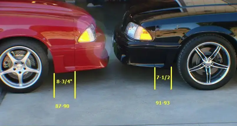

The area that changed on the fenders is the area ahead of the front wheel.
So you upgrade to the 91-93 fenders you would need the fender, and the correct GT ground effect spat ahead of the wheel.

This is perfect thank you. Now I know when I get ready to order my new cobra body kit just to get the one for a 91-93 and new fenders and roll the :poo: out of them, hood and hatch and will be good to go I was just worried about the way they bolted up.
What these guys are saying is the "correct method"
I bought the 91+ gt pieces and me and my body guy worked the fenders to fit, and just had to trim the liners a little to fit...
less than $150(gt pieces off FB) I can't tell the difference
