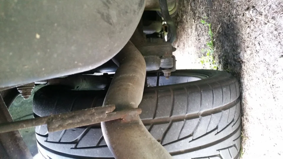

Someone help me with the rear. The rears i haev now rub like crazy
255 should not rub. Still running quad shocks? Rolled fenders? What are they rubbing on? Fwiw I have 315s on 17x10.5 rims and have pretty much no rub unless I take a hard corner.

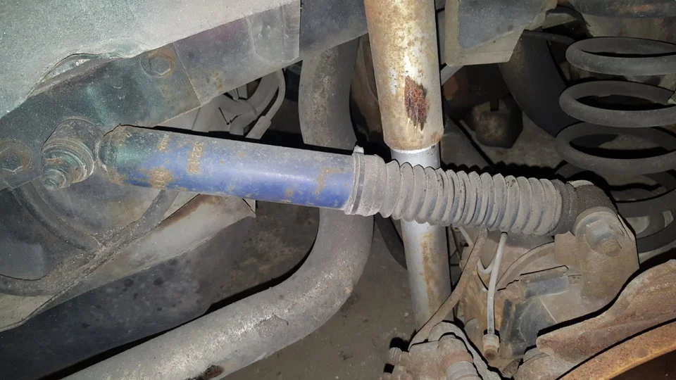

There 255 50 17 they are tall it seems like. When i have passengers in the back it rubs or a very hard bump. Idk if i have quadshocks still lol. Heres a pic.

The blue one is your quad. You can try installing it backwards but I think you will likely need to remove it. I'm not familiar with a 17x9 rim that won't touch it.
Is it bad to uninstall it ? Or flip it ? Really just,want to redo all the rear suspension while im at it do you know exactly what i need to redo all the suspention and be able to fit a 270 40 17 if i have to will a 255 45 17 and 245 45 17 be a good combo ?
I've got an 86 GT. Running 17x9 Cobra r's with Nitto 275/40/17 tires. Strange adj shocks,maximum Motorsports lower control arms,team z Motorsports springs and still have the quad shocks on. Every once in awhile I get a slight rub if I have people in car and go over a dip but otherwise no issues. Removing the quad shocks and keeping stock controll arms can result in wheel hop if you launch hard from a stop. Some people get lucky and have no problems most don't. If you install a good set of control arms you can remove them.
