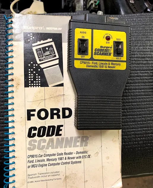

You should really try and perform the KOER codes along with the cylinder balance test at the end of the code reading. It will be very helpful to you and us in terms of trying to diagnose the issue
R82148V
May 26, 2020
125
36
38
Sounds good and you're definitely right.. I'm using this for code retrieval. I'll get back you asap.
Thanks again!

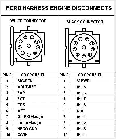

I wanted to perform the cylinder balance test that 5L5 was stating, but since it was running soooo rough. I didn't want to keep it running. The engine ran like it was going to rip off the mounts and I just installed new ones! Instead of doing a balance test, I did a sound check with each injector using the screwdriver method. As It's running and using a long screwdriver, wooden dowel or even a shop vac hose, you put one end of the tool against the injector and the other end against your ear. You should here the pulsing clicks IF the injector is firing. Of course this test will not tell you if one is clogged or dirty. Anyway, I checked all (8) and could only hear (4) working!! Cyl 2,3,4 & 8 were working and the rest were not. Hence the heavy duty rough idle and bad throttle response.
Instead of taking the upper intake off to test everything, I just tested through the Black 10-pin (Salt and Pepper) connector. These connector separate the engine bay harness and EEC harness. Top of the 10 pin connector runs to ECC and the bottom half runs to the components. I disconnected the Black 10 pin connector and checked all EEC ground injector wiring from top part of the connector to each EEC pin using a DMM. They ohm out at 2 so I knew the wires were good on that half. I used the bottom half of the black connector to test each injector ohm to see if they were open circuit meaning dead which the DMM would be infinity or OL. I probed Pin #1 and each injector Pin. They all read 16 ohms, which told me the coils in the injectors were fine and also the wiring (hot and ground) going to the injectors were fine.
My last test I wanted to jump each injector to the BATT to see if they opened. I used the bottom portion of the black connector again for this test using the DMM probe wires and alligator clips. I clipped both probes to the BATT, and probed pin #1 with the positive probe and the negative probe to each injector pin. Only Cyl 2,3,4 & 8 made a clicking sound and the rest didn't.
Diagram of the Salt & Pepper 10-pin connectors and EEC PINS below.

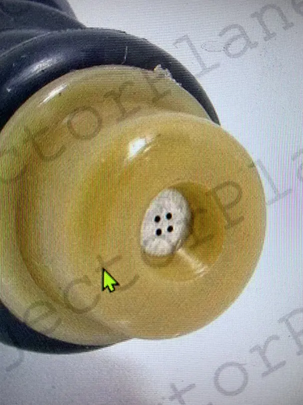

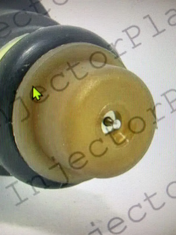

I picked up (8) reconditioned injectors from SouthBay Fuel Injectors. Model# FOTE-D5B. These came with a 4 hole tip.
What I had in there were E6TE-A2B that come with a single pintle hole tip.
I decided to change all (8) just for the fact of age with this being an '87.

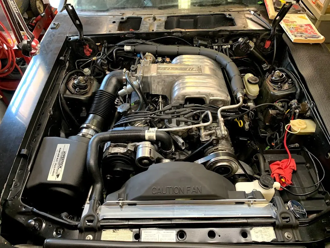

I didn't state this before, this beast sat covered for the past 12 years. Been working on it a little each day for the past 2 years, taking my time to do it right.
Engine bay is coming along nicely!! I took everything off, cleaned, painted, inspected and rebuild all that I could. The only things I replaced were the Radiator to a 2 Core, the reservoir, fan, EVS, Fuel tank and ignition components. Replaced every hose, vac line, gasket while learning every detail using STANGNET!
She doesn't look too bad for almost 35 years old! hahah
