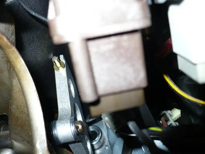

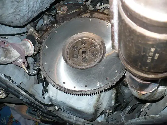

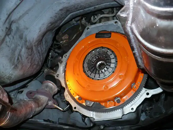

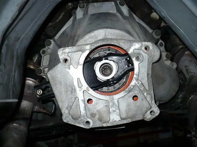

I got a little more done tonight. I also learned the the flywheel only goes on one way. Man is it agravating trying to put it on not knowing that 2 of the bolts are slightly further a part then the rest. The worst part was I got it on and then I realized I forgot the aluminum shield. Then back a part it came.
Center force clutch and shield installed
Bell housing back on. Clutch fork & cable hooked up
MM quadrant installed
Firewall adj installed

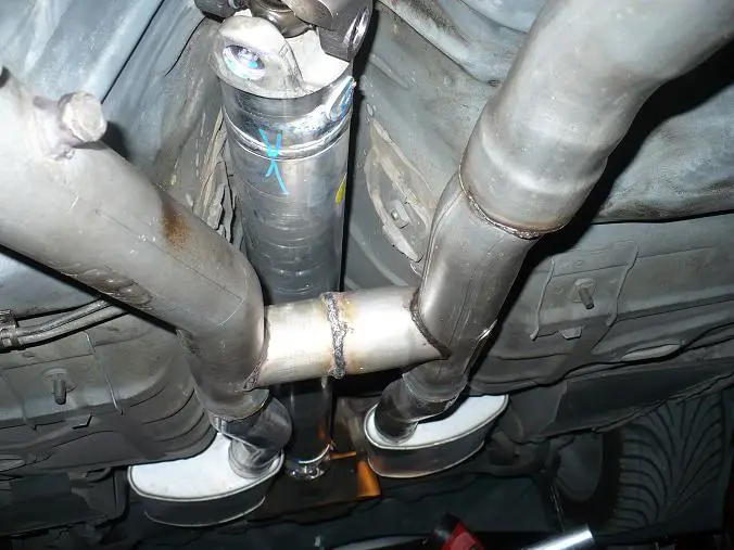

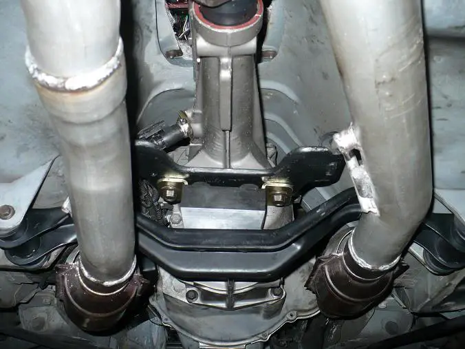

OK I got sick of waiting on my neighbor to help me out so I decided to try and tackle installing the trasnmission by myself. All in all it wasn't too bd. I put it on my floor jack and rolled it under the car. Once I jacked it up high enough it was a little struggle but it went in pretty easily. All of the major work is done for now. All I have to do is fill the trans, put on the shifter, put the interior back together and install the starter. Hopefully the starter will be here tomorrow. The clutch feel lighter then it did before. I can't wait to trast it out to see how much better 1st & 5th gear are with the different gearing. I will report back once I drive it.
Transmission installed
Ford Racing driveshaft installed

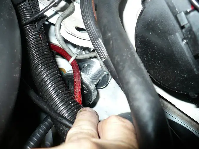

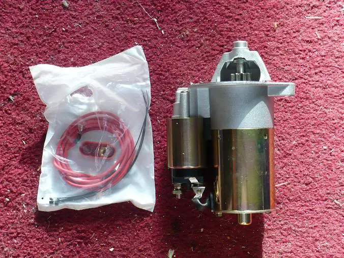

New mini starter arrived. I'm going into the garage to install it now. No cooments about how dirty the carpet it. It's in the garage in front of my work benches.

Well I got the interior back together and took it out for a test ride. Luckily nothing fell off. The new transmission it tight! Between the new transmission, transmission mount, clutch, quadrant and aluminum drive shaft it feels like a different car. There is zero vibration in the shifter. When I lay into it, it doen't jump like it used to. It's really smooth. I'm very happy.
This thread will probably lay low for a while as I collect the engine and suspension parts. That's unless I find some money somewhere. I've been know to do that on occassion.

I live in Florida. They are also in Florida. I had mine about 1 week after I ordered them.
That set up sounds cool. You will have to post pictures once you get them installed.
Also I forgot to mention the new starter sounds funny compared to the stock one. The permanent magnet starter just has a different sound then the stock wound one.
