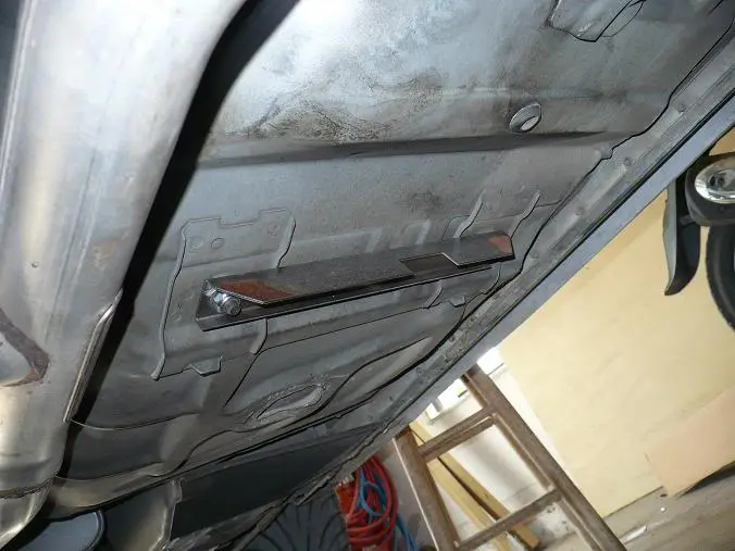

Here are the seat braces bolted up.

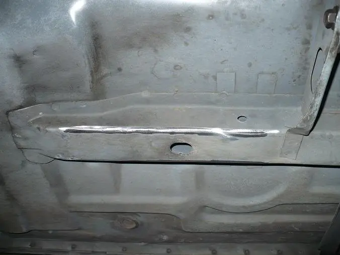

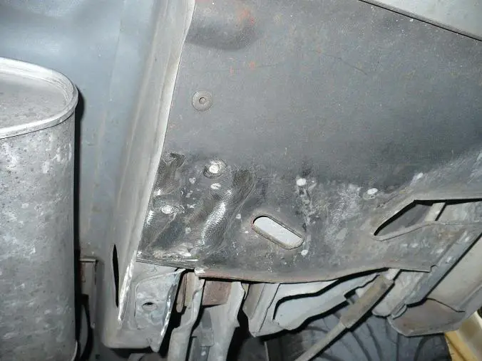

Here is the front frame rail grinded and ready for welding.

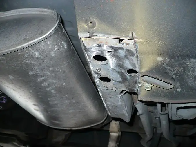

Here is the rear one prepped and ready. Since I have a convertible it has a factory reinforcement. Instead of removing them I just removed the 3 rivets that were in the way and ground the lip off so the subframe connectors would sit flush and could be welded up to them.
I would not weld the SFC to that plate. I would notch the plate so the SFC can be welded directly to the frame rail. Personally I removed the plate on my 87droptop
Ya know...I asked the question in the tech forum if I should remove them or not & no one answered. I removed one side and though to myself it would be stronger with them. The I called UPR. That's were I got the connectors from. They told me to leave them on. I like your idea better. Man and I just took a shower. I guess it's back outside to do more cutting. The worst part is putting the car on the stands. Thanks for the advice!!
Heres my thought process on it. The plate is only riveted. It will flex and move especially since you took the rivits out. If anything it will be weaker. So if you notch it you can weld directly to the frame and then have him weld the plates in as well.

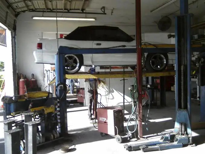

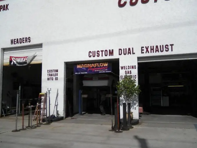

OK I had the subframe connectors welded in today. It was done at my buddies shop in Lkae Worth FL. Custom Exhaust. They do some of the best quality exhaust work anywhere. No dangling tailpipes here. If you go see Don or Doug, trll them Frank from Bennett Auto Supply sent you.
Man I forgot my camera so I had to use my phone. I'm surprised what good pictures it takes.
Custom Exhaust

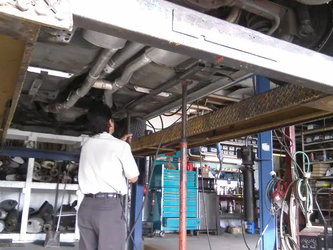

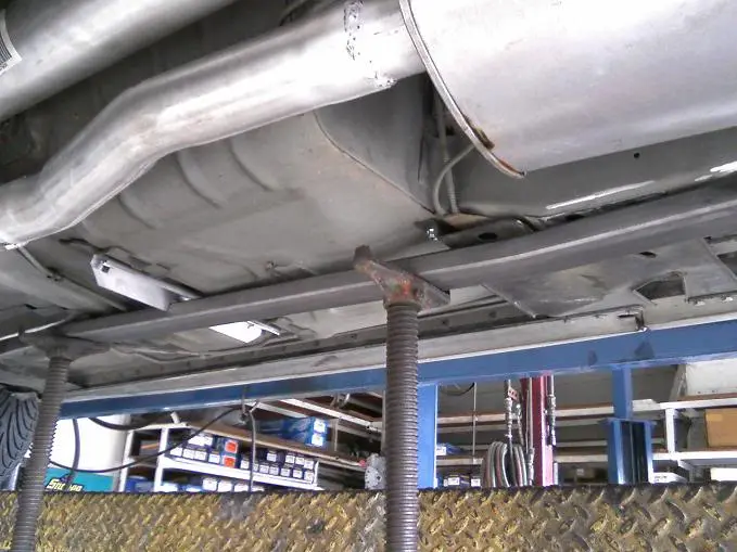

Here's the car on the rack.
Here's Julio lining things up.

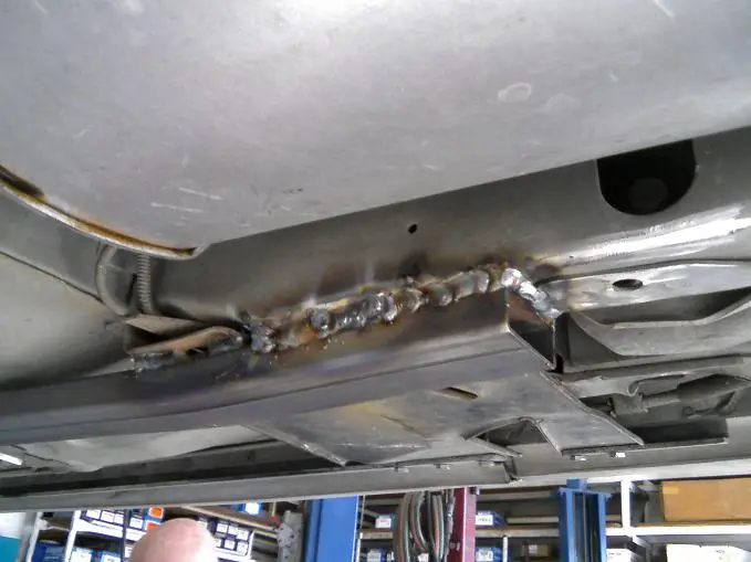

Him welding.
Some of the finished product.
