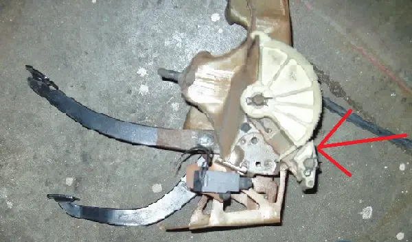

Underneath your dash, you [should] see a clutch quadrant that looks like this:
Click to make it bigger

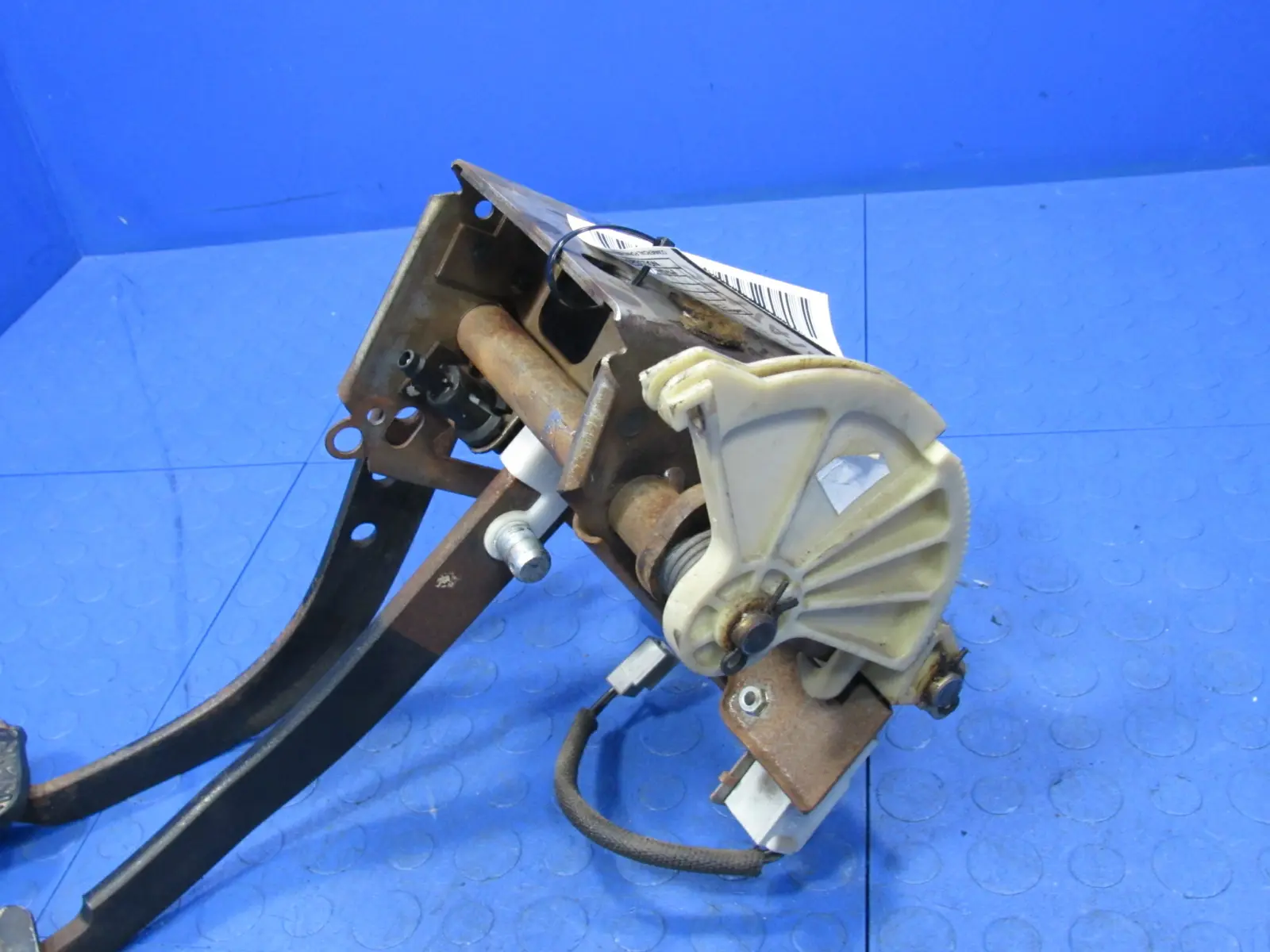

Here, you can see the teeth on it:
Inspect yours to ensure that all of the teeth are in good shape. You also want to inspect the Pawl:

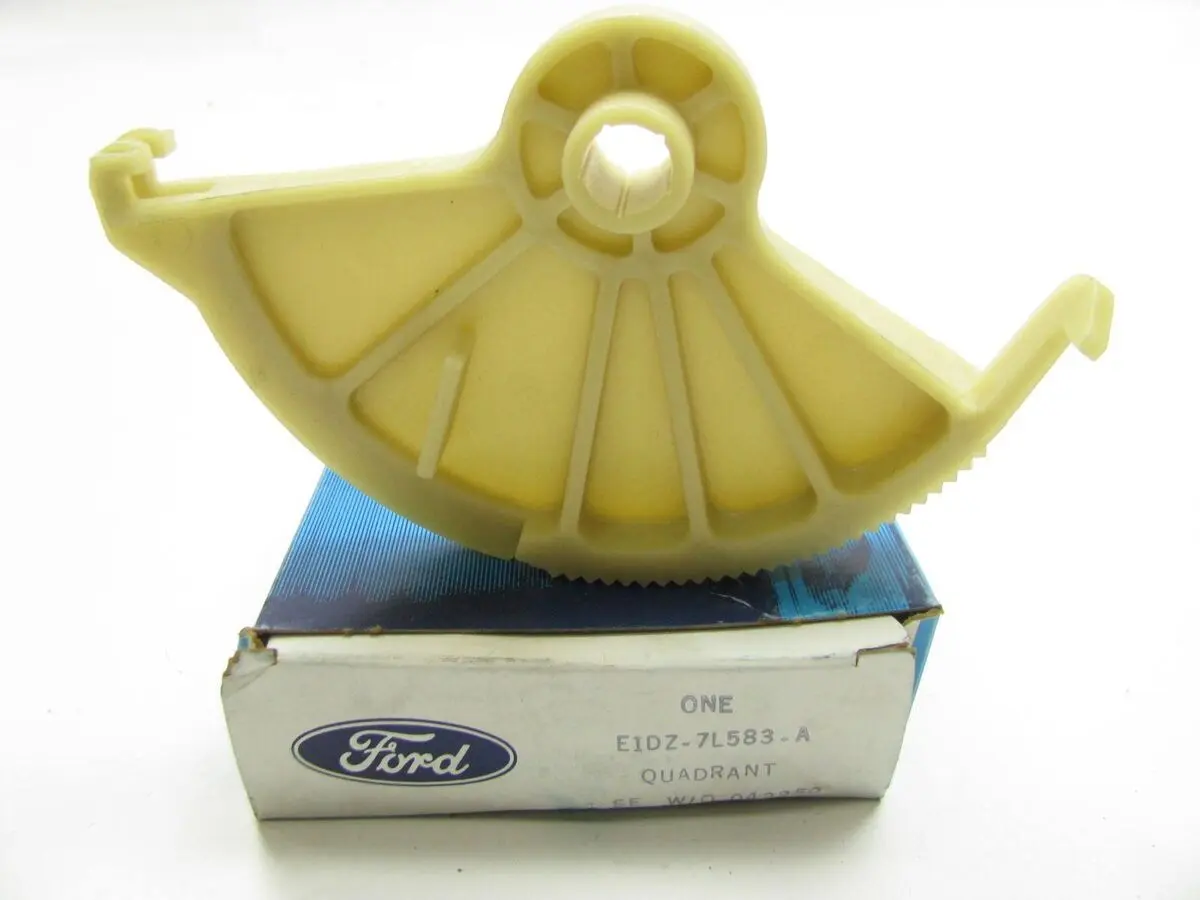

You can see it in this image that was taken by a potato:
You want to ensure that the teeth on the pawl are in good shape too, not broken.
