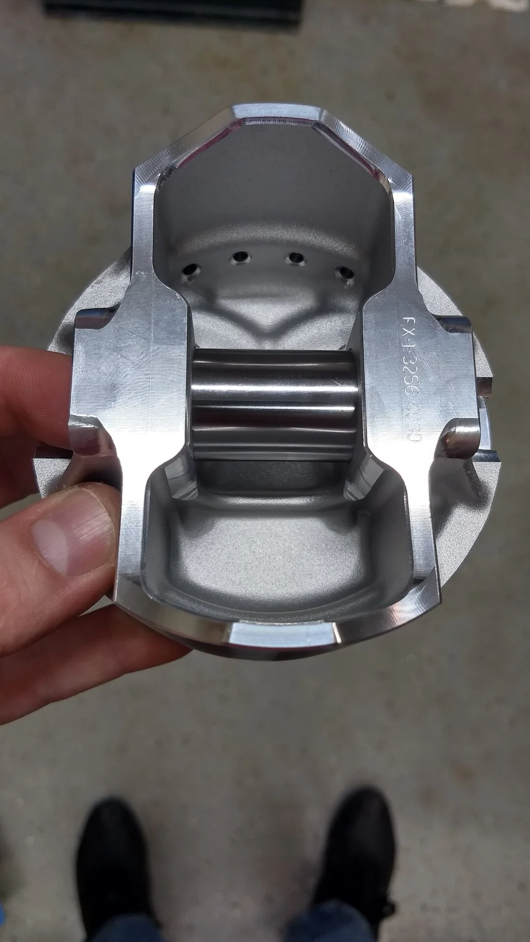

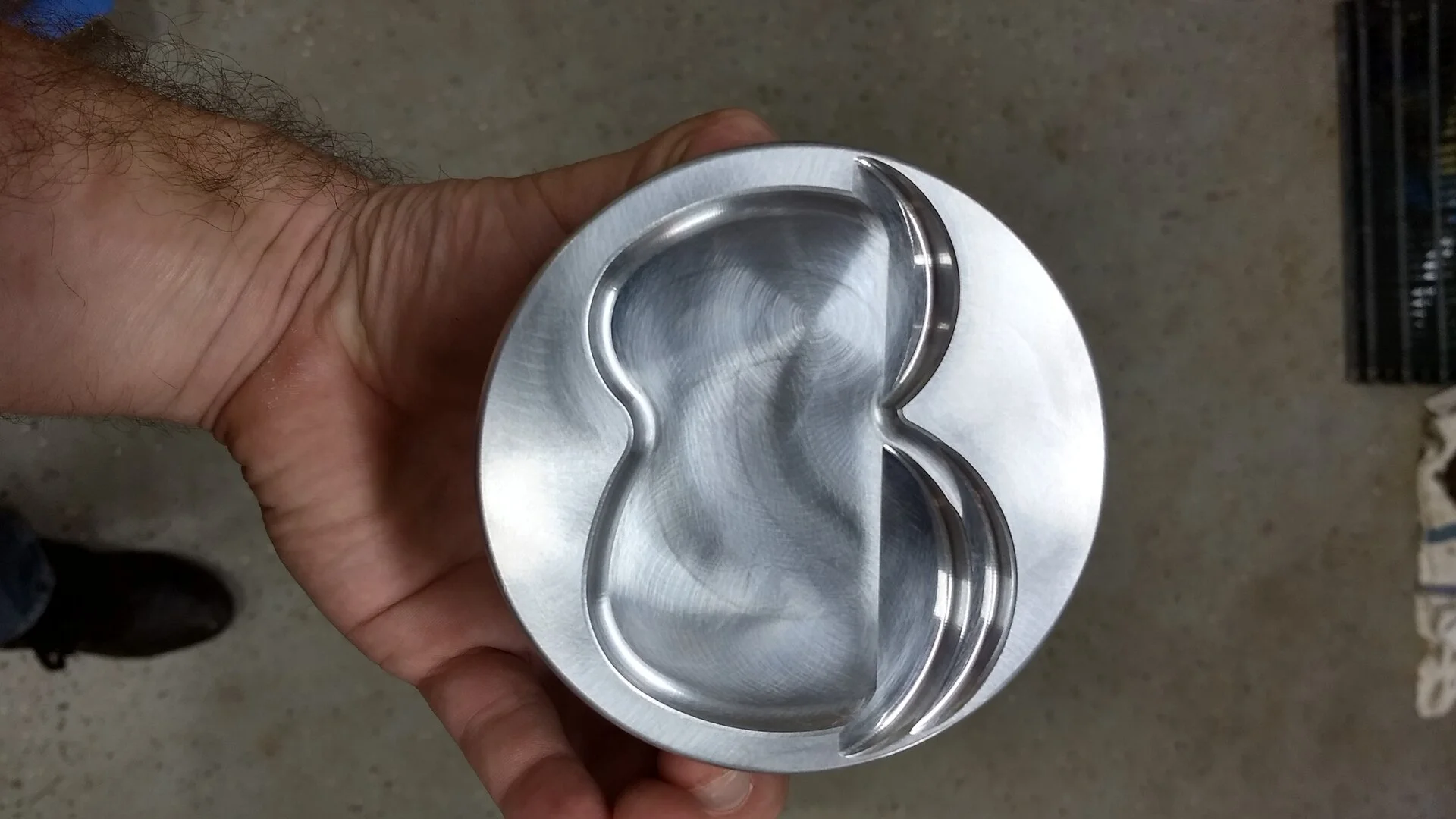

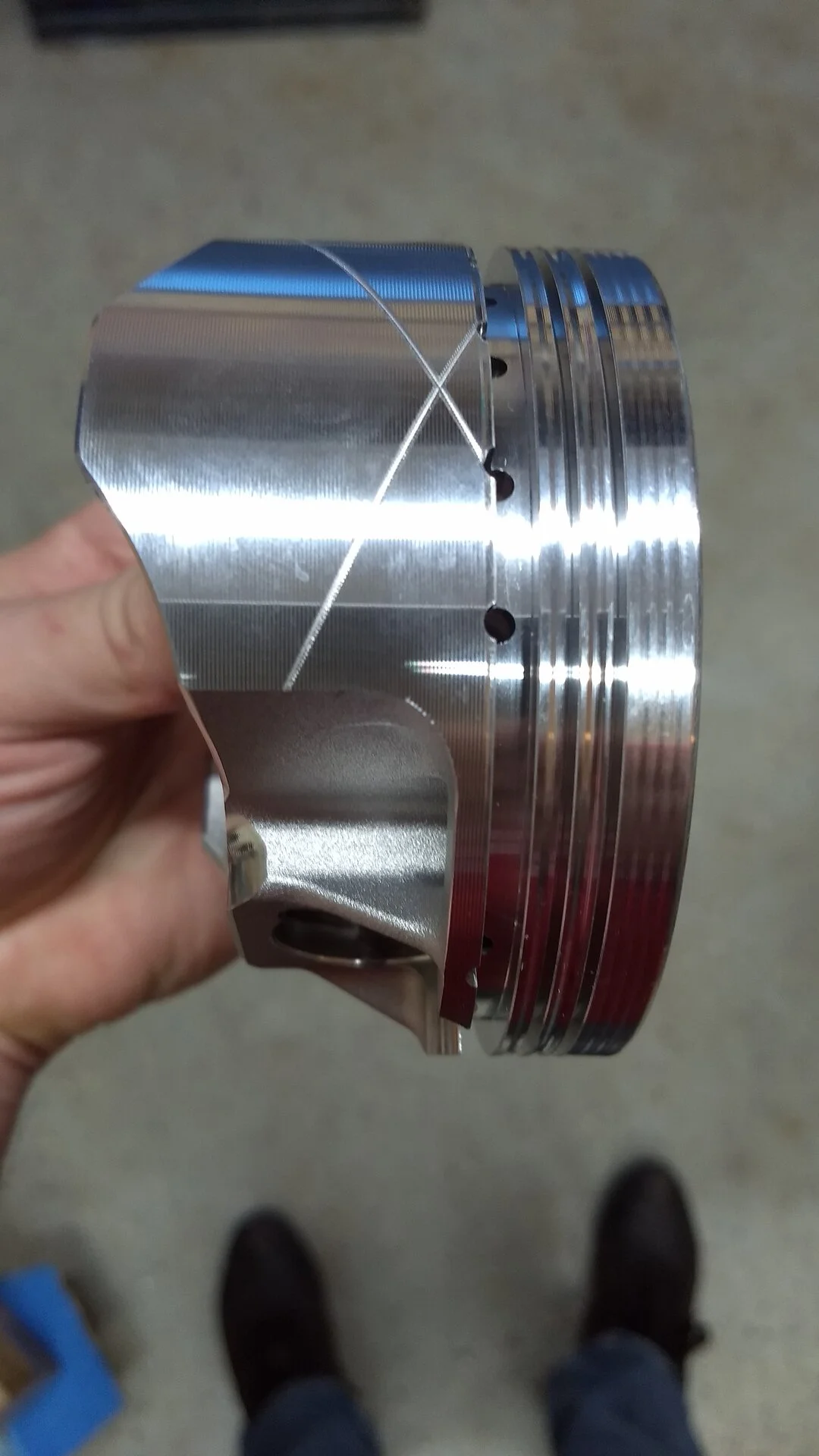

Got the last item in the mail... PISTONS!!!!
These things look sweet with the massive 13cc dish in them. The quality of the pistons are awesome.

Damn. Almost wish they sold those in a set of 9 just to put one on my desk at work.
I agree but... You can just buy one if you call them :rolleyes: . If you messed up one by dropping a valve or something similar you could just call and get a replacement.

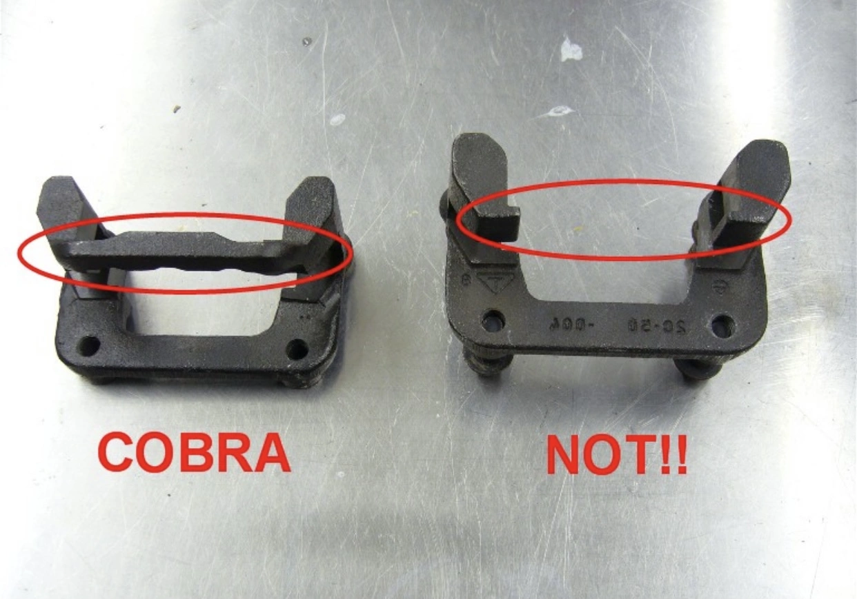

I know that I am getting ahead of myself, but were thinking of the brakes on the car. Mainly, because the new stuff that LMR has been putting out including the cobra anti-moan brackets. I am currently using 98 GT rear brackets with the 10.84" rotors, but thought the same calipers could be used on the larger cobra rotors?
@Mustang5L5
I really like my combo of the 14" GT500 fronts with the rear disc, but wish the rotors where larger for heat dissipation and appearance in the 18" wheels. Im going to be replacing all the rotors and pads on this build to something more aggressive anyways.

You can use the same calipers, but you need to either modify the GT pad bracket, or buy the cobra brackets. The slot that the rotor passes through is wider for the thicker rotor
you could also swap the 38mm SN95 calipers for the taurus 43mm calipers too...
Thank you!
I rather keep the 38mm piston sizing due to the F/R brake bias. I talked with Jack Hidley, and the math came out that I could keep the stock master cylinder and booster. I just need to adjust the brake booster pin as its always been to far out IMO.
@Mustang5L5 do you happen to know the stock part number of the cobra brackets?
