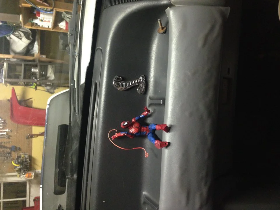

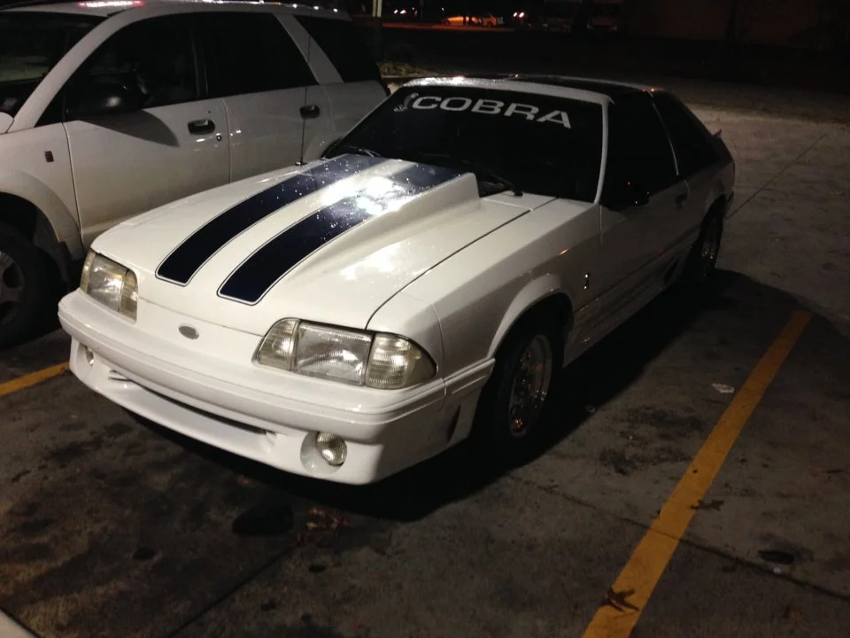

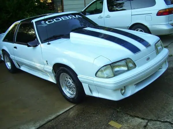

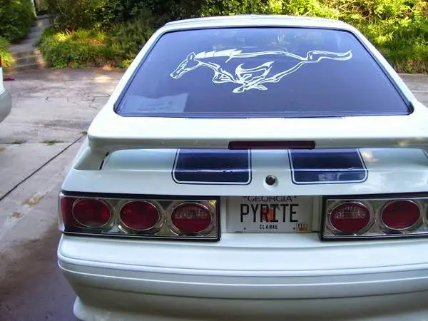

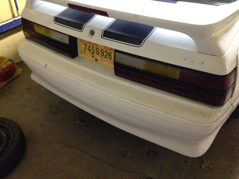

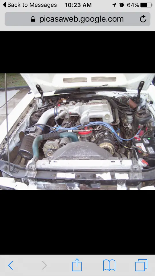

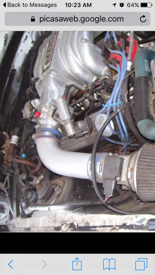

I picked the car up in early November 2015. The poor car had been through some owners with less than good taste. Here are some pics as I got it.
As you can see, Spider-Man was not amused with the cobra badges and homemade dash pad.

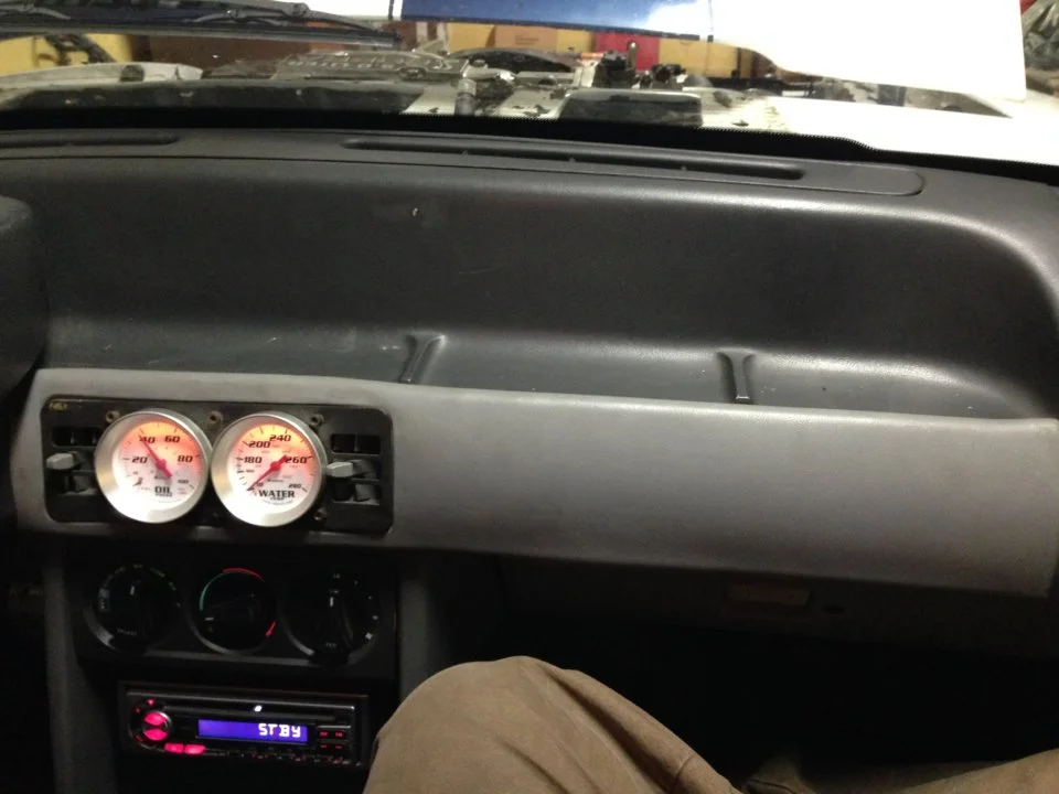

Next was dealing with the dash pad. Turns out they tried to reskin one from a different car but did a poor job. $6 from parts yard and I was good.

No pics for this one, but the next thing I found was none of the hatch lights worked. Turns out they were unhooked in the drivers side quarter. Simple fix once I found it.

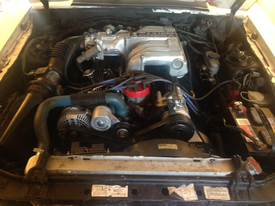

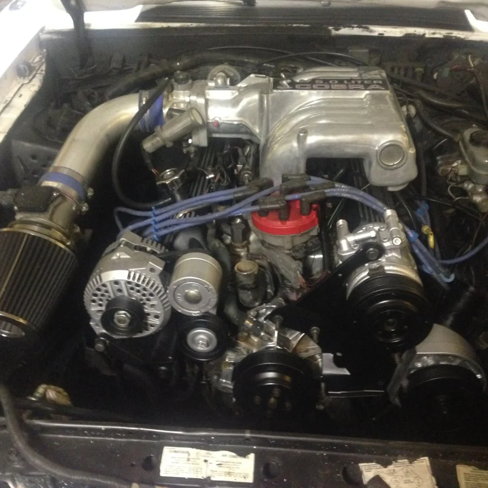

Next I started I wanted to 3G swap it and electric fan swap the car.
A trip to the yard found me a nice motor craft alt and all the wiring to do the swap including a factory power wire with inline fuse from a early Taurus 3.0.
I also took this time to pull all the accessories and brackets , wire wheel them, then paint them with engine paint.
I them added a sn95 fan with a Hayden controller coupled with a tyco 75 amp relay.
I'll likely trim down the fan for use in the factory shroud.

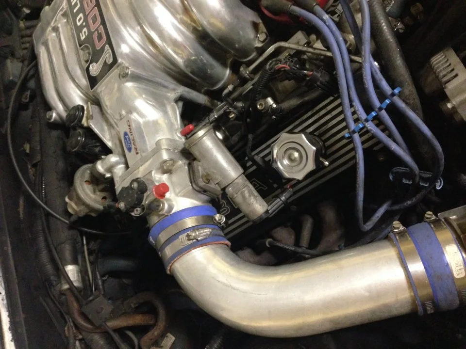

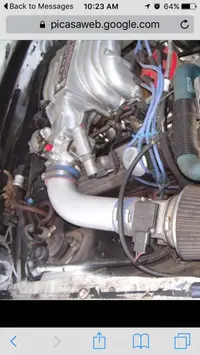

Also along the way traded the " cold " air intake for a stock style one. Much better in my opinion.

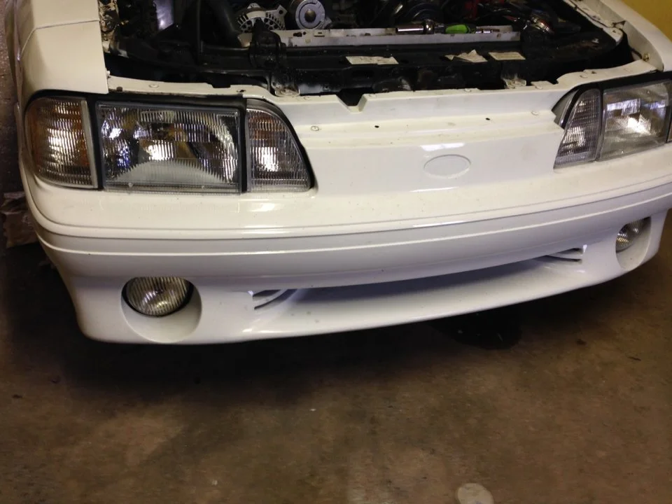

The cheep no name valve covers were leaking and not properly connected to the pcv system as well as my pcv screen was missing , found these covers locally pretty cheap.
Also changed the upper intake bolts, the 1" space that is probably pointless needs longer bolts that the previous owner was too lazy/ inept to change. 60 cents at lowes cured that.

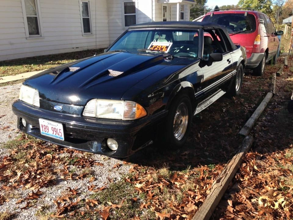

Wait, what happened to the vert? Didn't you just get a black one last fall or summer? Maybe I'm confusing you with somebody else.....anyways, sweet t-top!! If I ever find one again, but in good condition, I will buy it on the spot and add it to my fleet.

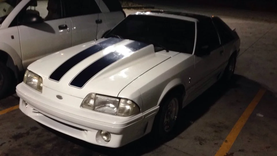

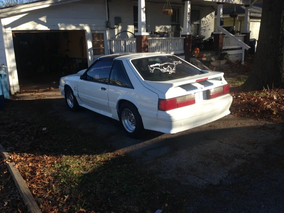

Yeah I had a very nice 89 gt drop top. Really liked it. But I always wanted a t-top and with fox prices in the raise I decided now was the time. So I sold the 89 to a young man fresh out of the army, then began my hunt for a t-top. I looked at about 20 or so. Most of them were either ran into the ground or priced way too high. Almost got a different one but the last video I got of it showed poorly dealt with rust with new paint on top. I finally settled on this one. It's a 88, 5.0 5 speed. I've not found rust anywhere yet but won't be surprised if I find a spot in the rear floorboards. The only issues with the car were poorly done mods and a cheap paint job. As you can see I've about fixed all the "mods" and I'll deal with the paint at some point. It's a factory black car they painted white, it will likely be back in black before its done.
I'll be getting the ac lines cleaned and installed soon, followed by getting the low coolant and low washer fluid sensors working. I also plan to put the electric fan into the stock shroud to give it a factory ish look. Inch by inch right.

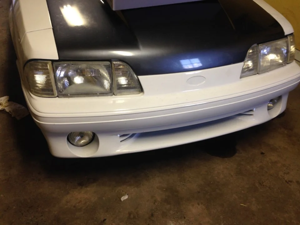

As seen in some of the pics above, I sold the hood that came with the car. It was a cirvinis knock off that needed a ton of blocking to be flat and I didn't care for the body lines it made. I found a same style and size true cirvinis for just a few bucks more. I just need to decide if I'm gonna toss some paint on it or wait till I do it all. We have a baby coming in October, so I might run out of time.
